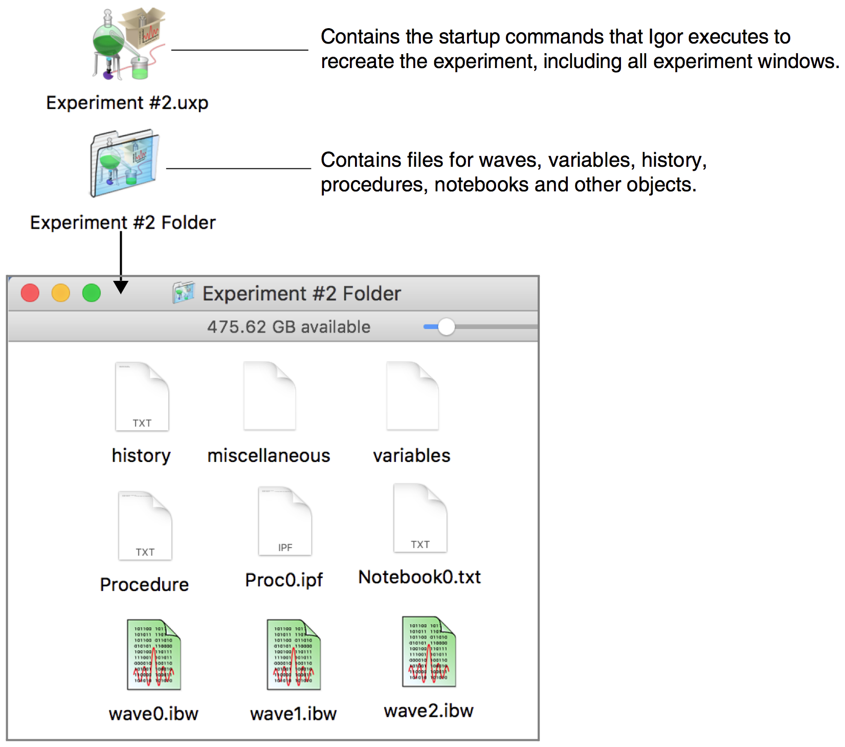

In the unpacked format, an experiment is saved as an experiment file and an experiment folder. The file contains instructions that Igor uses to recreate the experiment while the folder contains files from which Igor loads data. The experiment folder is also called the home folder.
The main utility of this format is that it is faster for experiments that contain very large numbers of waves (thousands or more). However the unpacked format is more fragile and thus is not recommended for routine use.
To save a new experiment in the unpacked format, choose Save Experiment As from the File menu. At the bottom of the resulting Save File dialog, choose Unpacked Experiment Files from the popup menu. When you click Save, Igor writes the unpacked experiment file which has a ".uxp" extension.
Igor then automatically generates the experiment folder name by appending " Folder" or the Japanese equivalent, to the experiment file name. It then creates the unpacked experiment folder without further interaction. For example, if you enter "Test.uxp" as the unpacked experiment file name, Igor automatically uses "Test Folder", or the Japanese equivalent, as the unpacked experiment folder name.
If a folder named "Test Folder" already exists then Igor displays an alert asking if you want to reuse the folder for the unpacked experiment.
If the automatic generation of the unpacked experiment folder name causes a problem for you then you can save an experiment with the names of your choice using the SaveExperiment /F operation.
This illustration shows the icons used with an unpacked experiment and explains where things are stored.
You normally have no need to deal with the files inside the experiment folder. Igor automatically writes them when you save an experiment and reads them when you open an experiment.
If the experiment includes data folders (see Data Folders) other than the root data folder, then Igor will create one subfolder in the experiment folder for each data folder in the experiment. The experiment shown in the illustration above contains no data folders other than root.
Note that there is one file for each wave. These are Igor Binary data files and store the wave data in a compact format. For the benefit of programmers, the Igor Binary Wave file format is documented in Igor Technical Note #003.
The "procedure" file holds the text in the experiment's built-in procedure window. In this example, the experiment has an additional procedure window called Proc0 and a notebook.
The "variables" file stores the experiment's numeric and string variables in a binary format.
The "miscellaneous" file stores pictures, page setup records, XOP settings, and other data.

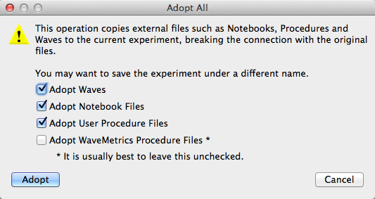

Adopt All​
You can adopt all referenced notebooks, procedure files and waves by pressing the Shift key and choosing File→Adopt All. This is useful when you want to create a self-contained packed experiment to send to someone else.
After clicking Adopt, choose File→Save Experiment As to save the packed experiment.

When you save an experiment, Igor creates procedures and commands, called "experiment recreation procedures" that Igor will execute the next time you open the experiment. These procedures are normally not visible to you. They are stored in the experiment file.
The experiment file of an unpacked experiment contains plain text, but its extension is not ".txt", so you can't open it with most word processors or editors.
As an example, let's look at the experiment recreation procedures for a very simple unpacked experiment:

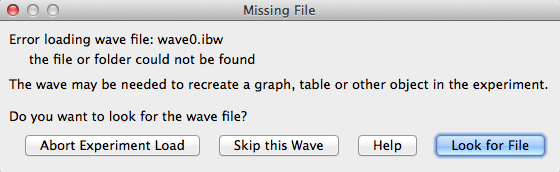

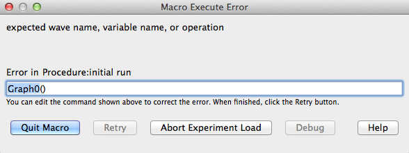

It is possible for the experiment loading process to fail to run to a normal completion. This occurs most often when you move or rename a file or folder. It also happens if you move an experiment to a different computer and forget to also move referenced files or folders. See References to Files and Folders for details.
When a file is missing, Igor presents a dialog giving you several options:
If you elect to abort the experiment load, Igor will alert you that the experiment is in an inconsistent state. It displays some diagnostic information that might help you understand the problem and changes the experiment to Untitled. You should choose New Experiment or Open Experiment from the File menu to clear out the partially loaded experiment.
If you elect to skip loading a wave file, you may get another error later, when Igor tries to display the wave in a graph or table. In that case, you will see a dialog like this:
In this example, Igor is executing the Graph0 macro from the experiment recreation procedures in an attempt to recreate a graph. Since you elected to skip loading wave0, Igor can't display it.
You have three options at this point, as explained in the following table.
OptionEffect
Quit MacroStops executing the current macro but continues the experiment load. In this example, Graph0 would not be recreated. After the experiment load Igor displays diagnostic information.
Abort Experiment LoadAborts the experiment load immediately and displays some diagnostic information.
RetryIn this example, you could fix the macro by deleting "wave0,". You would then click the Retry button. Igor would create Graph0 without wave0 and would continue the experiment load.
With the first two options, Igor leaves the experiment untitled so that you don't inadvertently wipe out the original experiment file by doing a save.

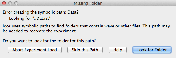

When you reopen the experiment, Igor executes these NewPath commands. If you have moved or renamed folders, or if you have moved the experiment file, the NewPath operation will be unable to find the folder.
If the folder associated with the symbolic path is not needed to recreate the experiment, the NewPath command includes the /Z flag. In this case, Igor skips the creation of the symbolic path, generates no error, and just continues the load. The experiment will wind up without the missing symbolic path.

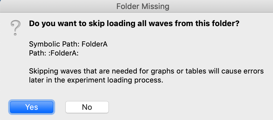

If the missing folder is needed to load waves, notebooks or procedure files then Igor asks if you want to look for the folder by displaying the Missing Folder dialog.
If you click Look for Folder, Igor presents a Choose Folder dialog in which you can locate the missing folder.
If you click Skip This Path, Igor does not create the symbolic path. Igor then asks if you want to skip waves loaded using the symbolic path that is being skipped:
If you click Yes, Igor skips all LoadWave commands using the symbolic path associated with the missing folder. This will cause errors later in the experiment loading process if the waves are needed for graphs, tables or other windows.
If you click No and the folder contains wave files referenced by the experiment, you will get Missing File dialogs later in the process giving you a chance to locate the wave files.
For example, if the experiment loads two waves using the Data2 path then the experiment's recreation commands would contain two lines like this:
LoadWave/C/P=Data2 "wave0.ibw"
LoadWave/C/P=Data2 "wave1.ibw"
If you elected to skip creating the Data2 path and clicked Yes when asked if you want to skip waves from that path, then Igor skips these LoadWave commands altogether.
If you elected to skip creating the Data2 path and clicked No when asked if you want to skip waves from that path, then each of these LoadWave commands presents the Missing File dialog.
If you are unable to find the wave file and if the wave is used in a graph or table, you will get more errors later in the experiment recreation process, when Igor tries to use the missing wave to recreate the graph or table.

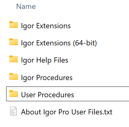

The Igor Pro User Files folder looks like this:
You can activate additional help files, extensions, and procedure files that are part of the Igor Pro installation, that you create, or that you receive from third parties. To do this, add files, or shortcuts pointing to files, to the special subfolders within the Igor Pro User Files folder. See Activating WaveMetrics Procedure Files and Activating WaveMetrics XOPs for details on activating additional WaveMetrics files.
You can display the Igor Pro User Files folder on the desktop by choosing Help→Show Igor Pro User Files. To display both the Igor Pro Folder and the Igor Pro User Files folder, which you typically want to do to activate a WaveMetrics XOP or procedure file, press the shift key and choose Help→Show Igor Pro Folder and User Files.

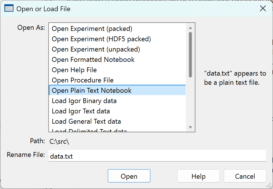

The Open or Load File Dialog​
When you open a file using a menu item, such as File→Open File→Notebook, there is no question of how Igor should treat the file. This is not always the case when you drop a file onto the Igor icon or double-click a file on the desktop.
Often, Igor can determine how to open or load a file, and it will simply do that without asking you about it. Sometimes Igor recognizes that a file (such as a plain text file or a formatted Igor notebook) can be appropriately opened several ways, and will ask you what to do by displaying the Open or Load File Dialog. The dialog presents a list of ways to open the file (usually into a window) or to load it as data.

You can force this dialog to appear by pressing Shift while opening a file through the Recent Files or Recent Experiments menus, or when dropping a file onto the Igor icon.
This is especially useful for opening Igor help files as a notebook file for editing, or to open a notebook as a help file, causing Igor to compile it.
The list presents three kinds of methods for handling the file:
  1. Open the file as a document window or an experiment.
  2. Load the file as data without opening another dialog.
  3. Load the file as data using another dialog.
If you choose one of the list items marked with an asterisk, Igor displays the selected dialog as if you had chosen the corresponding item from the Load Waves submenu of the Data menu.
Information about the file, or about how it was most recently opened, is displayed to the right of the list. The complete path to the file is shown below the list.
If you change the text in the Rename File edit box, Igor changes the file name before opening or loading the file.

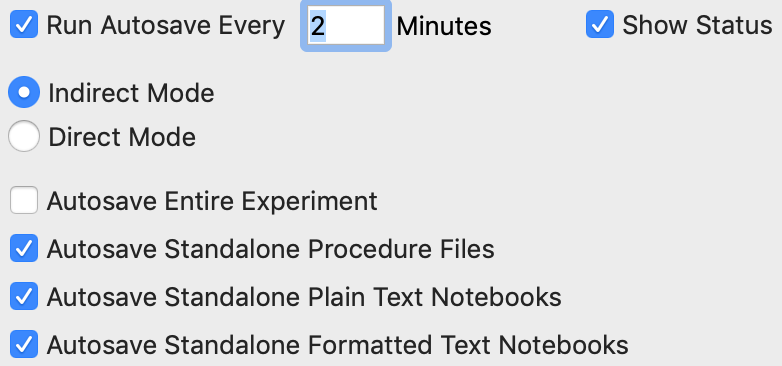

Autosave​
Igor can autosave files while you work. This is of use in the event that Igor crashes or some other catastrophe occurs before you save.
If your habit is to save anytime you have made non-trivial changes that you want to keep then you don't need autosave. If your habit is to do a significant amount of work without saving, which is inherently risky, then autosave may prevent loss of work in the event of a crash.
Autosave is not foolproof and can cause confusing and unpredictable behavior if multiple users modify the same file or if you modify a file in multiple instance of Igor. For these and other reasons, you should consider autosave a last resort and always save when you have made progress and back up any work that would be painful to lose.
Autosave is turned off by default. You can turn it on and fine-tune how it works by choosing Misc→Miscellaneous Settings and clicking the Autosave icon in the lefthand list to display the Autosave pane of the Miscellaneous Settings dialog. The heart of it looks like this:
You turn autosave on by checking the Run Autosave checkbox. If turned on, autosave runs at the interval in minutes that you specify. Autosave runs when Igor is idling and not while procedures are running or if a modal dialog is displayed.
Alternatives to automatically autosaving include:
  • Manually saving by choosing File→Save Experiment when you know the experiment is in good shape
  • Running autosave manually when you know the experiment is in good shape by choosing File→Run Autosave Now
  • Manually saving modified procedure files only using File→Save All Standalone Procedure Files
Igor can display information in its status bar showing the status of autosave. You can turn the autosave information on or off using the Show Status checkbox in the autosave pane of the Miscellaneous Settings dialog or by right-clicking the status bar. If autosave is enabled, the status bar information shows the time of the next autosave run. "Run" means "check if there are any files to be autosaved and autosave them if so".
Modifying the same file in different instances of Igor while autosave is on will cause confusing and unpredictable behavior.
Igor programmers can query autosave settings using IgorInfo(13).

Autosave Modes​
You control the mode of operation of autosave using the Autosave pane of the Miscellaneous Settings dialog.
Autosave supports three modes. Each has its strengths and weaknesses.
  • Off
    Autosave is off when the Run Autosave checkbox is unchecked.
    In this mode, Igor's autosave routine does not automatically run.
    Strengths
    Easy to understand.
    Takes no time.
    You are in complete control of when files are saved.
    Weaknesses
    You are responsible for saving when you have made important changes.
  • Indirect Mode
    Saves the current experiment (if it is packed, not if it is unpacked) and/or standalone procedure and standalone notebook files to .autosave files alongside the original files. For example, "Experiment.pxp" is autosaved to "Experiment.pxp.autosave" and "Proc0.ipf" is autosaved to "Proc0.ipf.autosave".
    Saving the current experiment is the same as choosing File→Save Experiment Copy.
    Saving a standalone procedure file is the same as choosing File→Save Procedure Copy.
    Saving a standalone notebook is the same as choosing File→Save Notebook Copy.
    You can choose whether to autosave the current experiment, standalone procedure files, and standalone notebooks.
    Indirect autosave of unpacked experiments is not supported.
    Strengths
    Does not risk overwriting your original files at the wrong time, for example just after you made a mistake.
    Weaknesses
    Saving the entire experiment can take a while for very large experiments.
    If you do not elect to save the entire experiment, many things are not autosaved, including the built-in procedure window, packed procedure files and notebooks, graphs, layouts and other windows, data folders and waves - see What Autosave Saves for details.
    Can interfere with sharing of files by multiple users or by multiple instances of Igor launched by a single user.
    Does not work with unpacked experiments.
    The .autosave files represent more clutter relative to direct mode.
    Recovering after a crash is more complicated compared to direct mode. Igor will ask if you want to use the .autosave file or the original file.

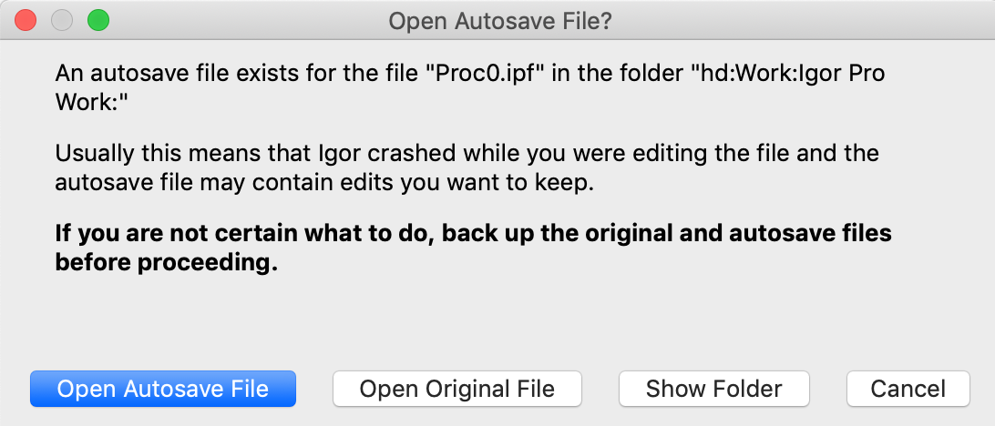

Recovering a File from a .autosave File​
If Igor crashes or some other catastrophe occurs and Igor's indirect autosave routine executed before Igor was terminated, you will be left with the original file, "Proc0.ipf", and the .autosave file, "Proc0.ipf.autosave". If you attempt to open the original file, either manually or programmatically, Igor displays a dialog that looks like this:
warning
We recommend that you back up the original and autosave files before proceeding.
If you click Cancel
The open operation is canceled and the original and autosave files are left unchanged.
If you click Open Original File
Igor opens the original file (e.g., "Proc0.ipf").
Igor then moves the autosave file (e.g., "Proc0.ipf.autosave") to the recycle bin. However, if the autosave file is open in Igor, it is not moved to the trash but may be overwritten by a subsequent autosave.
If you click Open AutoSave File
Igor renames the original file by appending a ".original" extension (e.g., "Proc0.ipf" is renamed as "Proc0.ipf.original").
Igor then renames the autosave file using the original file name (e.g., "Proc0.ipf.autosave" is renamed as "Proc0.ipf").
Igor then opens the autosave file which now has the original file name (e.g., "Proc0.ipf").
Igor then moves the original file, which now has the ".original" extension (e.g., "Proc0.ipf.original") to the recycle bin.
