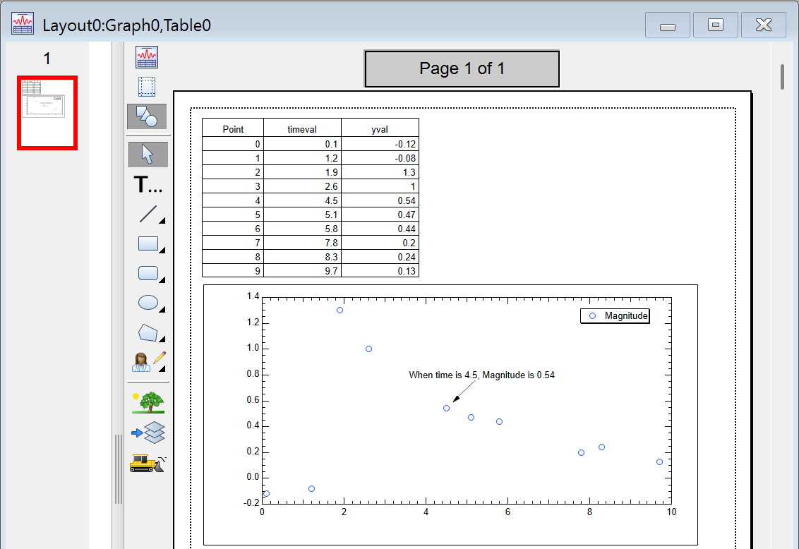

  • Page layouts
A collection of objects is called an "experiment" and is stored in an experiment file. When you open an experiment, Igor recreates the objects that comprise it.

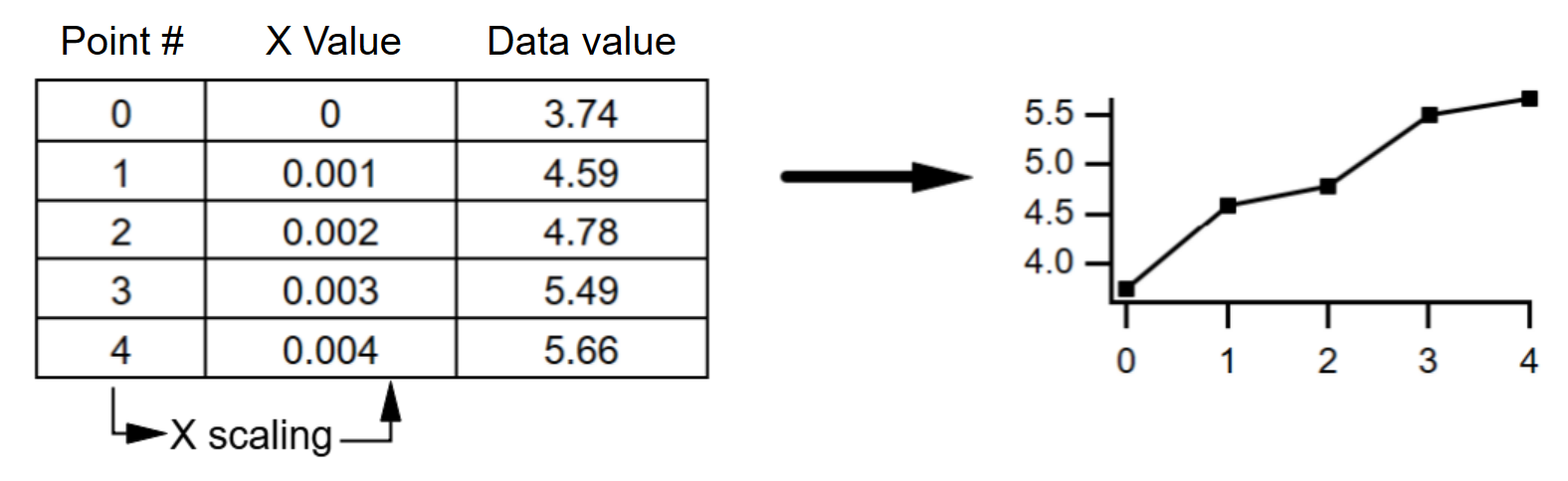

We use the term "wave" to describe the Igor object that contains an array of numbers. Wave is short for "waveform". The wave is the most important Igor concept.
Igor was originally designed to deal with waveform data. A waveform typically consists of hundreds to thousands of values measured at evenly-spaced intervals of time. Such data is usually acquired from a digital oscilloscope, scientific instrument or analog-to-digital converter card.
The distinguishing trait of a waveform is the uniform spacing of its values along an axis of time or other quantity. An Igor wave has an important property called "X scaling" that you set to specify the spacing of your data. Igor stores the Y component for each point of a wave in memory but it computes the X component based on the wave's X scaling.
In the following illustration, the wave consists of five data points numbered 0 through 4. The user has set the wave's X scaling such that its X values start at 0 and increment by 0.001 seconds per point. The graph displays the wave's stored data values versus its computed X values.
In a graph of waveform data, Igor plots a
Point # X value Data value wave's data values versus its X values.
Igor computes a wave’s X values; X scaling is a property of a wave that specifies how Igor will compute the X value for a given point number.

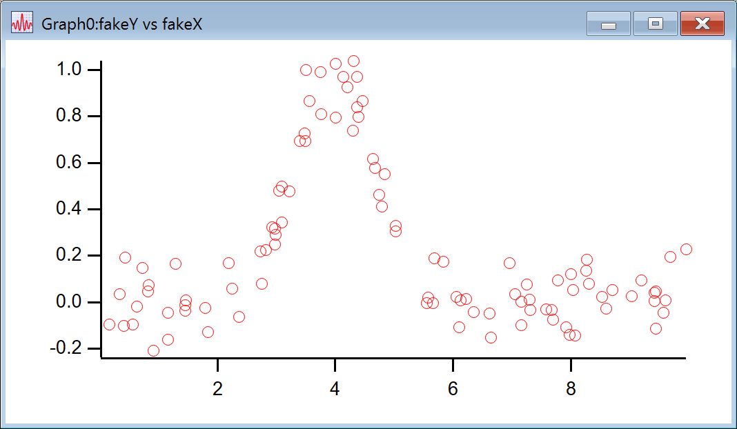

Igor is also capable of dealing with data that does not fit the waveform metaphor. We call this XY data. Igor can treat two waves as an XY pair. In an XY pair, one wave supplies an X component and another wave supplies a Y component for each point in the pair.
A few analysis operations, such as Fourier transforms, inherently work only on waveform data. They take a wave's X scaling into account.
Other operations work equally well on waveform or XY data. Igor can graph either type of data and its powerful curve fitting works on either type.

Page layouts display multiple graphs and tables as well as pictures and annotations for presentation.
Each object has a name so that it can be referenced in an Igor command. You can explicitly set an object's name or accept a default name created by Igor.

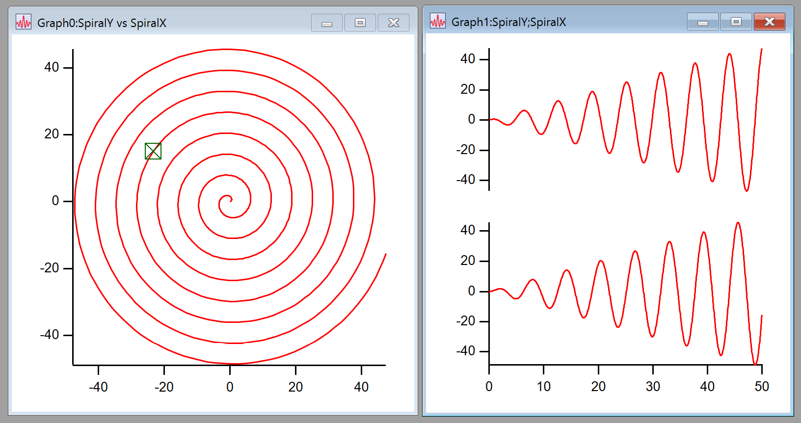

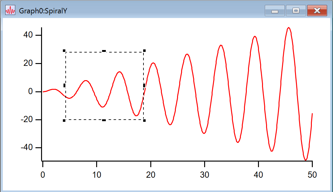

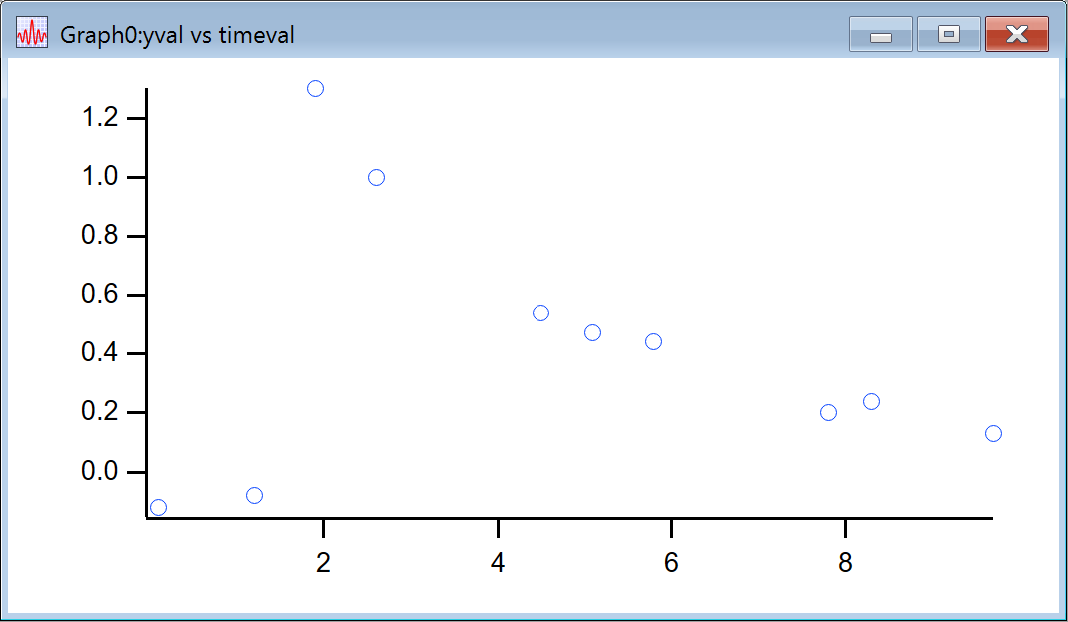

Graphs are used to visualize waves and to generate high-quality printouts for presentation. The traces in a graph are representations of waves. If you modify a wave, Igor automatically updates graphs. Igor labels the axes of a graph intelligently. Tick marks never run into one another and are always "nice" values no matter how you zoom in or pan around.
In addition to traces representing waveform or XY data, a graph can display an image or a contour plot generated from 2D data.
Tables are used to enter, inspect or modify wave data. A table in Igor is not the same as a spreadsheet in other graphing programs. A column in a table is a representation of the contents of a wave. The wave continues to exist even if you remove it from the table or close the table entirely.
Page layouts permit you to arrange multiple graphs and tables as well as pictures and annotations for presentation. If you modify a graph or table, either directly or indirectly by changing the contents of a wave, Igor automatically updates its representation in a layout.

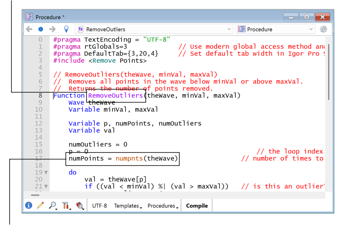

User-Defined Procedures​
A user-defined procedure is a routine written in Igor's built-in programming language by entering text in a procedure window. It can call upon built-in or external operations and functions as well as other user-defined procedures to manipulate Igor objects. Sets of procedures are stored in procedure files.
You can create Igor procedures by entering text in a procedure window:
Each procedure has a name which you use to invoke it.
Procedures can call operations, functions or other procedures.
They can also perform waveform arithmetic.

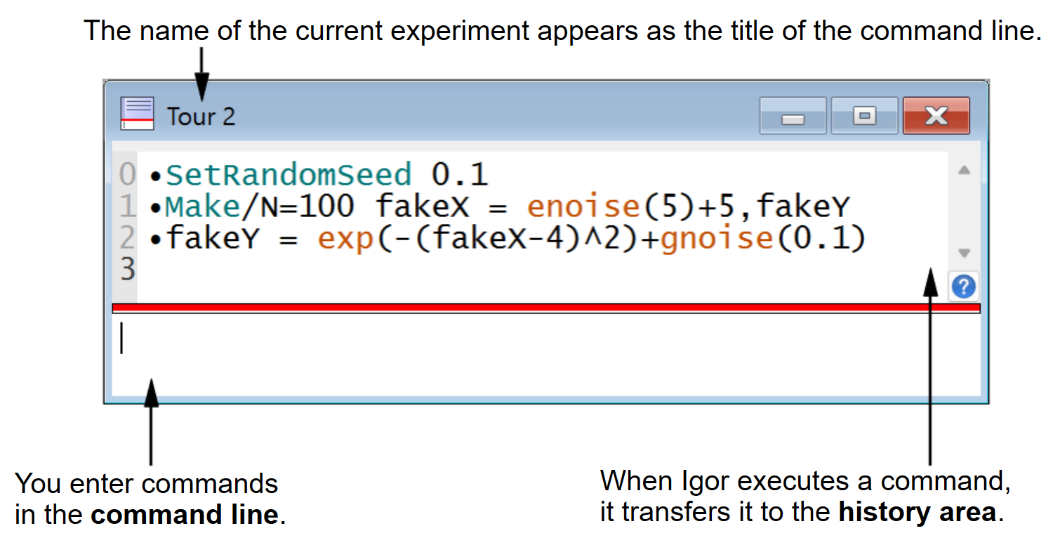

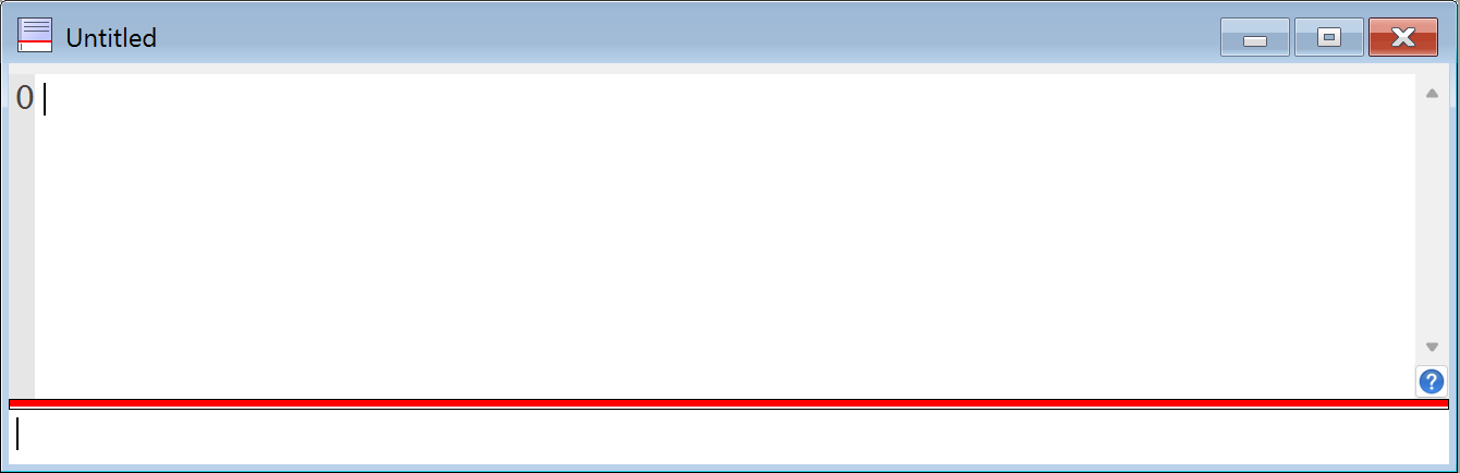

The Command Window​
The command window is Igor's control center. It appears at the bottom of the screen.
At the bottom of the command window is the command line. Above the red divider is the history area where executed commands are stored for review. Igor also uses the history area to report results of analyses like curve-fitting or waveform statistics.
The icon with the question mark displays the Help Browser.

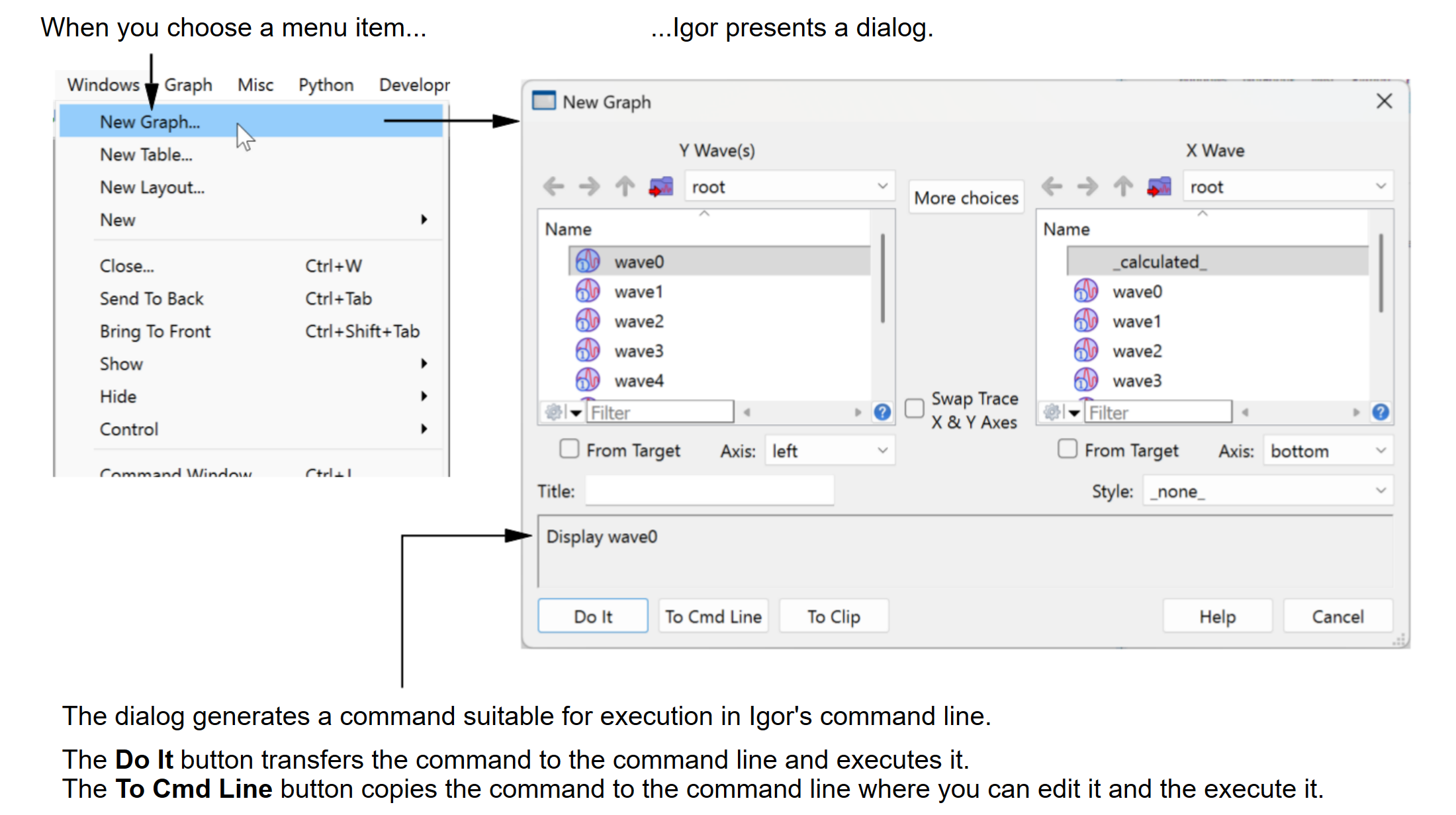

Menus and dialogs provide easy access to the most commonly-used Igor operations.
When you choose a menu item associated with an Igor operation, Igor presents a dialog. As you use the dialog, Igor generates a command and displays it in the command box near the bottom of the dialog. When you click the Do It button, Igor transfers the command to the command line where it is executed.
As you get to know Igor, you will find that some commands are easier to invoke from a dialog and others are easier to enter directly in the command line.
There are some menus and dialogs that bypass the command line. Examples are the Save Experiment and Open Experiment items in the File menu.

Entering Data​
  1. If a table window is showing, click it to bring it to the front.
    When Igor starts up, it creates a new blank table unless this feature is turned off in the Miscellaneous Settings dialog. If the table is not showing, perform the following two steps:
    • Choose the Windows→New Table menu item.
      The New Table dialog appears.
    • Click the Do It button.
      A new blank table is created.

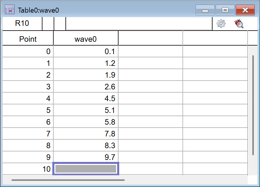

  2. Type "0.1" (without the quotes) and then press Return or Enter on your keyboard.
    This creates a wave named “wave0” with 0.1 for the first point. Entering a value in the first row (point 0) of the first blank column automatically creates a new wave.
  3. Type the following numbers, pressing Return or Enter after each one:
    1.2
    1.9
    2.6
    4.5
    5.1
    5.8
    7.8
    8.3
    9.7
    The table should look like this:

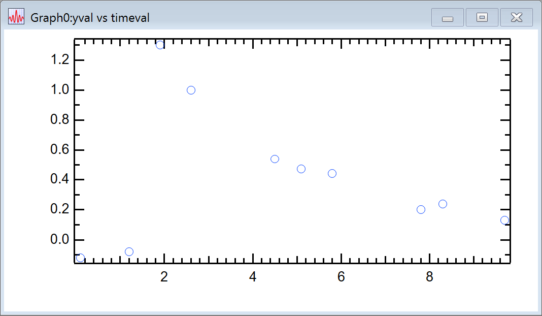

Making a Graph​
  1. Choose the Windows→New Graph menu item.
    The New Graph dialog appears. This dialog comes in a simple form that most people will use and a more complex form that allows you to create complex multi-axis graphs in one step.
  2. If you see a button labeled Fewer Choices, click it.
  3. In the Y Waves list, click "yval".
  4. In the X Wave list, click "timeval".
  5. Click Do It.
    A simple graph is created.
Touching up a Graph​
  1. Position the cursor directly over the trace in the graph and double-click.
    The Modify Trace Appearance dialog appears. You could also have selected the corresponding menu item from the Graph menu.
note
The Graph menu appears only when a graph is the target window. The target window is the window that menus and dialogs act on by default.
  1. Choose Markers from the Mode pop-up menu.
  2. Select the open circle from the Marker pop-up menu.
  3. Set the marker color to blue.
  4. Click Do It.
    The graph should now look like this:
  5. Position the cursor over the bottom axis line.
    The cursor changes to this shape: . This indicates the cursor is over the axis and also that you can offset the axis, and the corresponding plot area edge, to a new position.
  6. Double click directly on the axis.
    The Modify Axis dialog appears. If another dialog appears, click Cancel and try again, making sure the cursor is showing when you double-click.
    Note the Live Update checkbox in the top/right corner of the Modify Axis dialog. When it is checked, changes that you make in the dialog are immediately reflected in the graph. When it is unchecked, the changes appear only when you click Do It.
  7. If it is not already showing, click the Axis tab.
  8. Choose On from the Mirror Axis pop-up.
  9. Click the Auto/Man Ticks tab.
  10. Click the Minor Ticks checkbox so it is checked.
  11. Click the Ticks and Grids tab.
  12. Choose Inside from the Location pop-up.
  13. Choose the left axis from the Axis pop-up menu in the top-left corner of the dialog and then repeat steps 8 through 13.
  14. Click Do It.
  15. Again double click the bottom axis.
    The Modify Axis dialog appears again.
  16. Click the Axis tab.
  17. Uncheck the Standoff box.
  18. Choose the left axis from the Axis pop-up menu and repeat step 18.
  19. Click Do It.
    Notice that some of the markers now overlap the axes. The axis standoff setting offsets the axis so that markers and traces do not overlap it. You can use Igor's preferences to ensure that this and other settings default to your liking, as explained below.
  20. Double-click one of the tick mark labels (e.g., "6") on the bottom axis.
    The Modify Axis dialog reappears, this time with the Axis Range tab showing. If another dialog or tab appears, cancel and try again, making sure to double click one of the tick mark labels on the bottom axis.
  21. Choose "Round to nice values" from the pop-up menu that initially reads "Use data limits".
  22. Choose the left axis from the Axis pop-up menu and repeat step 22.
  23. Click Do It.
    Notice that the limits of the axes now fall on "nice" values.

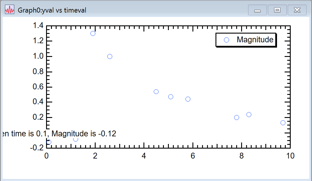

Adding A Legend​
  1. Choose the Graph→Add Annotation menu item.
    The Add Annotation dialog appears.
  2. Click the Text tab if it is not already selected.
  3. Choose Legend from the Annotation pop-up menu in the top-left corner of the dialog.
    Igor inserts text to create a legend in the Annotation text entry area. The Preview area shows what the annotation will look like. The text "\s(yval)" generates the symbol for the yval wave. This is an "escape sequence" which creates special effects such as this.
  4. Change the second instance of "yval" to "Magnitude".
    The annotation text should now be "\s(yval) Magnitude".
  5. Click the Frame tab and choose Box from the Annotation Frame pop-up menu.
  6. Choose Shadow from the Border pop-up menu.
  7. Click the Position tab and click the top right box in the Anchor control.
    Specifying an Anchor point helps Igor keep the annotation in the best location as you make the graph window bigger or smaller.
  8. Click Do It.

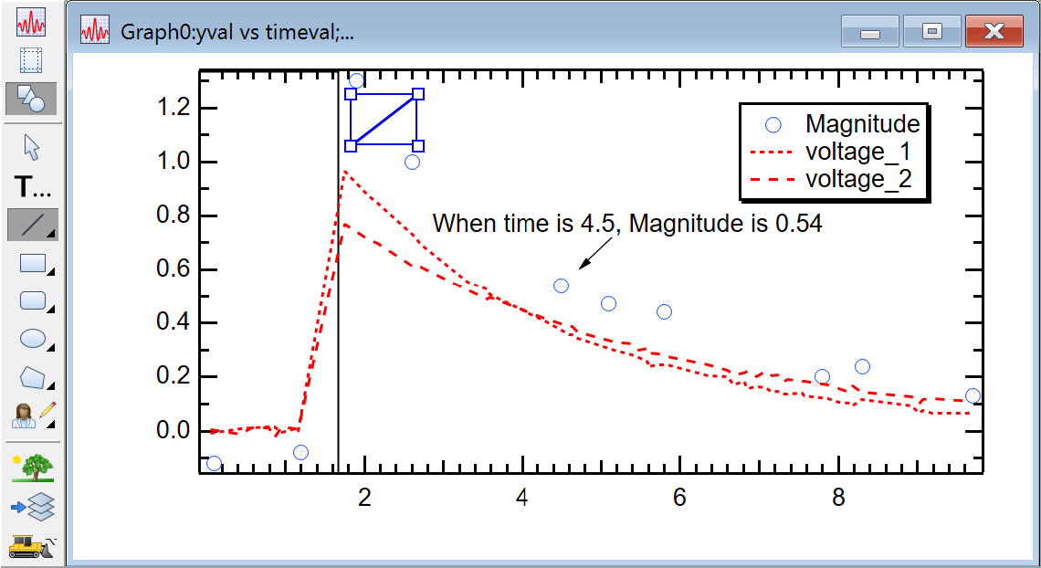

Adding a Tag​

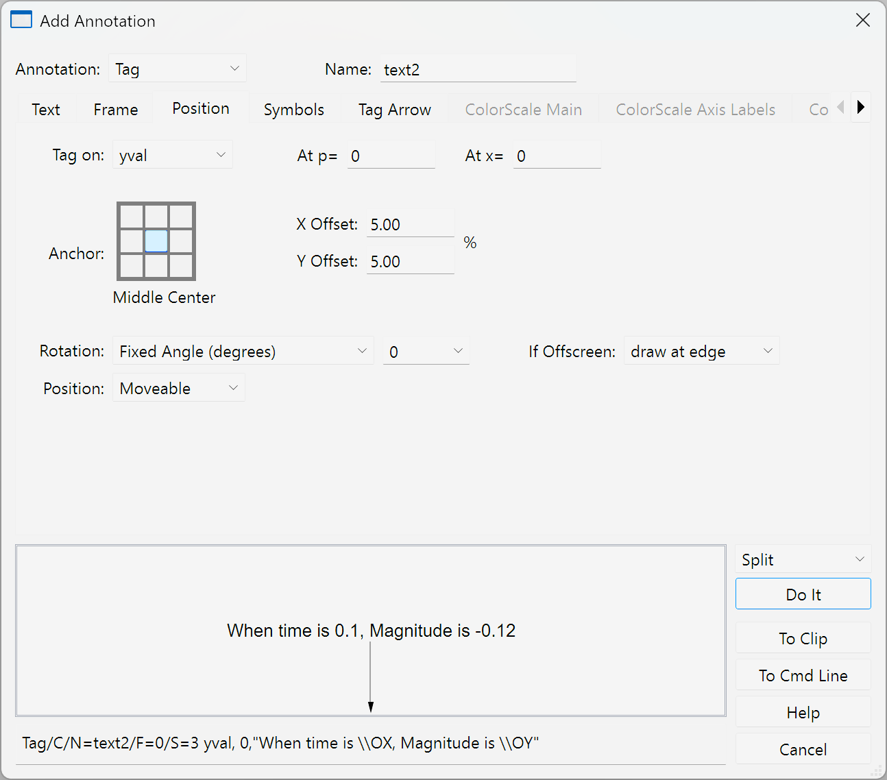

  2. Choose Tag from the Annotation pop-up menu in the top-left corner of the dialog.
  3. Click the Text tab and, in the annotation text entry area, type "When time is ".
  4. Choose Attach Point X Value from the Dynamic pop-up menu in the Insert area of the dialog.
    Igor inserts the "\0X" escape code into the annotation text entry area.
  5. In the annotation text entry area, add ", Magnitude is ".
  6. Choose Attach Point Y Value from the Dynamic pop-up menu.
    Igor inserts the "\0Y" escape code into the annotation text entry area.
  7. Click the Frame tab and choose None from the Annotation Frame pop-up menu.
  8. Click the Tag Arrow tab and choose Arrow from the Connect Tag to Wave With pop-up menu.
  9. Click the Position tab and click the center box in the Anchor control.
    The dialog should now look like this:
  10. Click Do It.
    The tag is attached to the first point. An arrow is drawn from the center of the tag to the data point but you can't see it because it is hidden by the tag text.

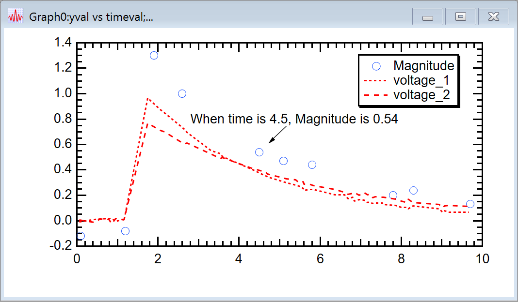

  11. Position the cursor over the text of the tag.
    The cursor changes to a hand. This indicates you can reposition the tag relative to the data point it is attached to.
  12. Click and drag the tag up and to the right about 1 cm.
    You can now see the arrow.
  13. With the cursor over the text of the tag, press Alt.
    The cursor changes to this shape: . (You may need to nudge the cursor slightly to make it change.)
  14. With the Alt key still down, click and drag the box cursor to a different data point.
    The tag jumps to the new data point and the text is updated to show the new X and Y values. Alt-drag the tag to different data points to see their X and Y values..
    Notice that the tip of the arrow touches the marker. This doesn't look good, so let's change it:
  15. Double-click the text part of the tag.
    The Modify Annotation dialog appears.
  16. Click the Tag Arrow tab and change the Line/Arrow Standoff from "Auto" to "10".
  17. Click the Change button.
    The tip of the arrow now stops 10 points from the marker.

Making a Page Layout​
  1. Choose the Windows→New Layout menu item.
    The New Page Layout dialog appears. The names of all tables and graphs are shown in the list.
  2. In the Objects to Lay Out list, select Graph0.
  3. Ctrl-click on Table0.
  4. Click Do It.
    A page layout window appears with a Table0 object on top of a Graph0 object.
    The layout initially shows the page at 50% magnification but you may prefer to work at 100%. You can use the pop-up menu in the lower left corner of the window to change magnification.
  5. Click the Table0 object in the layout window.
    The table object becomes selected, resize handles are drawn around the edges, and the cursor changes to a hand when over the table.
  6. Click in the middle of the table and drag it so you can see the right edge of the table.
  7. Position the cursor over the handle (small black square) in the middle of the right edge of the table.
    The cursor changes to a two headed arrow indicating you can drag in the direction of the arrows.
  8. Drag the edge of the table to the left until it is close to the edge of the third column of data.
    You need only get close -- Igor snaps to the nearest grid line.
  9. In a similar fashion, adjust the bottom of the table to show all the data but without any blank rows.
  10. Arrange the table and graph objects in the layout to approximately match this picture:
  11. Click this icon in the tool palette:
    This activates the drawing tools.
  12. Click this icon in the drawing tool palette:
    This is the polygon tool.

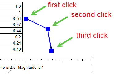

  13. Click once just to the right of the table, click again about 2 cm right and 1 cm down and finally double-click a bit to the right of the last click and just above the graph, as illustrated:
    The double click exits the "draw polygon" mode and enters "edit polygon mode". If you wish to touch up the defining vertices of the polygon, do so now by dragging the handles (the square boxes at the vertices).
  14. Click the Arrow tool in the palette.
    This exits polygon edit mode.
  15. Click the polygon to select it.
  16. Click the drawing environment icon () and choose At End from the Line Arrow submenu.
  17. Click this icon in the tool palette:
    This is the operate icon. The drawing tools are replaced by the normal layout tools.
    We are finished with the page layout for now.

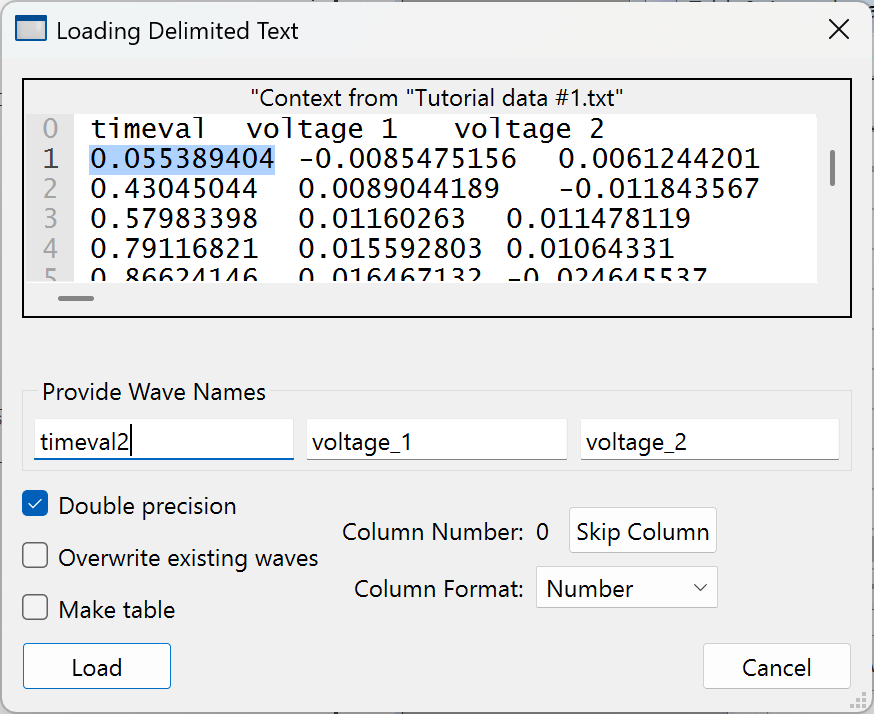

    Now we will actually load the data.
  6. Choose Data→Load Waves→Load Delimited Text.
    An Open File dialog appears.
  7. Again choose "Tutorial Data #1.txt" and click Open.
    The Loading Delimited Text dialog appears. The name "timeval" is highlighted and an error message is shown. Observe that the names of the other two columns have been fixed up by replacing the spaces with underscore characters.
  8. Change "timeval" to "timeval2".
  9. Click the Make Table box to check it and then click Load.
    The data is loaded and a new table is created to show the data.
  10. Click the close button of the new table window.
    A dialog is presented asking if you want to create a recreation macro.
  11. Click the No Save button.
    The data we just loaded is still available in Igor. A table is just a way of viewing data and is not necessary for the data to exist.
The Load Delimited Text menu item that you used is a shortcut that uses default settings for loading delimited text. Later, when you load your own data files, choose Data→Load Waves→Load Waves so you can see all of the options.
Appending to a Graph​
  1. If necessary, click on Graph0 to bring it to the front.
    The Graph menu is available only when the target window is a graph.
  2. Choose the Graph→Append Traces to Graph menu item.
    The Append Traces dialog appears. It is very similar to the New Graph dialog that you used to create the graph.
  3. In the Y Waves list, select voltage_1 and voltage_2.
  4. From the XWave list, select timeval2.
  5. Click Do It.
    Two additional traces are appended to the graph. Notice that they are also appended to the Legend.
  6. Position the cursor over one of the traces in the graph and double-click.
    The Modify Trace Appearance dialog appears with the trace you double-clicked already selected.
  7. If necessary, select voltage_1 from the list of traces.
  8. Choose dashed line #2 from the Line Style pop-up menu.
  9. Select voltage_2 from the list of traces.
  10. Choose dashed line #3 from the Line Style pop-up menu.
  11. Click Do It.

    The Shift key constrains movement to vertical or horizontal.
    You have added an offset to the trace. If desired, you could add a Tag to the trace indicating that it has been offset and by how much. This trace offset does not affect the underlying wave data.
Unoffsetting a Trace​
  1. Choose the Edit→Undo Trace Drag menu item.
    You can undo many of the interactive operations on Igor windows.
  2. Choose Edit→Redo Trace Drag.
    The following steps show how to remove an offset after it is no longer undoable.
  3. Double-click the voltage_2 trace.
    The Modify Trace Appearance dialog appears with voltage_2 selected. (If voltage_2 is not selected, select it.) The Offset checkbox is checked.
  4. Click the Offset checkbox.
    This turns offset off for the selected trace and the offset controls in the dialog are hidden.
  5. Click Do It.
    The voltage_2 trace is returned to its original position.
Drawing in a Graph​
  1. If necessary, click Graph0 to bring it to the front.
  2. Choose the Graph→Show Tools menu item or press Ctrl+T.
    A tool palette is added to the graph. The third icon from the top () is selected indicating that the graph is in drawing mode as opposed to normal (or "operate") mode.
  3. Click the top icon () to go into normal mode.
    Normal mode is for interacting with graph objects such as traces, axes and annotations. Drawing mode is for drawing lines, rectangles, polygons and so on.
  4. Click the third icon () to return to drawing mode.
  5. Click the drawing layer icon
    A pop-up menu showing the available drawing layers and their relationship to the graph layers appears. The items in the menu are listed in back-to-front order.
  6. Choose UserBack from the menu.
    We will be drawing behind the axes, traces and all other graph elements.
  7. Click the rectangle tool and drag out a rectangle starting at the upper left corner of the plot area (y=1.4, x=0 on the axes) and ending at bottom of the plot area and about 1.5 cm in width (y= -0.2, x= 1.6).
  8. Click the line tool and draw a diagonal line as shown, starting at the left, near the peak of the top trace, and ending at the right:
  9. Click the drawing environment icon () and choose At Start from the Line Arrow item.
  10. Click the Text tool icon .
  11. Click just to the right of the line you just drew.
    The Create Text dialog appears.
  12. Type "Precharge".
  13. From the Anchor control, choose the middle box on the left side.
  14. Click Do It.
  15. Click the graph's maximize button.
    Notice how the rectangle and line expand with the graph. Their coordinates are measured relative to the plot area (rectangle enclosed by the axes).
  16. Click the graph's restore button.
  17. Click the Arrow tool and then double click the rectangle.
    The Modify Rectangle dialog appears showing the properties of the rectangle.
  18. Enter "0" in the Thickness box in the Line Properties section.
    This turns off the frame of the rectangle.
  19. Choose Solid from the Fill Mode pop-up menu.
  20. Choose a light gray color from the Fore Color pop-up menu under the Fill Mode pop-up menu.
  21. Click Do It.
    Observe that the rectangle forms a gray area behind the traces and axes.
  22. Again, double click the rectangle.
    The Modify Rectangle dialog appears.
  23. From the X Coordinate pop-up menu, choose Axis Bottom.
    The X coordinates of the rectangle will be measured in terms of the bottom axis -- as if they were data values.
  24. Press Tab until the X0 box is selected and type "0".
  25. Tab to the X1 box and type "1.6".
  26. Tab to the Y0 box and type "0".
  27. Tab to Y1 and type "1".
    The X coordinates of the rectangle are now measured in terms of the bottom axis and the left side will be at zero while the right side will be at 1.6.
    The Y coordinates are still measured relative to the plot area. Since we entered zero and one for the Y coordinates, the rectangle will span the entire height of the plot area.
  28. Click Do It.
    Notice the rectangle is nicely aligned with the axis and the plot area.
  29. Click in the operate icon () to exit drawing mode.
  30. Press Alt, click in the middle of the plot area and drag about 2 cm to the right.
    The X axis range changes. Notice that the rectangle moved to align itself with the bottom axis.
  31. Choose Edit→Undo Modify.

Graphically Editing Data​
  1. If you quit Igor after the last save, open your "Tour 1B.pxp" experiment and turn preferences off.
  2. Adjust the positions of the graph and table so you can see both.
    Make sure you can see the columns of data in the table when the graph is the front window.
  3. If necessary, click the Graph0 window to bring it to the front.
  4. Click the drawing mode icon () to activate the drawing tools.
  5. Move the cursor over the polygon icon () and click and hold the mouse button.
    A pop-up menu appears.
  6. Choose the Edit Wave menu item.
  7. Click one of the open circles of the yval trace.
    (yval is labeled "Magnitude" in the legend.)
    The trace is redrawn using lines and squares to show the location of the data points.
  8. Click the second square from the left and drag it 1 cm up and to the right.
    Notice point 1 of yval and timeval changes in the table.
  9. Press Ctrl+Z or choose Edit→Undo.
  10. Click midway between the first and second point and drag up 1 cm.
    A new data points is added to the yval and timeval waves.
  11. Press Alt and click the new data point.
    The new data point is deleted.
    You could also have pressed Ctrl+Z to undo the insertion.
  12. Press Ctrl, click the line segment between the second and third point and drag a few cm to the right.
    The line segment is moved and two points of yval and timeval are changed in the table.
  13. Press Ctrl+Z or choose Edit→Undo.
  14. Click in the operate icon () to exit draw mode.
  15. Choose File→Revert Experiment and answer Yes to the resulting dialog.
    This returns the experiment to the state it was in before we started editing the data.

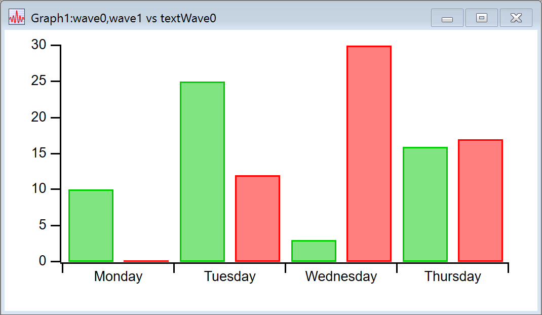

    A category plot is created.
  11. Double-click one of the bars.
  12. Using the Color pop-up menu, set the color of the wave0 trace to green.
  13. Click Do It.

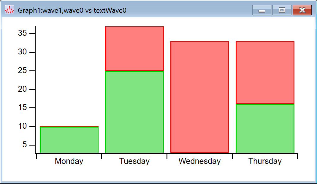

Category Plot Options (Optional)​
This section explores various category-plot options. If you are not particularly interested in category plots, you can stop now, or at any point in the following steps, by skipping to the next section.
  1. Double-click one of the bars and, if necessary, select the wave0 trace in the list.
  2. From the Grouping pop-up menu, choose Stack on Next.
  3. Click Do It.
    The left bar in each group is now stacked on top of the right bar.
  4. Choose the Graph→Reorder Traces menu item.
    The Reorder Traces dialog appears.
  5. Reverse the order of the items in the list by dragging the top item down and click Do It.
    The bars are no longer stacked and the bars that used to be on the left are now on the right. The reason the bars are not stacked is that the trace that we set to Stack on Next mode is now last and there is no next trace.
  6. Using the Modify Trace Appearance dialog, set the wave1 trace to Stack on next. Click Do It.
    The category plot graph should now look like this:

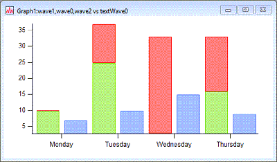

  8. Click the graph to bring it to the front.
  9. Choose Graph→Append to Graph→Category Plot.
    The Append Category Traces dialog appears.
  10. In the Y Waves list, select wave2 and click Do It.
    This adds a red bar underneath each green bar.
  11. Right-click one of the new red bars (underneath a green bar) to display the contextual pop-up menu and choose blue from the Color submenu.
    The new bars are now blue.
  12. Using the Modify Trace Appearance dialog, change the grouping mode of the middle trace, wave0, to none.
    We now have wave1 (red) stacked on wave0 (green) and wave0 not stacked on anything.
    Now the new wave2 bars (blue) are to the right of a group of two stacked bars. You can create any combination of stacked and side-by-side bars.

The Command Window​
Parts of this tour make use of Igor's command line to enter mathematical formulae. Let's get some practice now.
  1. Choose File→New Experiment.
    This clears any windows and data left over from previous experimentation.
    Your command window should look something like this:
    If you don't see the command window, choose Windows→Command Window.
    The command line is the space below the red separator while the space above the separator is called the history area.
  2. Click in the command line, type the following line and press Return or Enter.
    Print 2+2
    The Print command as well as the result are placed in the history area.
  3. Press Up Arrow.
    The line containing the print command is selected, skipping over the result printout line.
  4. Press Return or Enter.
    The selected line in the history is copied to the command line.
  5. Edit the command line so it matches the following and press Return or Enter.
    Print "The result is ", 2+2
    The Print command takes a list of numeric or string expressions, evaluates them and prints the results into the history.
  2. If necessary, uncheck the From Target checkbox.
  3. In the Y Waves list, select "spiralY".
  4. In the X Wave list, select "_calculated_".
  5. Click Do It.

  1. Position the cursor in the interior of the graph.
    The cursor changes to a cross-hair shape.
  2. Click and drag down and to the right to create a marquee as shown:
    You can resize the marquee with the handles (black squares). You can move the marquee by dragging the dashed edge of the marquee.
  3. Position the cursor inside the marquee.
    The mouse pointer changes to this shape: , indicating that a pop-up menu is available.
  4. Click and choose Expand from the pop-up menu.
    The axes are rescaled so that the area enclosed by the marquee fills the graph.

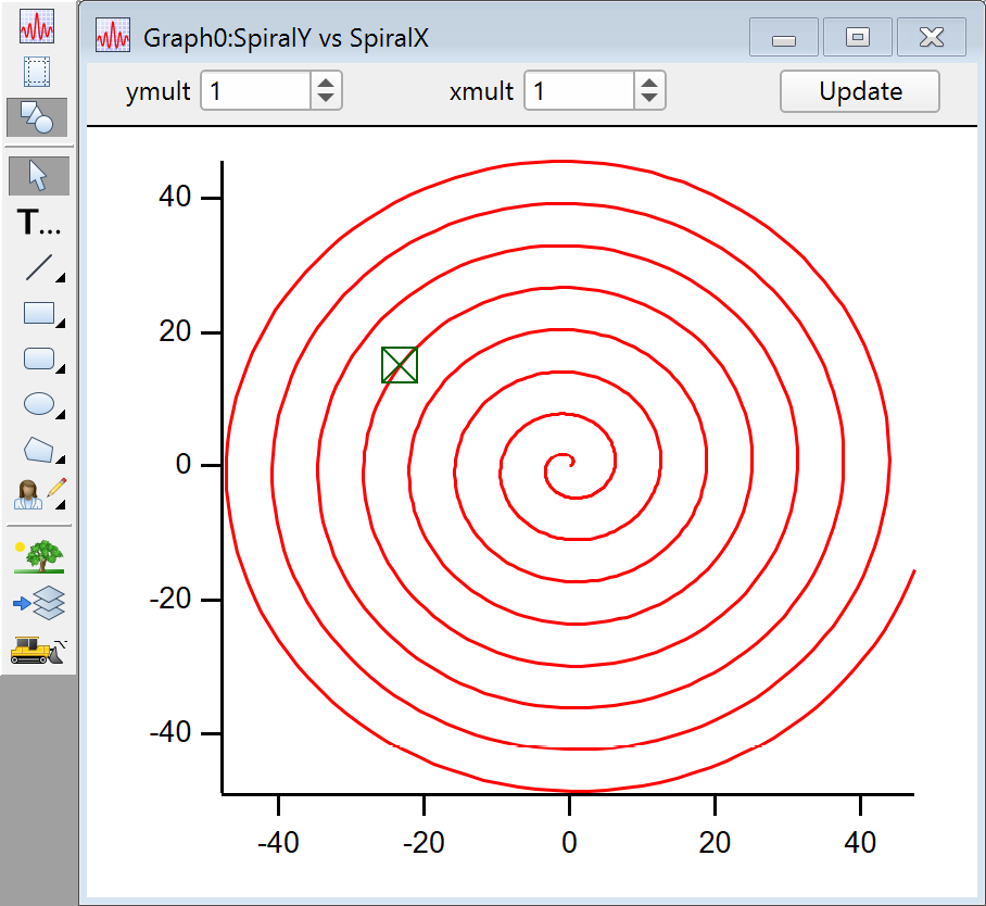

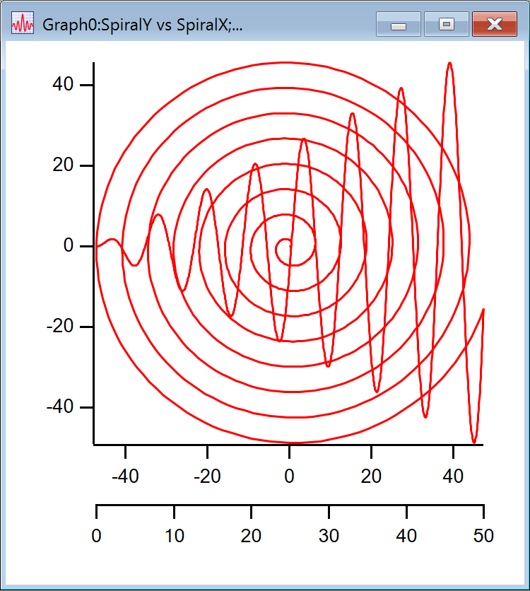

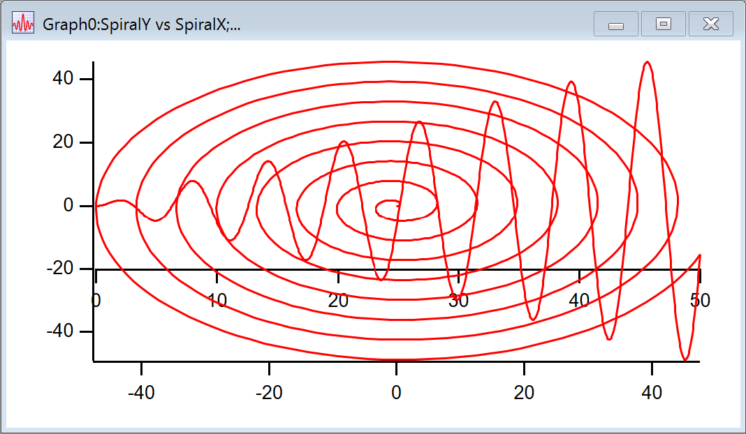

Making a Graph with Multiple Axes​
  2. If you see a button labeled More Choices, click it.
    We will use the more complex form of the dialog to create a multiple-axis graph in one step.
  4. In the X Wave list, select "spiralX".
  5. Click Add.
    The selections are inserted into the lower list in the center of the dialog.
  6. In the Y Waves list, again select "spiralY".
  7. In the X Wave list, select "_calculated_".
  8. Choose New from the Axis pop-up menu under the X Waves list.
  9. Enter "B2" in the name box.
  10. Click OK.
    Note the command box at the bottom of the dialog. It contains two commands: a Display command corresponding to the initial selections that you added to the lower list and an AppendToGraph command corresponding to the current selections in the Y Waves and X Wave lists.
  11. Click Do It.
    The following graph is created:
    The interior axis is called a "free" axis because it can be moved relative to the plot rectangle. We will be moving it outside of the plot area but first we must make room by adjusting the plot area margins.
  12. Press Alt and position the cursor over the bottom axis so that it changes to this shape: .
    This cursor indicates you are over an edge of the plot area rectangle and that you can drag that edge to adjust the margin.
  13. Click and drag the margin up about 2 cm. Release Option or Alt.
  14. Drag the interior axis down into the margin space you just created.
  15. Resize the graph so the spiral is nearly circular.

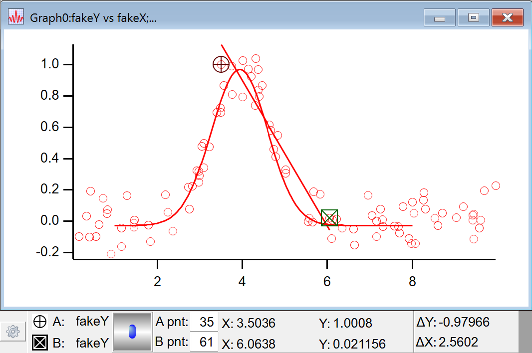

Using Cursors​
  1. If you are returning from a break, open your "Tour 1C.pxp" experiment and turn preferences off.
  2. Click in the graph and choose the Graph→Show Info menu item.
    A cursor info panel appears below the graph.
  3. Right-click in the name area for graph cursor A (the round one), where it says "A:".
  4. Choose "spiralY" from the pop-up menu.
    The A cursor is placed on point zero of spiralY.
  5. Repeat for cursor B but choose "spiralY#1" from the pop-up menu.
    The wave spiralY is graphed twice. The #1 suffix is used to distinguish the second instance from the first. It is #1 rather than #2 because in Igor indices start from zero.
  6. Position the mouse pointer over the center of the cursor position control .
  7. Click the blue slider and gently drag it to the right.
    Both cursors move to increasing point numbers. They stop when one or both get to the end.
    You can also move the cursors using the left and right arrow keys on the keyboard or by clicking to the left or right of the blue slider.
  8. Practice moving the slider to the left and right.
    Notice that the cursors move with increasing speed as the slider is displaced farther from the center.
  9. Click once on the dock for cursor A (the round black circle).
    The circle turns white, indicating that cursor A is deselected.
  10. Move the slider to the left and right.
    Notice that only cursor B moves.
  11. Click cursor B in the graph and drag it to another position on either trace.
    You can also drag cursors from their docks to the graph.
  12. Click cursor A in the graph and drag it completely outside the graph.
    The cursor is removed from the graph and returns to its dock.
  13. Choose Graph→Hide Info.
  14. Click on the command window, type the following and press Return or Enter.
    Print vcsr(B)
    The Y value at cursor B is printed into the history area. There are many functions available for obtaining information about cursors.
  15. Click in the graph and then drag cursor B off of the graph.

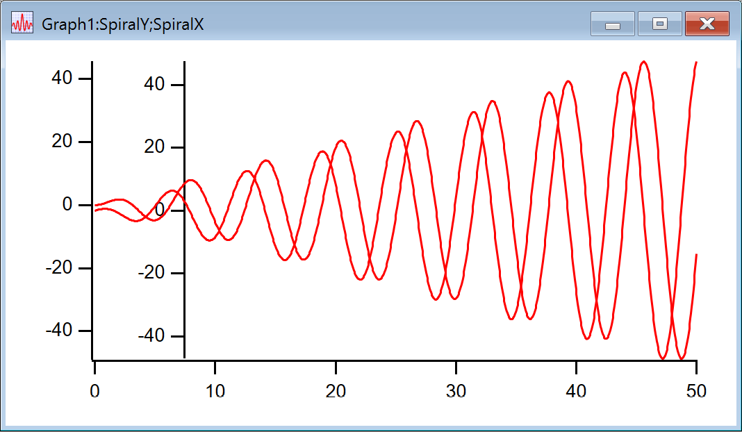

Creating a Graph with Stacked Axes​
  5. Click Add.
  6. In the Y Waves list, select "spiralX".
  8. Choose New from the Axis pop-up menu under the Y Waves list.
  9. Enter "L2" in the name box.
  10. Click OK.
  11. Click Do It.
    In the following steps we will stack the L2 axis on top of the left axis.
  12. Double-click the far left axis.
    The Modify Axis dialog appears. If any other dialog appears, cancel and try again making sure the cursor is over the axis.
    The Left axis should be selected in the Axis pop-up menu in the upper left corner of the dialog.
  13. Click the Axis tab.
  14. Set the Left axis to draw between 0 and 45% of normal.
  15. Choose L2 from the Axis pop-up menu.
  16. Set the L2 axis to draw between 55 and 100% of normal.
  17. In the Free Axis Position box, pop up the menu reading Distance from Margin and select Fraction of Plot Area.
  18. Verify that the box labeled "% of Plot Area" is set to zero.
    Steps 17 and 18 move the L2 axis so it is in line with the Left axis.
    Why don't we make this the default? Good question - positioning as percent of plot area was added in Igor Pro 6; the default behavior maintains backward compatibility.
  19. Choose Bottom from the Axis pop-up menu.
    20 Click the Axis Standoff checkbox to turn standoff off.
  20. Click Do It.
  21. Resize and reposition the Graph0 and Graph1 windows so they are side-by-side and roughly square.
    The graphs should look like this:

    The SetVariable Control dialog appears.
    A SetVariable control provides a way to display and change the value of a variable.
  8. Choose "ymult" from the Value pop-up menu.
  9. Enter 100 in the Width edit box.
    This setting is back near the top of the scrolling list.
  10. Set the High Limit, Low Limit, and Increment values to 10, 0.1, and 0.1 respectively.
    You may need to scroll down to find these settings.
  11. From the Font Size pop-up menu, choose 12.
    You may need to scroll down to find this pop-up menu.
  12. Click Do It.
    A SetVariable control attached to the variable ymult appears in the upper left of the control bar.
  13. Double-click the ymult control.
  14. Click the Duplicate button at the bottom of the dialog.
  15. Choose xmult as the value.
  16. Click Do It.
    A second SetVariable control appears in the control bar. This one is attached to the xMult variable.
  17. Choose Graph→Add Control→Add Button.
    The Button Control dialog appears.
  18. Tab to the Title edit box and enter "Update".
  19. Click the New button adjacent to Procedure.
    The Control Procedure dialog appears in which you can create or edit the procedure to be called when control-related events occur. Such procedures are called "control action procedures".
  20. Make sure the checkbox labeled "Prefer structure-based procedures" is checked.
  21. Edit the procedure text so it looks like this:
    Function ButtonProc(ba) : ButtonControl
    STRUCT WMButtonAction& ba
    switch(ba.eventCode)
    case 2: // Mouse up
    WAVE spiralX
    NVAR xmult
    spiralX = x*cos(xmult*x)
    WAVE spiralY
    NVAR ymult
    spiralY = x*sin(ymult*x)
    break
    endswitch
    return 0
    Proofread the function to make sure you entered it as shown above.
  22. Click the Save Procedure Now button.
    The Control Procedure dialog disappears and the text you edited is inserted into the (currently hidden) built-in procedure window.
  23. Click Do It.
    A Button control is added to the control bar.
    The three controls are now functional but are not esthetically arranged.
  24. Use the Arrow tool to rearrange the three controls into a more pleasing arrangement. Expand the button so it doesn't crowd the text by dragging its handles.
    After selecting a control with the arrow tool, you can drag it or use the arrow keys on the keyboard to finetune is position.
    The graph now looks like this:
  25. Click the top icon in the tool palette to enter "operate mode".
  26. Choose Graph→Hide Tools or press Ctrl+T.
  27. Click the up arrow in the ymult control.
    The value changes to 1.1.
  28. Click the Update button.
    The ButtonProc procedure that you created executes. The spiralY and spiralX waves are recalculated according to the expressions you entered in the procedure and the graphs are updated.
  29. Experiment with different ymult and xmult settings as desired.
  30. Set both values back to 1 and click the Update button.
    You can use edit a value by typing in the SetVariable control and enter it by pressing Return or Enter.
Creating a Dependency​
A dependency is a rule that relates the value of an Igor wave or variable to the values of other waves or variables. By setting up a dependency you can cause Igor to automatically update a wave when another wave or variable changes.
  1. Click the command window to bring it to the front.
  2. Execute the following commands in the command line:
    spiralY := x * sin(ymult * x)
    spiralX := x * cos(xmult * x)
    This is exactly what you entered before except here ":=" is used in place of "=". The := operator creates a dependency formula. In the first expression, the wave spiralY is made dependent on the variable ymult. If a new value is stored in ymult then the values in spiralY are automatically recalculated from the expression.
  3. Click Graph0 to bring it to the front.
  4. Adjust the ymult and xmult controls but do not click the Update button.
    When you change the value of ymult or xmult using the SetVariable control, Igor automatically executes the dependency formula. The spiralY or spiralX waves are recalculated and both graphs are updated.
  5. On the command line, execute this:
    ymult := 3 * xmult
    The ymult SetVariable control as well as the graphs are updated.
  6. Adjust the xmult value.
    Again notice that ymult as well as the graphs are updated.
  7. Choose the Misc→Object Status menu item.
    The Object Status dialog appears. You can use this dialog to examine dependencies.
  8. Click the Current Object pop-up and choose spiralY from the Data Objects list.
    The list on the right indicates that spiralY depends on the variable ymult.
  9. Double-click the ymult entry in the right-hand list.
    ymult becomes the current object. The list on the right now indicates that ymult depends on xmult.
  10. Click the Delete Formula button.
    Now ymult no longer depends on xmult.
  11. Click Done.
  12. Adjust the xmult setting.
    The ymult value is no longer automatically recalculated but the spiralY and spiralX waves still are.
  13. Click the Update button.
  14. Adjust the xmult and ymult settings.
    The spiralY and spiralX waves are no longer automatically recalculated. This is because the ButtonProc function called by the Update button does a normal assignment using "=" rather than ":=" and that action removes the dependency formulae.
In real work, you should avoid using dependencies because they are hard to keep track of and debug. If a button can do the job then use it rather than the dependency. A more complicated alternative is to add a procedure to the SetVariable controls that updates the waves any time those controls change the values of the variables.

We need something to analyze, so we generate some random X values and create some Y data using a math function.
  1. Type the following in the command line and then press Return or Enter:
    SetRandomSeed 0.1
    This initializes the random number generator so you will get the same results as this guided tour.
  2. Type the following in the command line and then press Return or Enter:
    Make/N=100 fakeX = enoise(5)+5,fakeY
    This generates two 100 point waves and fills fakeX with evenly distributed random values ranging from 0 to 10.
  3. Execute this in the same way:
    fakeY = exp(-(fakeX-4)^2)+gnoise(0.1)
    This generates a Gaussian peak centered at 4.
  4. Choose the Windows→New Graph menu item.
  5. If you see a button labeled Fewer Choices, click it.
  6. In the Y Waves list, select "fakeY".
  7. In the XWave list, select "fakeX".
  8. Click Do It.
    The graph is a rat's nest of lines because the X values are not sorted.
  9. Double-click the red trace.
  10. From the Mode pop-up choose Markers.
  11. From the Markers pop-up menu choose the open circle.
  12. Click Do It.
    Now the graph makes sense.

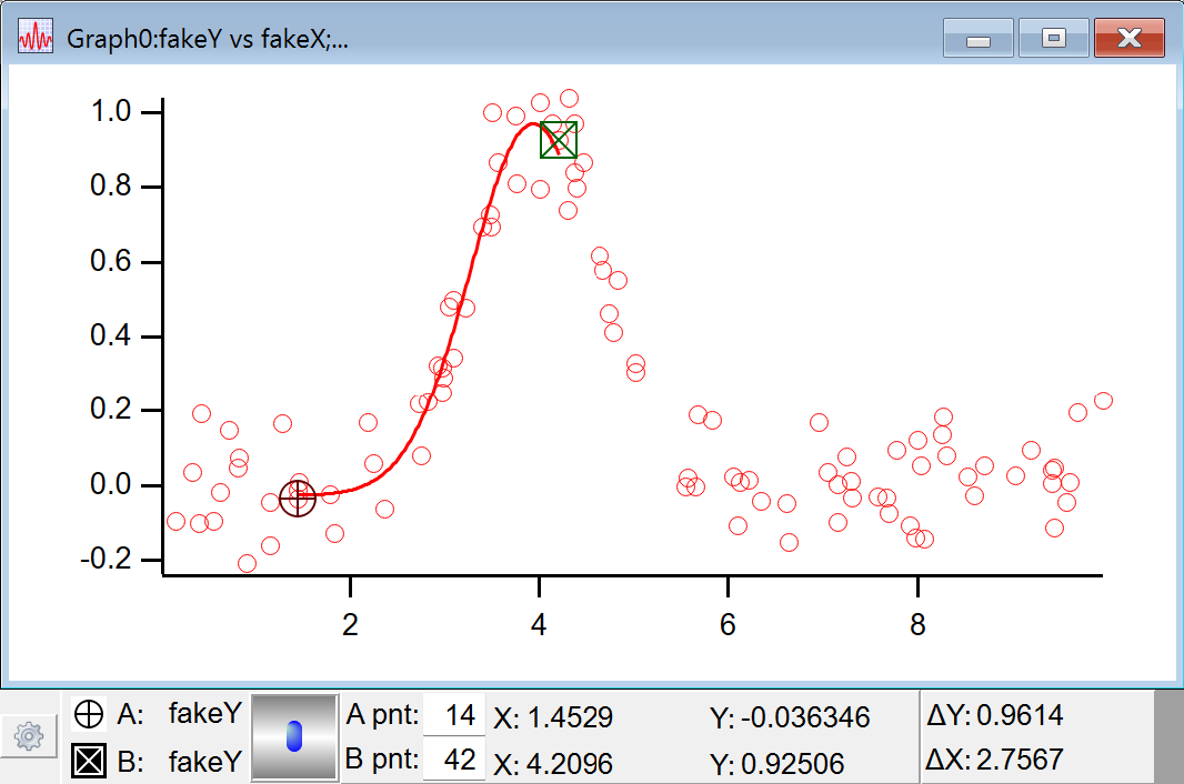

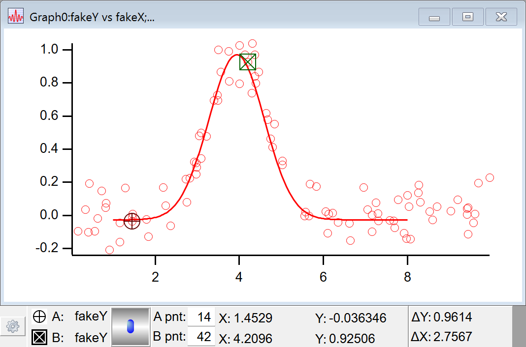

  1. Choose the Graph→Show Info menu item.
    A cursor info panel is appended to the bottom of the graph.
    Two cursors are "docked" in the info panel, Cursor A and Cursor B.
  2. Place cursor A (the round one) on the fakeY trace.
    One way to place the cursor is to drag it to the trace. Another way is to right-click on the name area which is just to the right of the cursor icon in the cursor info panel.
    Note that the cursor A icon in the dock is now black. This indicates that cursor A is selected, meaning that it will move if you use the arrow keys on the keyboard or the slider in the cursor info panel.
  3. Move cursor A to point #14.
    To move the cursor one point at a time, use the arrow keys on the keyboard or click on either side of the slider in the cursor position control.
  4. Click the dock for cursor A in the cursor info panel to deselect it.
    This is so you can adjust cursor B without affecting the position of cursor A.
  5. Place cursor B (the square one) on the fakeY trace and move it to point #42.
    The graph should look like this:
  6. In the Analysis→Quick Fit menu make sure the Fit Between Cursors item is checked. If it is not, select it to check it.
  7. Choose Analysis→Quick Fit→gauss.
    Note that the fit curve is evaluated only over the subrange identified by the cursors.

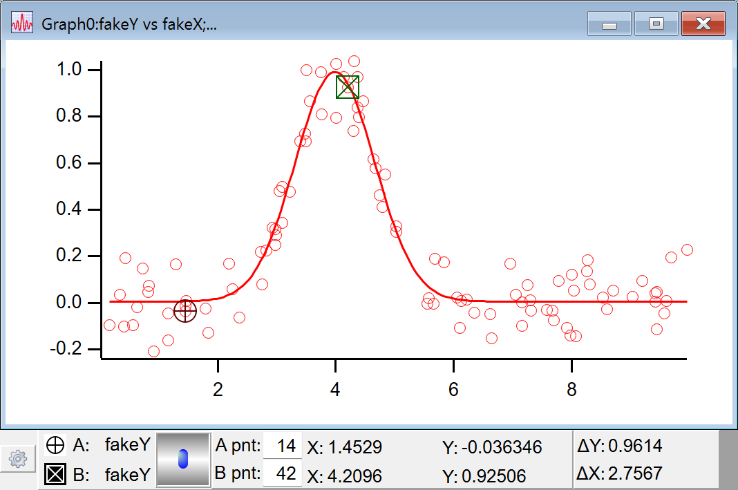

    We would like the fit trace to extend over the entire X range, while fitting only to the data between the cursors. This is one of the options available only in the Curve Fitting dialog.
  8. Choose Analysis→Curve Fitting and then click the Function and Data tab.
    The curve fitting dialog appears and the settings should be as you left them. Check that the function type is gauss, the Y data is fakeY, the X data is fakeX.
  9. Click the Data Options tab.
  10. Click the Cursors button in the Range area.
    This puts the text "pcsr(A)" and "pcsr(B)" in the range entry boxes.
    pcsr is a function that returns the wave point number at the cursor position.
  11. Select the Output Options tab and click the X Range Full Width of Graph checkbox to check it.
  12. Click Do It.
    The curve fit starts, does a few passes and waits for you to click OK.
  13. Click OK.
    The fit was done using only the data between the cursors, but the fit trace extends over the entire X range.
    In the next section, we need the short version of the fit curve, so we will simply do the fit again:
  14. Choose Analysis→Quick Fit→gauss.

To extrapolate, we simply change the X scaling of fit_fakeY and re-execute the fit destination wave assignment statement which the CurveFit operation put in the history area.
  1. Choose the Data→Change Wave Scaling menu item.
  2. If you see a button labeled More Options, click it.
  3. From the SetScale Mode pop-up menu, choose Start and End.
  4. Double-click "fit_fakeY" in the list.
    This reads in the current X scaling values of fit_fakeY. The starting X value will be about 1.77 and the ending X will be about 4.53.
  5. Press Tab until the Start box is selected and type "1.0".
  6. Tab to the End box and type "8.0".
  7. Click Do It.
    The fit_fakeY trace is stretched out and now runs between 1 and 8.
    Now we need to calculate new Y values for fit_fakeY using its new X values.
  8. In the history, find the line that starts "fit_fakeY=" and click it.
    The entire line is selected. (The line in question is near the top of the curve fit report printed in the history.)
  9. Press Return or Enter once to copy the selection from the history to the command line and a second time to execute it.
    The fit_fakeY wave now contains valid data between 1 and 8.

  4. Position the A and B cursors to point numbers 35 and 61 respectively.
    A quick way to do this is to enter the numbers 35 and 61 in the edit boxes to the right of the cursor position control.
  5. Choose Analysis→Quick Fit→line.
    Because there are two traces on the graph, Quick Fit doesn't know which one to fit and puts up the Which Data Set to Quick Fit dialog.
  6. Select fakeY from the list and click OK.
    The line fit is appended to the graph:
This concludes Guided Tour 2.

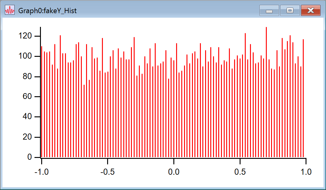

Histogram of White Noise​
Here we will generate a histogram of the evenly distributed "white" noise.
  1. Choose the Analysis→Histogram menu item.
    The Histogram dialog appears.
  2. Select fakeY from the Source Wave list.
  3. Verify that Auto is selected in the Output Wave menu.
  4. Uncheck any checkboxes in the dialog that are checked, including the Display Output Wave checkbox.
  5. Click the Auto-set Bin Range radio button.
  6. Set the Number of Bins box to 100.
    Note in the command box at the bottom of the dialog there are two commands:
    Make/N=100/O fakeY_Hist;DelayUpdate
    Histogram/B=1 fakeY,fakeY_Hist
    The first command makes a wave to receive the results, the second performs the analysis. The Histogram operation in the "Auto-set bin range" mode takes the number of bins from the output wave.
  7. Click the Do It button.
    The histogram operation is performed.
    Now we will display the results.
  8. Choose Windows→New Graph.
  9. Select fakeY_Hist from the Y Waves list and _calculated_ from the X list.
  10. Click the Do It button.
    A graph is created showing the histogram results. Next we will touch it up a bit.
  11. Double-click the trace in the graph.
  12. Choose "Sticks to zero" from the Mode pop-up menu and click the Do It button.
    The graph is redrawn using the new display mode.
  13. Double-click one of the tick mark labels (e.g., "100") of the left axis.
    The Modify Axis dialog appears, showing the Axis Range tab.
    "Left" is selected in the Axis pop-up menu in the top/left corner of the dialog indicating that changes made in the dialog will affect the left axis.
  14. From the two pop-up menus in the Autoscale Settings area, choose "Round to nice values" and "Autoscale from zero".
  15. Choose Bottom from the Axis pop-up menu.
  16. From the two pop-up menus in the Autoscale Settings area, choose "Round to nice values" and "Symmetric about zero".
  17. Click the Do It button.

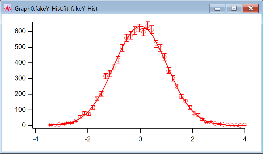

The previous section produces all the pieces required to fit a Gaussian to the histogram data, with proper weighting to account for the variance of Poisson-distributed data.
  1. Click the graph to make sure it is the target window.
  2. In the Analysis→Quick Fit menu make sure the Weight from Error Bar Wave item is checked. If it is not, select it to check it.
  3. Choose Analysis→Quick Fit→gauss.
    As shown in the history area, the fit results are:
    Coefficient values ± one standard deviation
    y0 = 0.4035 ± 0.549
    A = 633.44 ± 7.88
    x0 = 0.014614 ± 0.0102
    width = 1.4272 ± 0.0119
    The original data was made with a standard deviation of 1. Why is the width 1.4272? The way Igor defines its gauss fit function, width is sigma*21/2.
  4. Execute this command in the command line:
    Print 1.4272/sqrt(2)
    The result, 1.00918, is pretty close to 1.0.

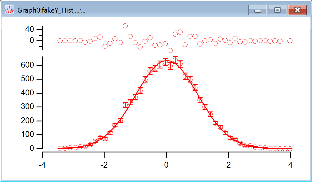

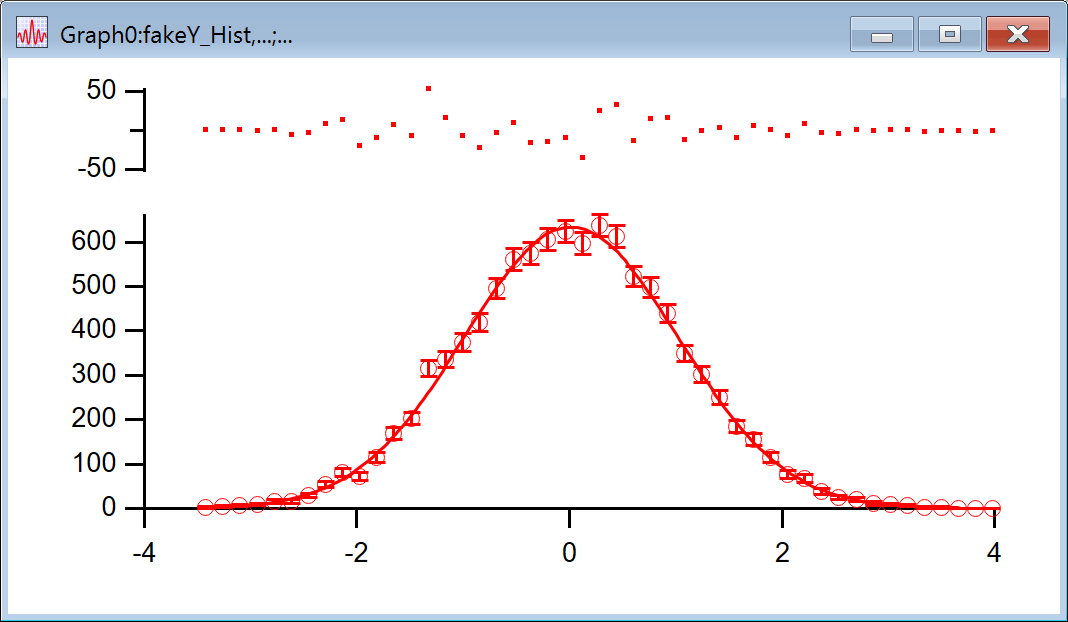

    Now we will append the residuals to the graph stacked above the current contents.
  10. Choose Graph→Append Traces to Graph.
  11. Select histResids from the Y waves list and _calculated_ from the X wave list.
  12. Choose New from the Axis pop-up menu under the Y Waves list.
  13. Enter "Lresid" in the Name box and click OK.
  14. Click Do It.
    The new trace and axis is added.
    Now we need to arrange the axes. We will do this by partioning the available space between the Left and Lresid axes.
  15. Double-click the far-left axis.
    If you have enough screen space you will be able to see the graph change as you change settings in the dialog. Make sure that the Live Update checkbox in the top/right corner of the dialog is selected.
    The Left axis should already be selected in the pop-up menu in the top-left corner of the dialog.
  17. Set the Left axis to draw between 0 and 70% of normal.
  18. Choose Lresid from the Axis pop-up menu.
  19. Set the Lresid axis to draw between 80 and 100% of normal.
  20. Choose Fraction of Plot Area in the "Free axis position" menu.
    The Lresid axis is a "free" axis. This moves it horizontally so it is in line with the Left axis.
  21. Choose Bottom from the Axis pop-up menu.
  22. Click the Axis Standoff checkbox to turn standoff off.
    Just a couple more touch-ups and we will be done. The ticking of the Lresid axis can be improved. The residual data should be in dots mode.
  23. Choose Lresid from the Axis pop-up menu again.
  24. Click the Auto/Man Ticks tab.
  25. Change the Approximately value to 2.
  26. Click the Axis Range tab.
  27. In the Autoscale Settings area, choose "Symmetric about zero" from the menu currently reading "Zero isn't special".
  28. Click the Do It button.
  29. Double-click the histResids trace.
    The Modify Waves Appearance dialog appears with histResids already selected in the list.
  30. Choose Dots from the Mode pop-up menu.
  31. Set the line size to 2.00.
  32. Click Do It.

  15. Choose Windows→New Graph and click the Fewer Choices button if it is available.
  16. Choose fakeY_Hist from the Y Waves list and _calculated_ from the X Wave list and click Do It.
    A graph without residuals is created.
  17. In the command line, execute the following command:
    AppendResiduals(histResids, $"")
    Because we have no X wave, we use $"" to pass NULL to AppendResiduals for the xWave parameter.
    The AppendResiduals function runs and displays the residuals in the graph, above the original histogram data.

    The AppendResidualsDialog function displays a dialog to let you choose parameters.
  24. Choose histResids from the Residuals Data pop-up menu.
  25. Leave the X Wave pop-up set to "_calculated_".
  26. Click Continue.
    The graph should once again contain the residuals plotted on an axis above the main data.

  32. Click the Macros menu and choose the "Append Residuals" item.
    The procedure displays a dialog to let you choose parameters.
  33. Choose histResids from the Residuals Data pop-up menu.
  34. Leave the X Wave pop-up menu set to "_calculated_".
  35. Click Continue.
    The graph should once again contain the residuals plotted on a new axis above the main data.
