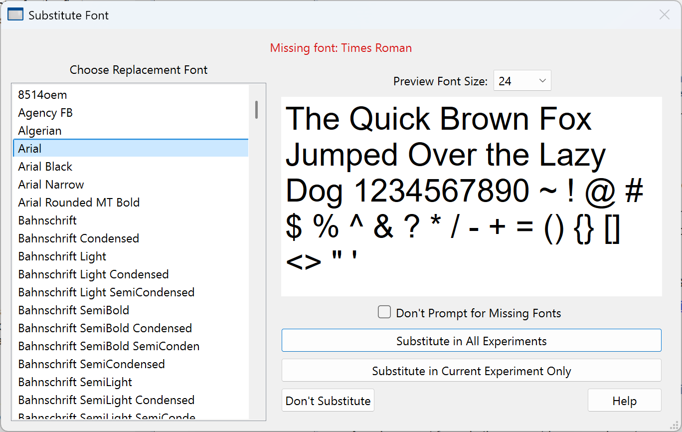

Font Substitution
When a font specified in a command or document is not installed, Igor applies font substitution to choose an installed font to use in place of the missing font. Dealing with these missing fonts often occurs when transferring a Macintosh-originated document to Windows.
Igor employs two levels of font substitution: user-level editable substitution and built-in uneditable substitution.
The first level is an optional user-level font substitution facility that you will usually encounter for the first time when Igor displays the Substitute Font Dialog while opening an experiment or file. Use the dialog to choose a temporary or permanent replacement for the missing font:
The second level is Igor's built-in substitution table which substitutes between fonts normally installed on various Windows operating systems. For example, it substitutes "Arial" (a standard Windows font) for "Geneva" (a standard Macintosh font) if Geneva is not installed (which it usually isn't on a Windows computer).
The user-level substitutions have priority over the built-in substitutions.
The Substitute Font dialog appears when neither level of font substitution specifies a replacement for the missing font. You can prevent this dialog from appearing by checking the Don't Prompt for Missing Fonts checkbox in the Substitute Font dialog.
You can manage font substitutions without waiting for a missing font situation to occur by choosing Misc→Edit Font Substitutions.
The user-level font substitution table is maintained in the "Igor Font Substitutions.txt" text file in Igor's preferences folder. The file format is:
<name of missing font to replace> = <name of font to use instead>
one entry per line. For example:
Palatino=New Times Roman
spaces or tabs are allowed around the equals sign.
When a missing font is "replaced", Igor uses the name of the replacement font instead of the name of the font in the command.
The name of the missing font is replaced only in the sense that the altered or created object (window, control, etc) uses and remembers only the name of the replacement font. Recreation macros, including experiment recreation procedures, use the name of the replacement font when the experiment is saved. The command, however, is unaltered and still contains the name of the missing font.
