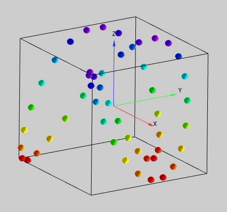

Gizmo 3D Scatter Plot Tour​
In this tour we will create a triplet wave containing XYZ data which we will plot as a 3D scatter plot.
  1. Start a new experiment by choosing File→New Experiment.
  2. To create a triplet wave containing XYX scatter data, execute:
    Make/O/N=(20,3) data = gnoise(5)
    data[][2] = 2*data[p][0] - 3*data[p][1] + data[p][0]^2 + gnoise(0.05)
    This scatter data represents random locations in the XY plane with Z values that are approximately equal to a polynomial function in X and Y.
    As we see in the next couple of steps, the quickest way to display this data in Gizmo is by right-clicking on "data" in the Data Browser and then selecting "New Gizmo Plot".
  3. Choose Data→Data Browser.
    The Data Browser window appears.
  4. Right-click the data wave icon and choose New Gizmo Plot.
    Igor created a Gizmo 3D scatter plot from the data wave in a new window named Gizmo0.
    It also created the Gizmo info window entitled "Gizmo0 Info".
    (If you don't see the "Gizmo0 Info" window, choose Gizmo→Show Info.)
    You can rotate the Gizmo scatter plot by dragging the contents of the Gizmo0 window and using the arrow keys. Feel free to play.

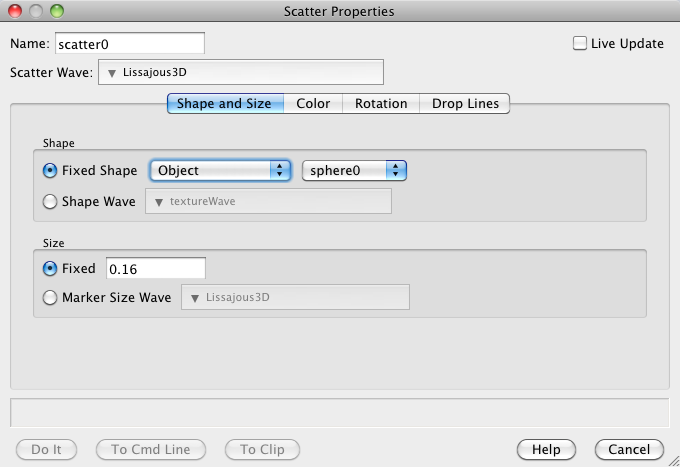

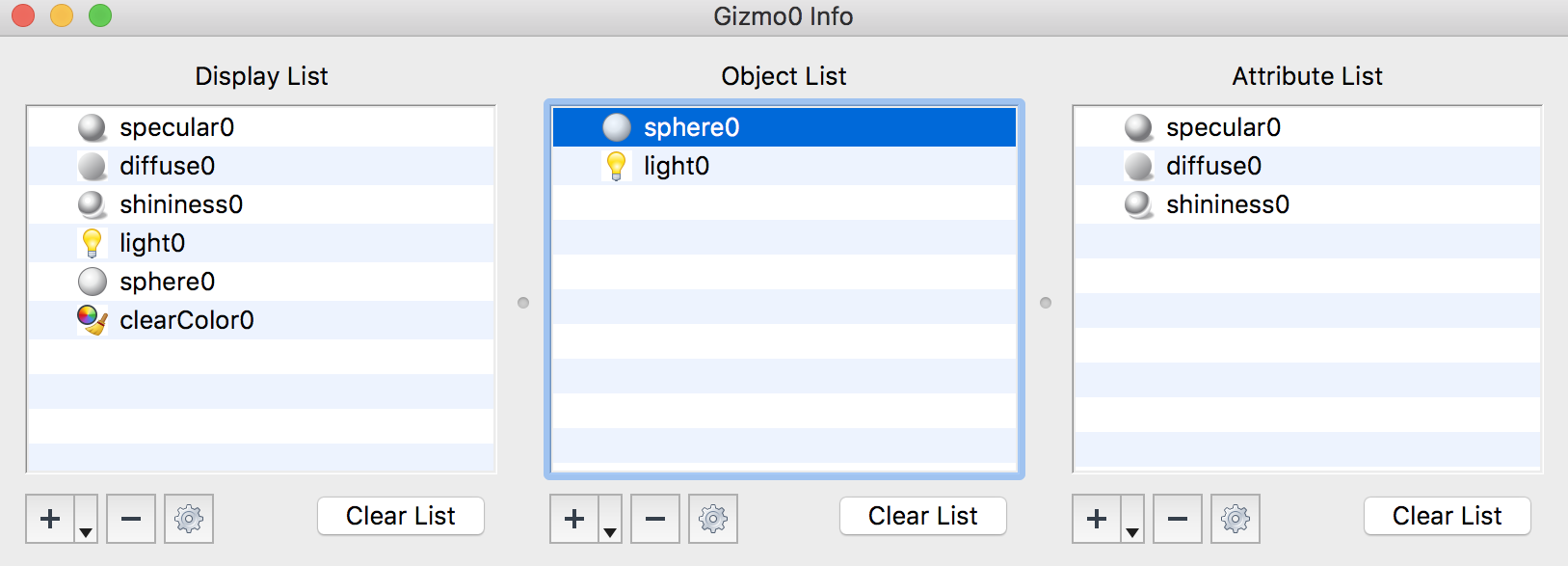

  8. Click the + icon at the bottom of the object list in the Gizmo0 Info window and choose Scatter.
    Igor displays the Scatter Properties dialog.
  9. Choose data from the Scatter Wave menu.
    This menu displays only triplet waves. If you want to create a 3D scatter plot, you must have a triplet wave.
    There are several additional options but we will leave them in their default states for now.
  10. Click Do It.

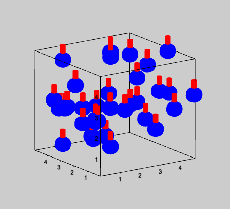

    Igor created a 3D scatter object named scatter0 and added it to the object list in the info window. It is not yet visible in the Gizmo0 window because we have not yet added it to the display list.
  11. Drag the scatter0 object from the object list to the display list.
    Spheres representing the XYZ data appear in the Gizmo0 window. Although the plot is by no means complete, you can click and drag the body of the Gizmo0 window to rotate the display.
  12. In the Gizmo0 Info window, click the "+" icon at the bottom of the object list and choose Axes.

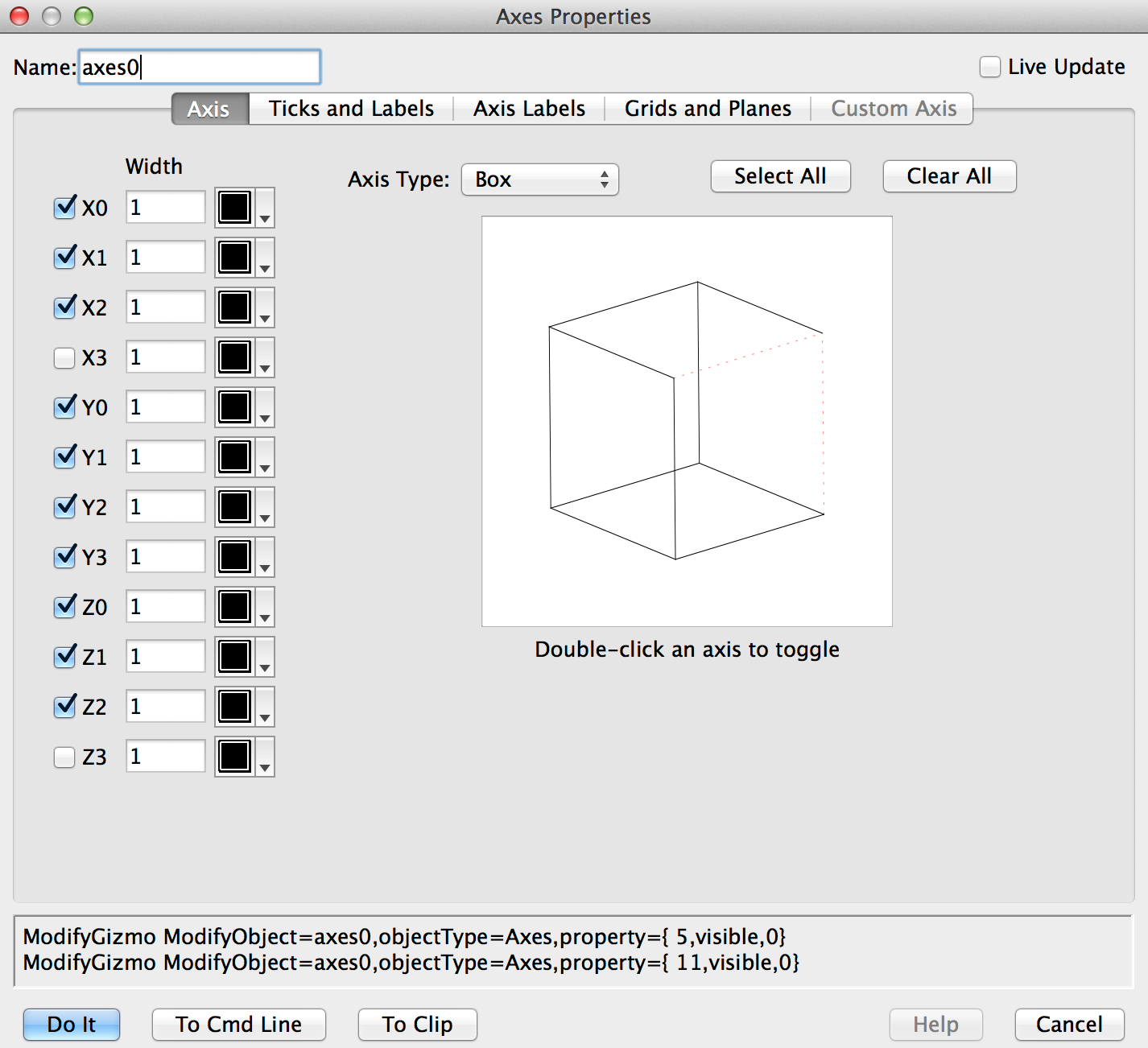

    The Axes Properties dialog appears.
  13. Click the Axis tab if it is not already selected.

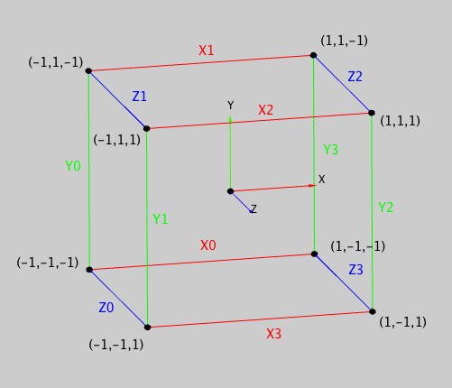

    The Axis Type pop-up menu should be set to Box and all of the axis checkboxes (X0, X1...Z2, Z3) should be checked.
  14. Click Do It.
    Igor created an axes object named axes0 and added it to the object list in the info window. It is not yet visible in the Gizmo0 window because we have not yet added it to the display list.
  15. Drag the axes0 object from the object list to the display list.
    You now have box axes around the scatter spheres.
  16. Double-click the axes0 object in either the object list or the display list.
    The Axes Properties dialog reopens.
  17. Click the Ticks and Labels tab.
  18. Select X0 from the Axis pop-up menu and check the Show Tick Marks and Show Numerical Labels checkboxes.
  19. Select Y0 from the Axis pop-up menu and check the Show Tick Marks and Show Numerical Labels checkboxes.
  20. Select Z0 from the Axis pop-up menu and check the Show Tick Marks and Show Numerical Labels checkboxes.
  21. Click Do It.
    You now have labeled tick marks for the X0, Y0 and Z0 axes.

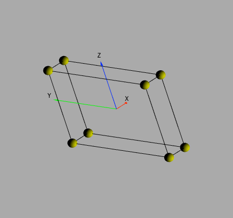

    But which axis is which?

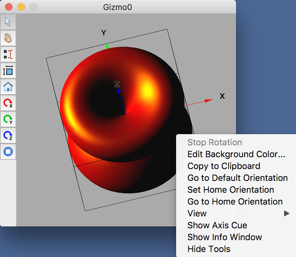

  22. Right-click the body of the Gizmo0 window and select Show Axis Cue.
    Igor adds an axis cue that shows you which dimension is which.
    Rotate the display a bit to get a sense of the axis cue.
    You can also double click the axes0 object and select the Axis tab. The properties dialog displays the box axes. If you now hover with the mouse cursor over any axis you see a tooltip that identifies the axis.
    If tooltips are not displaying in the Axis Properties dialog, please turn them on through Misc → Miscellaneous Settings... → Help → Show Tooltips.

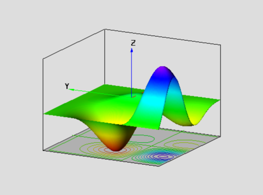

Gizmo Surface Plot Tour​
In this tour we will create a 2D wave containing Z values which we will plot as a surface plot.
  2. To create a 2D matrix of Z values, execute:
    Make/O/N=(100,100) data2D = Gauss(x,50,10,y,50,15)
    This matrix data represents Z values on a regular grid.
    As you saw in the first tour, the quickest way to display this data in Gizmo is by right-clicking an appropriate wave in the Data Browser and selecting Gizmo Plot. The same shortcut works with a matrix of Z values. But we will do it the hard way as this will give you a better understanding of Gizmo.
  3. Choose Windows→New→3D Plot.
    Notice from the history area of the command window that Igor has executed:
    NewGizmo
    Igor also created an empty Gizmo0 window and the Gizmo0 Info window.
  4. Click the + icon at the bottom of the object list in the Gizmo0 Info window and choose Surface.
    Igor displays the Surface Properties dialog.
  5. Choose Matrix from the Source Wave Type pop-up menu and data2D from the Surface Wave pop-up menu.
  6. Click Do It.
    Igor created a surface object named surface0 and added it to the object list in the info window. It is not yet visible in the Gizmo0 window because we have not yet added it to the display list.
  7. Drag the surface0 object from the object list to the display list.
    The surface appears in the Gizmo0 window. You are now looking at it from the top.
  8. Using the mouse, rotate the surface in the Gizmo0 window to reorient it so you can see the side view of the Gaussian peak.
  9. In the Gizmo info window, click the "+" icon at the bottom of the object list and choose Axes.
    The Axes Properties dialog appears. Click the Axis tab if it is not already selected.
  10. Click the Axis tab if it is not already selected.
  11. Click Do It.
    Igor created an axis object named axes0 and added it to the object list in the info window. It is not yet visible in the Gizmo0 window because we have not yet added it to the display list.
  12. Drag the axes0 object from the object list to the display list.
    You now have box axes around the surface plot.
  13. Double-click the axes0 object in the display list. Using the resulting Axes Properties dialog, turn on tick marks and tick mark labels for the X0, Y0 and Z0 axes.
    This is the same as what we did in the preceding tour.
    Now we will add a colorscale annotation.
  14. Choose Gizmo→Add Annotation.
    The Add Annotation dialog appears.
  15. From the Annotation pop-up menu in the top/left corner of the dialog, choose ColorScale.
  16. Click the Position tab and set the Anchor pop-up menu to Right Center.
  17. Click the ColorScale Main tab and set the following controls as indicated:
    Color Table: Rainbow
    Axis Range/Top: 100
    Axis Range/Bottom: 0
  18. Click Do It.
    Igor creates the colorscale annotation.
    Note that its tick mark labels don't agree with the Z axis tick mark labels in the surface plot. We need to set the colorscale range to match the range of the data. We will do this by re-executing the command that created the colorscale.
  19. Click on the last command in the history area of the command window and press Enter to copy it to the command line.
    The command line should now show this:
    ColorScale/C/N=text0/M/A=RC ctab={0,100,Rainbow,0}
  20. Edit the command as shown next and press Enter to execute it:
    ColorScale/C/N=text0/M/A=RC ctab={**WaveMin(data2D),WaveMax(data2D)**,Rainbow,0}
    Now the colorscale tick mark labels agree with the Z axis tick mark labels in the surface plot.
    Next we will add an image plot beneath the surface plot.
  21. In the Gizmo info window, click the "+" icon at the bottom of the object list and choose Image.
    The Gizmo Image Properties dialog appears.
  22. Set the Source Type to 2D Matrix of Z Values, and select data2D from the Source Wave pop-up menu.
    We will use the same wave as the source for both the surface plot and the image.
  23. From the Intitial Orientation pop-up menu, choose XY Plane Z=0.

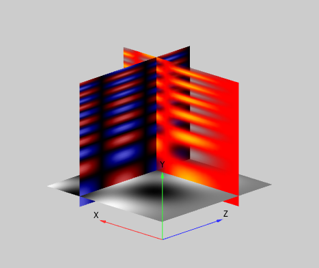

  24. Uncheck all checkboxes except Translate and set the X, Y, and Z components of the translation to 0, 0, and -1 respectively.
    The translation in the Z direction moves the image from the center of the display volume to the bottom of the display volume, placing it on the "floor" of the surface plot.
  25. Click Do It.
    Igor created an image object named image0 and added it to the object list in the info window. It is not yet visible in the Gizmo0 window because we have not yet added it to the display list.
  26. Drag the image0 object from the object list to the display list.
    You now have an image plot below the surface plot. You may need to rotate the display to see it.
  27. Double-click the image0 object in the object list, set the Z translation to -1.5, then click Do It.
    This separates the image plot from the surface plot, making it easier to see.

Gizmo 3D Scatter Plot and Fitted Surface Tour​
In this tour we will create a 3D scatter plot from a triplet wave, perform a curve fit, and append a surface showing how the curve fit output relates to the original scatter data.
    The quickest way to display this data in Gizmo is by right-click selecting "Gizmo Plot" in the Data Browser.

The Gizmo Display Window​
The Gizmo display window presents a rotatable 3D display of objects representing waves and 3D drawing primitives as specified by the display list in the associated Gizmo info window.
You can display a palette of tools by choosing Gizmo→Show Tools.
You can access a pop-up menu to modify the appearance of the Gizmo display window by right-clicking in the display window.
Here is what the display window looks like with the tool palette and pop-up menu showing:
You can rotate the scene in the window by clicking and dragging the mouse as if you were rotating a virtual trackball positioned at the center of the window. You can also use the tool palette, mouse wheel, cursor keys and the x, y, z keys on your keyboard to rotate the scene.

Gizmo Display Window Contextual Menu​
The Gizmo Display contextual menu provides shortcuts for common tasks. It contains the following items, from top to bottom:
Stop Rotation
Stops the rotation of the 3D scene, if any.
Edit Background Color
Sets the background color for the Gizmo window.
Copy to Clipboard
Copies the Gizmo plot to the clipboard using the format set in the Export Graphics dialog (Edit menu).
Go to Default Orientation
Sets the orientation of the 3D space to the orientation in effect when a new Gizmo window is first created.
Set Home Orientation
Stores the current orientation as the orientation to be used when Go to Home Orientation is selected or the Home icon in the tool palette is clicked.
Rotates the 3D scene to the home orientation.
View
Rotates the 3D scene to one of several preset orientations.
Show Axis Cue
Displays arrows showing the X, Y and Z directions.
Show Info Window
Shows the Gizmo info window associated with the active Gizmo display window.
Show Tools
Shows the Gizmo tool palette.
Match Window Size
Sets another Gizmo display window to the same size as the active Gizmo display window.
This item appears only if you have multiple Gizmo display windows.
Rotate to Match
Rotates another Gizmo display window to the same orientation as the active Gizmo display window.
Sync to Gizmo
Locks the rotation of the current Gizmo plot to the same orientation as the another Gizmo plot. If you rotate the other plot, both rotate to the same orientation.
To have mutual syncing you must set each window to be synced to the other.

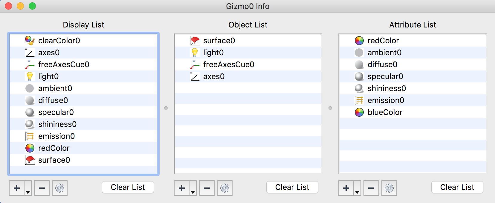

The Gizmo Info Window​
The Gizmo info window is the main user interface for controlling the display of objects in the Gizmo display window. Each info window has an associated Gizmo display window that shows the resulting graphical plot.
The info window contains three lists: the display list, the object list, and the attribute list. You use these lists to add objects and to modify their appearance in the Gizmo display window. Only items that appear in the display list are actually drawn in the Gizmo display window.
You can create objects using the + icon at the bottom of the object list. Clicking the + icon displays a menu from which you choose the type of object to add. The + icon below the attribute list adds attributes while the + icon below the display list adds operations.
The object list contains only objects and the attribute list contains only attributes. The display list can contain objects dragged in from the object list, attributes dragged in from the attribute list, and operations.
You can edit an item's properties by double-clicking its icon or by selecting it and clicking the gear icon below the list. You can remove an item from a list by selecting it and pressing the delete key or by clicking the - icon.
If you have two or more open Gizmo windows in one experiment you can have two or more open info windows. You can then drag an attribute from the attribute list of one info window and drop it in the attribute list of another info window. You can drag an object from the object list of one info window and drop it in the object list of another info window. If you drag an object from the object list of one info window and drop it in the display list of another info window, Igor also creates the corresponding entry in the object list of the receiving window.
It is not possible to drag and drop objects between info windows belonging to two instances of Igor.
The Gizmo Object List​
The middle list in the info window is the object list. It lists all of the objects that you have created which are then available for use in the display list.
Gizmo supports many types of objects including wave-based objects such as surface plots and drawing primitives such as spheres. If you click the + icon under that object list you see a menu of the available object types. See Gizmo Objects for details.
For an object to appear in the Gizmo plot, you must drag it to the display list.
The Gizmo Display List​

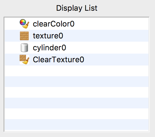

The display list controls what actually appears in the Gizmo display window. Gizmo processes the items in the display list in the order in which they appear.
In addition to objects that you drag in from the object list and attributes that you drag in from the attribute list, you can add the following operations to the display list:
ClearColor, ColorMaterial, Translate, Rotate, Scale, Main Transformation, Enable, Disable and Ortho.
Using the ColorMaterial, Enable and Disable operations requires some familiarity with OpenGL.
The Main Transformation item is used in conjunction with lighting. This is described under Gizmo Positional Lights.

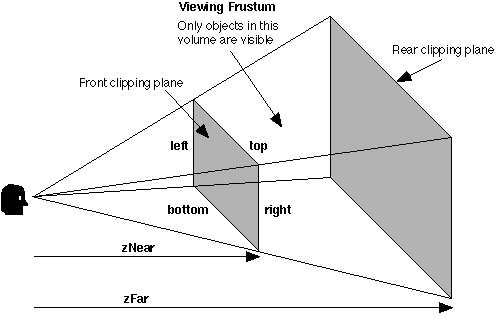

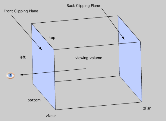

The Ortho operation controls the projection of the 3D space onto the 2D screen. This is described under Gizmo Projections.
If you are familiar with OpenGL, you should note that Gizmo automatically generates a small number of OpenGL instructions e.g., viewing transformation, default lighting, etc., that are not visible on the list. If you provide your own alternatives the various defaults are simply not executed. For example, by default Gizmo provides a neutral ambient light to illuminate the scene. However, if you add one or more lights to the display list, the default ambient light is omitted.

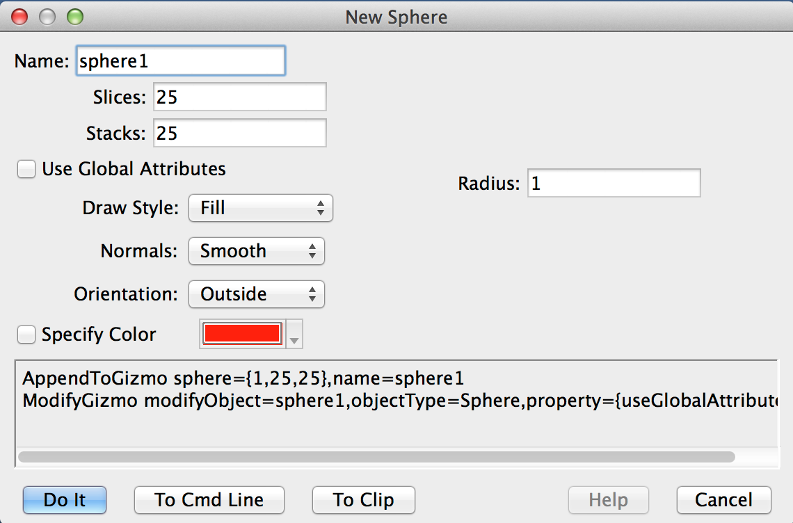

Internal attributes are built into objects. For example, the New Sphere dialog looks like this:
The draw style, normals, orientation and color settings are internal attributes of the sphere object.
The Use Global Attributes checkbox disables the controls under it and enables the use of the respective global attributes for the object in question. It does not affect the use of other global attributes.
The Specify Color checkbox does the same for color. If unchecked, the object has no intrinsic color. In this case you must add a color material operation and a color attribute to the display list before the object. If Specify Color is checked, Gizmo creates a default color material for the object and uses the specified internal color attribute.

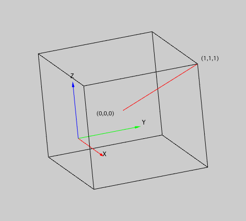

Gizmo Coordinate System​
Gizmo uses a right-handed, 3D coordinate system. If the positive X axis points to the right and the positive Y axis points up then, by the right-hand rule, the positive Z axis points out of the screen towards you.
Gizmo Dimensions​
The default Gizmo viewing volume is a space that is 4 units wide in all three dimensions. The actual display volume is two units in each dimension, centered in the middle of the viewing volume. Each dimension of the display volume extends from -1 to +1 about the origin. The display volume is smaller than the viewing volume to avoid clipping at the corners when the plot is rotated.
All drawing objects, such as spheres and cylinders, are sized in units of the +/-1 display volume. So, for example, if you create a box that is 2 units on a side, it completely fills the display volume. If you create a cylinder that is 3 units high, then the top of the cylinder is clipped because it extends outside the viewing volume boundary.
Superimposed on the display volume and precisely filling it is an axis coordinate system against which wave-based data objects such as scatter and surface plots are plotted. You can set the axis coordinate range for each dimension by choosing Gizmo→Axis Range. The axis coordinate system exists even though, by default, no axes are visible.

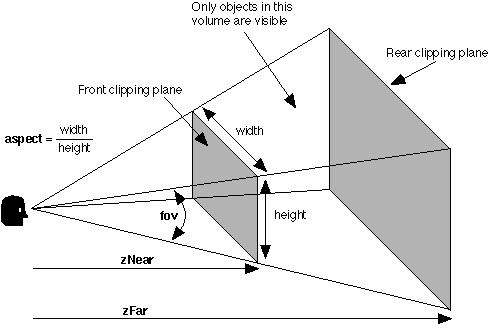

Perspective​
The perspective projection simulates the way your eye sees 3D objects. Although this is a realistic projection, it does not preserve the exact orientations or shapes of objects; for example, parallel lines may diverge or converge and there is foreshortening of objects. The viewing area is in the shape of a truncated pyramid in which the top has been cut off parallel to the base. Only objects within the viewing volume are visible. This is a symmetric perspective view of the viewing volume; a frustum, discussed in the next section, supports an asymmetric volume.
As shown in this diagram, the perspective projection depends on 4 parameters: fov, aspect, zNear and zFar.
Frustum​
The frustum projection is essentially the same as the perspective projection, but in this case it has more flexible settings, which means that it does not have to be symmetrical or aligned with the Z axis.
As shown in this diagram, the frustrum projection depends on 6 parameters: left, right, bottom, top, zNear and zFar.

You can start the 3D scene rotating continuously by clicking and gently flinging with the mouse. This requires releasing the mouse button before stopping mouse movement. Click the plot once to stop continuous rotation. If the display pans instead of rotates then click the arrow tool in the Gizmo tool palette to enable rotation.
You can also start continuous rotation using the tool palette. Choose Gizmo→Show Tools and then click one of three rotation icons to start rotation about the X, Y or Z axis. Click the plot once or click the stop icon in the tool palette to stop rotation.
The Home icon in the tool palette rotates the scene to the home orientation. By default the home orientation is X=0, Y=0, Z=0. In this case, the positive X axis points to the right, the Y axis points up and the Z axis points out of the plane of the window toward you. You can set the home orientation by right-clicking and choosing Set Home Orientation.
During continuous rotation you can use the x, y and z keys to tweak the orientation.

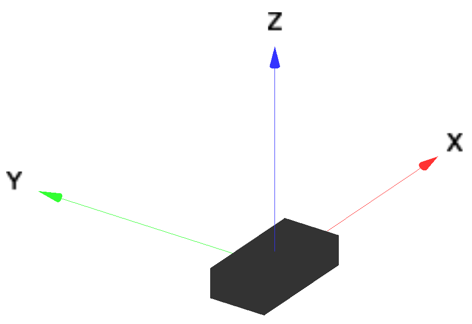

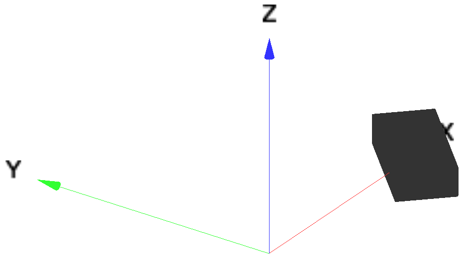

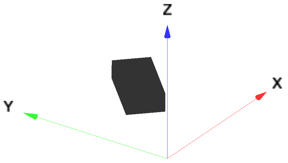

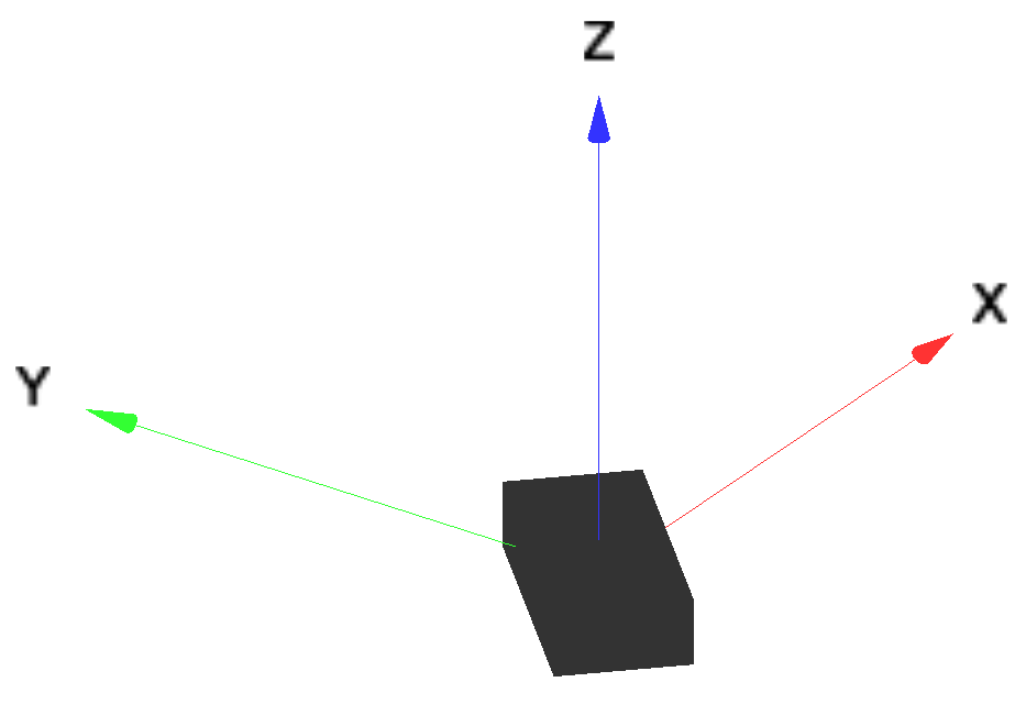

To see this we create a Gizmo with an axis cue and an unrotated box:
NewGizmo
ModifyGizmo showAxisCue=1
ModifyGizmo setQuaternion={0.435,-0.227,-0.404,0.777}
AppendToGizmo box={0.5,0.25,0.15}, name=box0
ModifyGizmo setDisplayList=0, object=box0
We then add a rotate operation to the display list, before the box object. This rotates the box object's axes by 45 degrees:
ModifyGizmo insertDisplayList=0, opName=rotate0, operation=rotate, data={45,0,0,1}
Now we insert a translation along the X axis:
ModifyGizmo insertDisplayList=1, opName=translate0, operation=translate, data={1,0,0}
The translation is along to the object's X axis, not the main X axis. Because of this, rotation followed by translation gives a different result than translation followed by rotation. To illustrate this we switch the order of the operations:
ModifyGizmo setDisplayList=0,opName=translate0, operation=translate, data={1,0,0}
ModifyGizmo setDisplayList=1, opName=rotate0, operation=rotate, data={45,0,0,1}
In this last case, at the time the translation was done, the object's axes were aligned with the main axes. The translation was along the object's X axis which pointed in the same direction as the main X axis.

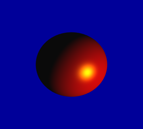

To create a shiny object (e.g., sphere), start with a sphere object, add to it shininess and specular attributes and then add the sphere to the display list following a light object that has matching diffuse and specular components. In this case the info window and display window like this:
For an example, open this demo experiment: Material Attributes.

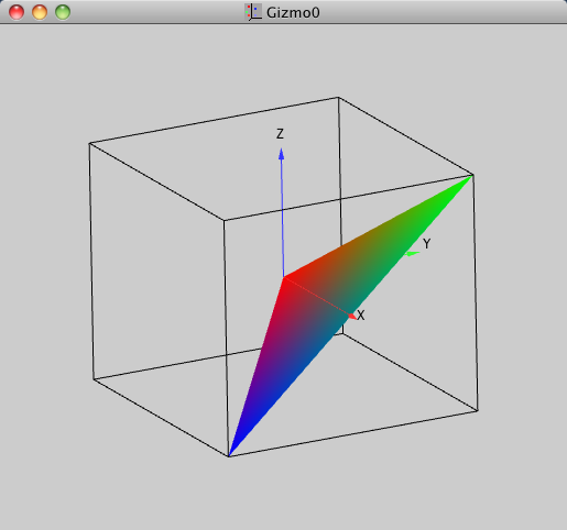

Color Waves​
Wave-based objects can be drawn in fixed colors or using the built-in Igor color tables. You can also use your own color waves to specify the colors of the objects in the Gizmo display window. The format of a color wave is similar to that of the corresponding data wave except that each data node (vertex) has red, green, blue and alpha color components associated with it.
One situation where a color wave is useful is when you want to display a set of scalar values (e.g., temperature measurements) corresponding to points on a 3D surface. In this case you have one wave that describes the shape of the surface and another wave containing the scalar measurements. The application of a color wave gives you complete freedom to represent the scalar data distributed on the surface. In most cases you can create an appropriate color wave using the ModifyGizmo makeSurfaceColorWave and makeTripletColorWave keywords to create a color wave for the data based on one of the built-in tables and then specifying an appropriate alpha in the color wave.
The required color wave format depends on the format of the data wave that describes the object to which the color is to be applied. This table shows some of the various data wave formats with their corresponding color wave formats. Dimensionality is indicated in parenthesis:
Data WaveColor WaveUsage

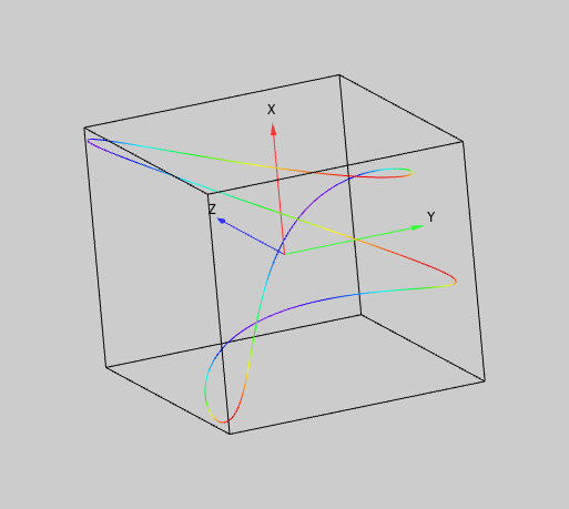

Triplet (Mx3)(Mx4) with RGBA in successive columnsPath, ribbon and scatter plots

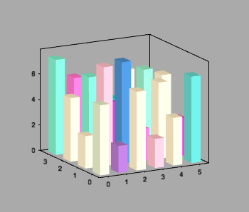

Matrix of Z values (MxN)(MxNx4) with RGBA in successive layersSurface and 3D bar chart plots

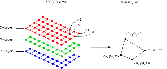

Sequential Quads (Mx4x3)(Mx4x4) with RGBA in successive layersParametric surface plots
Disjoint Quads (Mx12)(Mx4x4) with RGBA in successive layersParametric surface plots
Triangles (Mx3)(Mx4) with RGBA in successive columnsParametric surface plots
Parametric (MxNx3)(MxNx4) with RGBA in successive layersParametric surface plots

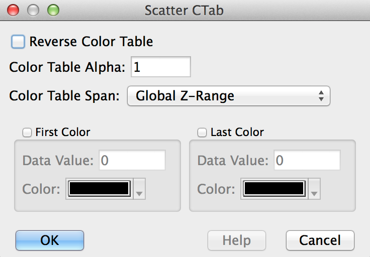

You can use Igor's built-in color tables to specify the colors of surface, scatter, path and ribbon objects. Isosurface, voxelgram, 3D bar chart, and image objects do not support the use of color tables.
For surface, scatter, path and ribbon objects, you can select the color table in the properties dialog for a given type of object. To see a list of available color tables, see CTabList and for more information, see Color Table Details.
When you choose a color table you can also set related options. In the properties dialog you set these options using the Details button which displays a subdialog that looks like this:
The Color Table Alpha setting applies to all colors in the color table. If you want to apply a variable alpha, set the object color using a color wave where you specify the alpha value for each data point. Color waves are not supported for isosurface objects. Remember that alpha effects require that blending is enabled and that there is a blend function on the display list - see Transparency and Translucency for details.
The Color Table Span setting determines the numeric quantity used to select a color from the color table. For a scatter plot the most common choice is Global Z Range. By default this means that the lowest Z value displayed in the plot is mapped to the first color and the highest Z value is mapped to the last color. The color for a specific scatter element is chosen based on that element's Z value.
This mapping can be tweaked using the First Color and Last Color settings. If you enable First Color and enter a corresponding data value then that data value is mapped to the first color in the color table and any scatter element whose data value is less than the entered value is displayed using the color selected from the color pop-up menu below. If you enable Last Color and enter a corresponding data value then that data value is mapped to the last color in the color table and any scatter element whose data value is greater than the entered value is displayed using the color selected from the color pop-up menu below.

Specular
Specular reflection governs the appearance of highlights on an object. The amount of specular reflection depends on the location of the viewpoint, being brightest along the direct angle of reflection.
Shininess
Shininess controls the size and brightness of a specular highlight. The shinier the object, the smaller and brighter (more focused) the highlight.

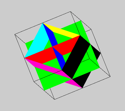

Distance sorting is computationally expensive so most applications avoid it using various tricks. The "poor man's" solution is to use alpha blending. This type of translucency can provide the desired effect for a restricted range of viewing angles and may require re-ordering the objects on the display list.
To use alpha blending, assign colors to two distinct objects on the display list. The translucent object should have an alpha value that corresponds to its opacity. An opaque object has alpha=1, whereas a transparent object has alpha=0. The final steps required for translucency are the addition of the blending function attribute and the enable operation. Select Gizmo→Enable Transparency Blend menu to create the blending function and the enable operation and add both to the display list.
The isosurface is a special case because by construction it consists of non-intersecting triangles. In most applications it is sufficient to sort the triangles in the order of the distance of the viewing point from the centroid of the triangle. You can obtain the triangles corresponding to an isosurface object using ModifyGizmo with the saveToWave keyword and establish a sample viewing point. The standard orthographic projection implies infinite distance to viewing point. An example of this type of sorting can be found in the Depth Sorting demo experiment.

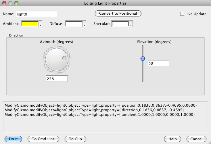

Gizmo Directional Lights​

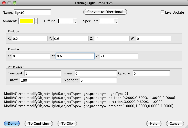

You can think of a directional light as a light positioned very far away from the scene so that its rays are essentially parallel within the display volume. The sun is a good example of a directional light. New light objects are directional by default.
The Light Properties dialog contains the controls you need to specify the light's position, color properties and distribution. When editing a light object that is already in the display list, you can click the Live Update checkbox to see how your changes affect the Gizmo Display.
The position of the light is specified via two angles: azimuth and elevation. Elevation is also called "altitude", especially in astronomy. The meaning of these angles is described at http://en.wikipedia.org/wiki/Azimuth. When the elevation is +90 or -90 degrees, the azimuth is undefined.
Ambient, diffuse and specular lighting are described at http://en.wikipedia.org/wiki/Phong_reflection_model. Ambient light illuminates all parts of all objects equally regardless of their orientation and of the position of the light. Diffuse light is reflected off a surface in all directions, as when light hits a rough surface. Specular light is reflected in a specific direction, as when light hits a shiny surface. The illumination created by diffuse and specular light at a given point on an object depends on the angle of the light ray relative to the normal to the surface of that point.
Gizmo Positional Lights​

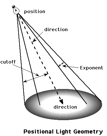

A positional light is a light source that originates at a finite distance from the illuminated scene. A desk lamp is a typical example of a positional light. It can be placed somewhere above the desk and it produces non-uniform illumination as its intensity falls off as a function of distance from the center of the illumination spot.
When you create a light object, it is initialized as a directional light. You can click click the Convert to Positional button in the dialog to get the corresponding positional light settings which you can then adjust as desired.
The parameters for specifying positional lights are illustrated here:
The top three controls in the directional light dialog specify the RGBA values of each of the ambient, diffuse and specular light components. You should provide some ambient component in at least one of the lights in the display list. This requirement holds even if you are trying to create a predominantly diffuse or specular effect.
When you create a Gizmo object you have the option to specify a color or to leave it unspecified. If you specify a color, Gizmo creates a default color material for the object. The default color material has the GL_FRONT_AND_BACK and GL_AMBIENT_AND_DIFFUSE settings. If you are interested in specular effects you must add specular and shininess attributes (see Colors, Materials and Lighting).
The Position and Direction controls in the dialog describe the position and direction of the light source. The position is expressed in homogeneous coordinates where the last element (w) is used to normalize the X, Y and Z components. Therefore, if you set w=1, then the X, Y, and Z components specify the absolute position of the light in space. If you set w=0, your light source is infinitely far away and you effectively created a directional light source.
We suggest that you set w=1, and set the direction using the next group of controls in the dialog, which describes the direction of the light as the three components of a vector pointing from the position of the light source to the point that you want the center of the specular spot to illuminate. The typical error here is entering the position of the illuminated spot instead of the direction vector.
The specified position of the light source is subject to the same transformations that apply to any other objects in the display list. In particular, as you rotate display objects, the lights will likewise rotate. If you want to keep the lights stationary so they illuminate different part of the rotating display, you must add a main transformation operation to the display list immediately after the last light object and before all the rotating objects. This will keep all objects listed above the main transformation stationary, and apply the rotation only to all subsequent display list items.

By default, the spot cutoff angle (the light cone half-angle) is 180 degrees which means that the light provides uniform illumination in all directions. If you take the trouble to specify position and direction it will be useful to reduce the cutoff angle to something more realistic - less than 90-degrees.
The constant, linear and quadratic attenuations combine to attenuate positional lights (i.e., for which w is non-zero). The exponent value, in the range 0 to128, determines the intensity falloff from the center of the spot by multiplying the center intensity by the cosine of the angle between the direction of the light and the vertex in question, raised to the power of the exponent value. This can be used to make the light highly specular.

A line object is a straight line that connects the two endpoint coordinates. You can add an arrowhead at the start or end of the line or at the mid point. This example shows a line from (1,1,1) to (0,0,0) created by the command
AppendToGizmo/D line={1,1,1,0,0,0}
You can make the line into a 3D cylinder using:
ModifyGizmo modifyObject=line0,objectType=line,property={arrowMode,16}
ModifyGizmo modifyObject=line0,objectType=line,property={cylinderStartRadius,0.05}
ModifyGizmo modifyObject=line0,objectType=line,property={cylinderEndRadius,0.05}

You can set the color of the triangle on a vertex by vertex basis and OpenGL will interpolate the colors between the vertices. Here is an example:
AppendToGizmo/D triangle={0,0,0,1,1,1,1,-1,-1}
ModifyGizmo modifyobject=triangle0, objectType=triangle, property={colorType,2}
ModifyGizmo modifyobject=triangle0, objectType=triangle, property={colorValue,0,1,0,0,1}
ModifyGizmo modifyobject=triangle0, objectType=triangle, property={colorValue,1,0,1,0,1}
ModifyGizmo modifyobject=triangle0, objectType=triangle, property={colorValue,2,0,0,1,1}

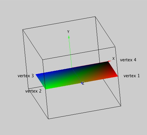

Quad Objects​
A quad object fills the sheet connecting the four vertices that are positioned sequentially in any direction starting from the first vertex. A quad object is always drawn filled. The fill color is determined by the internal color attribute, an embedded color attribute, or a global color attribute, in that order of precedence. Normals to the quad are calculated on a per-vertex basis. This gives rise to gradual shading when lighting calculations are enabled. For example, here are commands to create a quad:
AppendToGizmo/D quad={1,0,1,-1,0,1,-1,0,0,1,0,0}
ModifyGizmo modifyObject=quad0, objectType=quad, property={colorType,2}
ModifyGizmo modifyObject=quad0, objectType=quad, property={colorValue,0,1,0,0,1}
ModifyGizmo modifyObject=quad0, objectType=quad, property={colorValue,1,1.5259e-05,0.6,0.30425,1}
ModifyGizmo modifyObject=quad0, objectType=quad, property={colorValue,2,1.5259e-05,0.244434,1,1}
ModifyGizmo modifyObject=quad0, objectType=quad, property={colorValue,3,0,0,0,1}
When creating a quad, you may find it easier to create the quad using simple coordinates in either the X, Y, or Z planes and then use translate and rotate operations to position the quad in the desired final orientation.
This table lists some basic quad examples with unit dimensions.
Quad OrientationCommand
XZ Planequad={1,0,1,-1,0,1,-1,0,-1,1,0,-1}
XY Planequad={1,1,0,-1,1,0,-1,-1,0,1,-1,0}
YZ Planequad={0,1,1,0,1,-1,0,-1,-1,0,-1,1}
Oblique Z Plane, +X, +Yquad={1,0,1,1,0,-1,0,1,-1,0,1,1}
Oblique Z Plane, -X, +Yquad={-1,0,1,-1,0,-1,0,1,-1,0,1,1}
Oblique Z Plane, -X, -Yquad={-1,0,1,-1,0,-1,0,-1,-1,0,-1,1}
Oblique Z Plane, +X, -Yquad={1,0,1,1,0,-1,0,-1,-1,0,-1,1}
Here is what the seven quads described in the table look like after applying different colors:

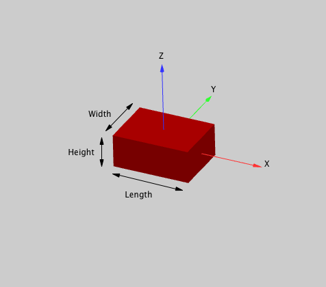

Box Objects​
A box object is defined by length along the X direction, width along the Y direction, and height along the Z direction. Boxes are centered on the origin and are always drawn filled. The fill color is determined by the internal color attribute, an embedded color attribute, or a global color attribute, in that order of precedence.
This illustration shows a box with length = 1, width = 0.75, height = 0.5:
To position a box in orientations where the sides are not parallel to the axes or not centered on the origin, add rotate and/or translate operations to the display list before the box item.

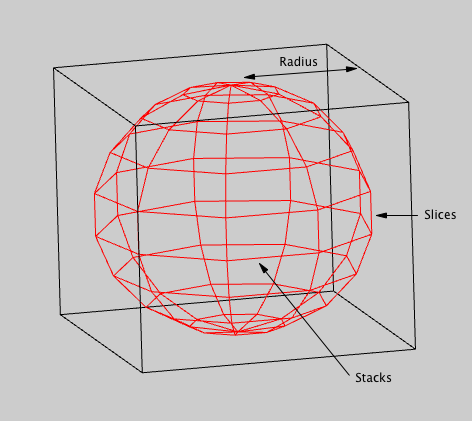

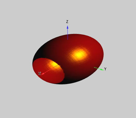

Sphere Objects​
A sphere is a quadric object, meaning that it can be generated by a quadratic polynomial. Internally a quadric object is composed of a list of triangles and quads that approximate the curved surface.
A newly-created sphere is centered on the origin and both poles are on the Z axis. The numbers of slices (subdivisions around the Z axis; divisions of longitude) and stacks (subdivisions along the Z axis; divisions of latitude) determine the smoothness of the sphere. The greater the numbers of subdivisions, the smoother the sphere's appearance. Small values produce other geometric objects (see illustrations below). The more subdivisions you use, the more time it takes to draw the sphere, but in most applications this is not important unless the sphere is replicated many times, such as when used as a marker in a scatter plot.
By default, spheres are initially drawn filled. The fill color is determined by the internal color attribute, an embedded color attribute, or a global color attribute, in that order of precedence.
Use translate and rotate operations to position the sphere in other locations and orientations.
These commands generate a sphere with radius=1, stacks=10, and slices=10 and set its drawing style to lines:
AppendToGizmo/D sphere={1,10,10}
ModifyGizmo modifyObject=sphere0, objectType=Sphere, property={useGlobalAttributes,0}
ModifyGizmo modifyObject=sphere0, objectType=Sphere, property={drawStyle,100011}
Create other geometric shapes by using small values for the number of stacks and keeping slices = 2. These commands generate an octahedron with radius=1, stacks=4 and slices=2 and set its drawing style to lines:
AppendToGizmo/D sphere={1,4,2}
You can create other geometric shapes by increasing the number of stacks and keeping slices=2.

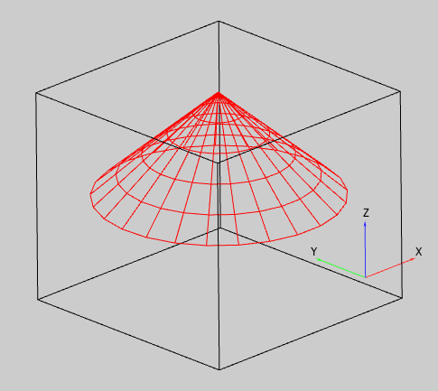

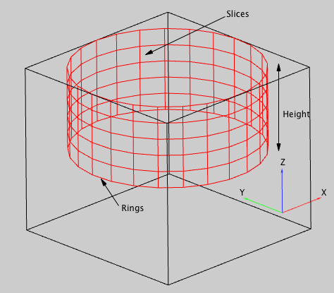

Cylinder Objects​
A cylinder is a quadric object, meaning that it can be generated by a quadratic polynomial. Cylinders are constructed from slices and rings. Specifying more slices creates a smoother cylinder. Initially, the cylinder axis is centered on the Z axis, height is in the positive Z direction, and the cylinder base is in the XY-plane.
Create conical objects (see illustration below) by specifying different values for the base radius and top radius parameters.
By default, cylinders are initially drawn filled. The fill color is determined by the internal color attribute, an embedded color attribute, or a global color attribute, in that order of precedence.
Use translate and rotate operations to position the cylinder in other locations and orientations.
These commands generate a cylinder with baseRadius=1, topRadius=1, height=1, slices=25, and rings=5 and set its drawing style to lines:
AppendToGizmo/D cylinder = {1,1,1,25,5}
ModifyGizmo modifyObject=cylinder0, objectType=Cylinder, property={useGlobalAttributes,0}
ModifyGizmo modifyObject=cylinder0, objectType=Cylinder, property={drawStyle,100011}
A cone created using the same command but with topRadius=0:
AppendToGizmo/D cylinder = {1,0,1,25,5}, name=cone0
ModifyGizmo modifyObject=cone0, objectType=Cylinder, property={useGlobalAttributes,0}
ModifyGizmo modifyObject=cone0, objectType=Cylinder, property={drawStyle,100011}
You can create other types of cylindrical object shapes by specifying a small number for slices. Create a triangular cylinder with slices = 3; create a square cylinder or open-ended box with slices = 4. Use different values for baseRadius or topRadius to create pyramid shapes.

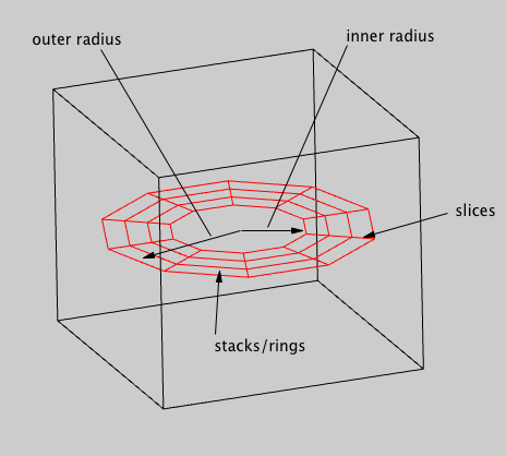

Disk Objects​
A disk is a quadric object, meaning that it can be generated by a quadratic polynomial. The disk is initially located in the XY plane centered on the origin. Create a smoother disk by specifying a greater number for slices.
By default, disks are initially drawn filled. The fill color is determined by the internal color attribute, an embedded color attribute, or a global color attribute, in that order of precedence.
Use translate and rotate operations to position the disk in other locations and orientations.
These commands generate a disk with innerRadius=0.5, outerRadius=1, slices=10, stacks=5, startAngle=0, sweepAngle=360 and set its drawing style to lines:
AppendToGizmo/D disk={0.5,1,10,5,0,360}
ModifyGizmo modifyObject=disk0, objectType=Disk, property={useGlobalAttributes,0}
ModifyGizmo modifyObject=disk0, objectType=Disk, property={drawStyle,100011}
This command changes the disk to a partial disk with sweepAngle set to 270 instead of 360. SweepAngle is specified in degrees clockwise from startAngle:
ModifyGizmo modifyObject=disk0, objectType=Disk, property={sweepAngle,270}

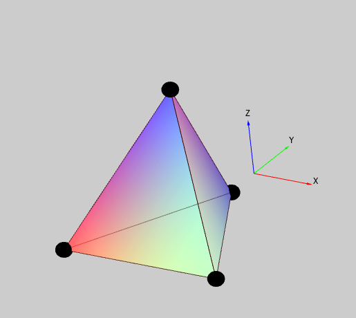

Tetrahedron Objects​

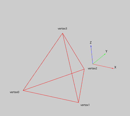

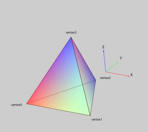

A tetrahedron is defined by 4 vertices. These commands generate a tetrahedron and set its drawing style to lines:
AppendToGizmo/D tetrahedron=tetrahedron0
ModifyGizmo ModifyObject=tetrahedron0, objectType=tetrahedron, property={vertex0,-1,-1,-1}
ModifyGizmo ModifyObject=tetrahedron0, objectType=tetrahedron, property={vertex1,1,-1,-1}
ModifyGizmo ModifyObject=tetrahedron0, objectType=tetrahedron, property={vertex2,0,1,-1}
ModifyGizmo ModifyObject=tetrahedron0, objectType=tetrahedron, property={vertex3,0,0,1}
You can turn on filling and specify a color for each vertex to produce a tetrahedron like this:
You can also specify that a sphere is to be drawn at each tetrahedron vertex:

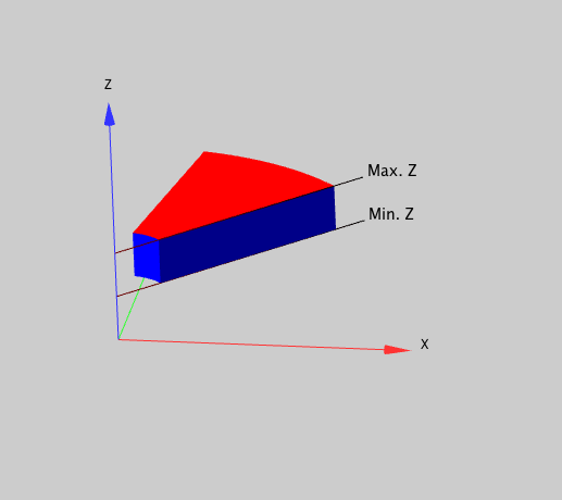

Pie Wedge Objects​
A pie wedge object is defined by two angles, two radii and two Z values. You can use multiple pie wedge objects to create many types of 3D pie charts.
This illustration shows a pie wedge from the top:
This illustration shows a pie wedge from the side:

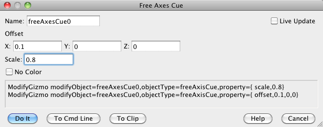

A free axis cue object can be drawn at any offset from the origin and at any scale. By default it has the same orientation as the default axis cue. Use a rotate operation if you want to rotate it.
You can create multiple free axis cues and even use them as markers in scatter plots. To add a free axis cue, click the + icon in the object list of the Gizmo info window and choose Free Axis Cue.
The free axis cue is colored the same as the default axis cue unless you disable its color by checking the No Color checkbox in the Free Axis Cue dialog. In this case it takes on the current color of the drawing environment as set by the previous color attribute in the display list. You also need a color material operation in the display list to apply a color to a free axis.
Axis Objects​
As explained under Gizmo Dimensions, a Gizmo display has an axis coordinate system that is superimposed on the +/-1 display volume. You set the range of this axis coordinate system using the Axis Range dialog, accessible via the Gizmo menu. Wave-based objects, such as scatter plots and surface plots, are displayed against this axis coordinate system. An axis object is a visual representation of it.
Gizmo supports three types of axis objects: box, triplet, and custom. Gizmo treats axis objects just like other objects that you add to the Gizmo display window with one exception: you must have at least one data object or drawing object on the display list for an axis object to be meaningful.
The corners of the box axis object correspond to the corners of the display volume. Thus the location of each corner in display volume space is -1 or +1 in each dimension. In this diagram the coordinates shown are the display volume coordinates of the corners of the box axes.
Box axes consist of 12 axes named X0, X1, X2, X3, Y0, Y1, Y2, Y3, Z0, Z1, Z2 and Z3. You can control each axis individually, assign it a color, range, tick marks, and tick mark labels. You can also add grid lines or paint any of the six sides of the box.

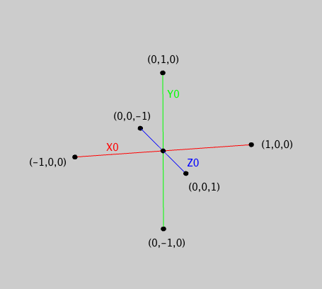

Triplet axes are a system of three orthogonal axes that intersect at the origin and span the +/-1 display volume. You can control each axis individually, assign its tick marks, tick mark labels and color. The origin of the axes is the center of the -/+1 display cube.
Each triplet axis is identified by name, X0, Y0, and Z0. This diagram shows display volume coordinates for triplet axes and the name of each axis:
A custom axis is a single line in space connecting your chosen start and end points as specified in -1/+1 display volume coordinates. Unlike box and triplet axes which reflect the global axis range as set by Gizmo→Axis Range, a custom axis has its own, independent axis range. You can add tick marks and tick mark labels to the custom axis as to any other axis.
By default, Gizmo attempts to find an appropriate position for tick mark labels. Using the manual position mode, you can take control over their position and orientation.
In most cases you will control the various axis settings using the Axes Properties dialog. When using the dialog it is important to keep track of the different axes that you can select with the checkboxes. To help you identify the various axes in your plot, the Axis tab of the dialog displays an outline of the axes in the same orientation as they appear in the Gizmo window. You can toggle the display of axes by double-clicking them.
See AppendToGizmo and ModifyGizmo for Axis Objects for programming details.

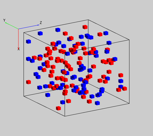

Scatter, Path, and Ribbon Data Formats​
Scatter and path plots require a triplet wave, which is a 2D wave containing 3 columns for the X, Y, and Z coordinates of each vertex. A color wave for a scatter or path plot is a 2D wave in which each row specifies the color of the corresponding vertex in the data wave. The color wave has 4 columns which specify RGBA entries in the range of [0,1].

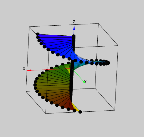

A ribbon plot also requires a triplet wave. A color wave for ribbon plot is the same as for scatter or path plots with one row of RGBA values per vertex. See also ModifyGizmo with the keyword pathToRibbon and Ribbon Plots below.

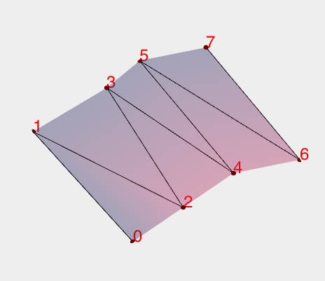

If you are plotting sequential quads (they could be the ImageTransform output of a Catmull-Clark B-Spline), the data wave is a 3D wave with four rows and three layers. Each row contains stores the four vertices of a quad and the three layers contain the X, Y, and Z coordinates.
If you are plotting disjoint quads the data wave is 2D with 12 columns corresponding to the X, Y, and Z values of the quad vertices taken in a counterclockwise direction.
The color wave for sequential quads and disjoint quads is a 4 column 2D wave in which the columns correspond to RGBA values in the range [0,1].

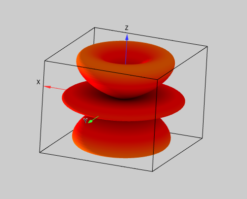

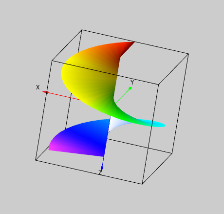

Parametric Surface Data Formats​
A parametric surface is defined by equations in which the X, Y, and Z coordinates are calculated for, usually, a pair of parameters. To define a parametric surface for Gizmo you need to have a 3D wave containing X, Y, and Z layers. The only restriction on the dimensions of this wave is that it must not have 4 columns. Gizmo constructs the parametric surface from quads. Each quad is defined by four neighboring vertices as shown in the diagram below.
You can find examples of parametric surfaces in these demo experiments:
Mobius Demo
Spherical Harmonics Demo
Gizmo Sphere Demo

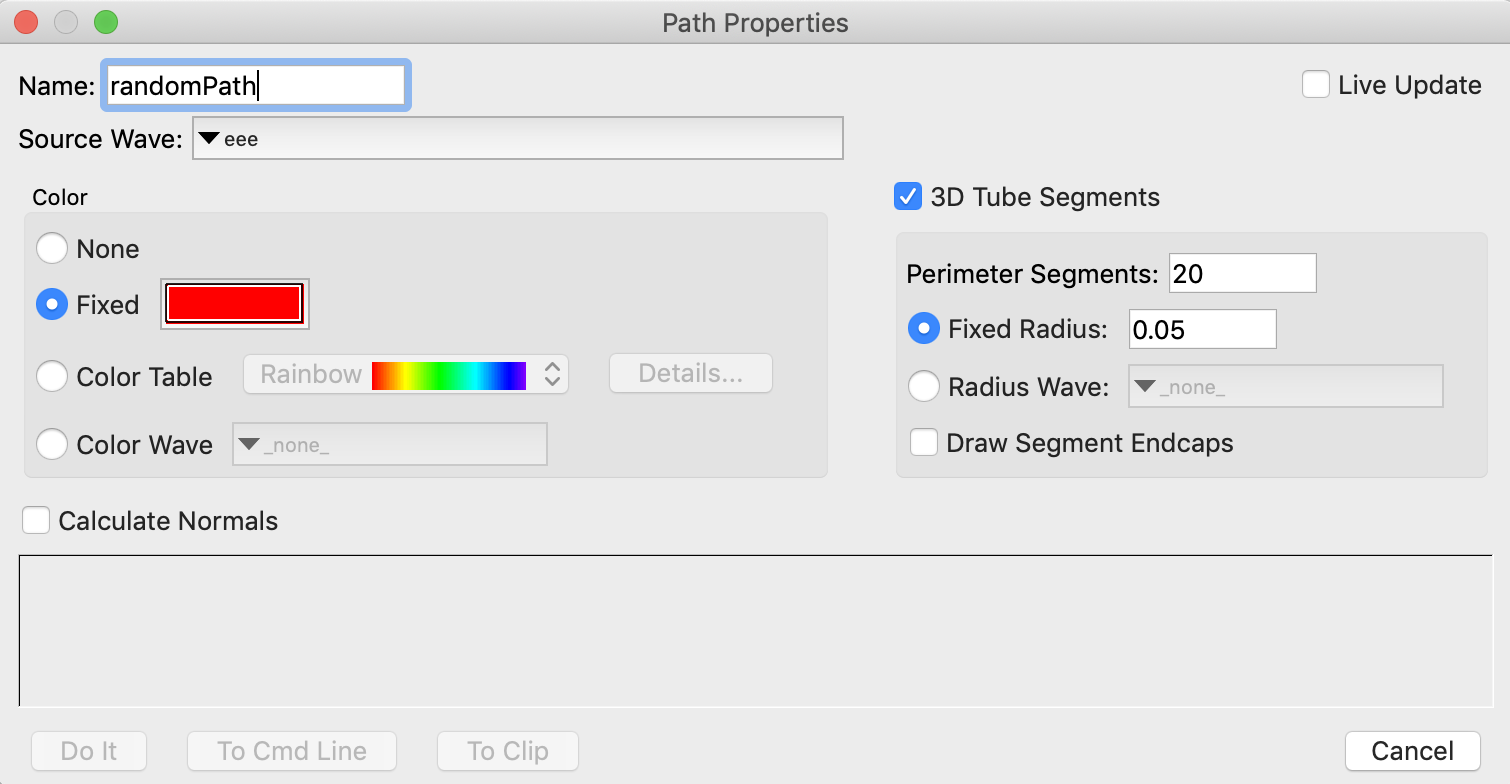

Path Plots​
Each data point in a path plot is connected in sequential order by a straight line to each adjacent point.
To draw markers at the individual points, you need to append a scatter plot based on the same data wave.
A path plot requires a triplet wave, which is a 2D wave of 3 columns for X, Y, Z coordinates, respectively, of each vertex. A color wave for a path plot is a 2D wave in which each row specifies the color of the corresponding vertex in the data wave. The color wave has 4 columns which specify RGBA entries in the range of [0,1].
The Path Properties dialog looks like this:
The full list of available options is given under ModifyGizmo for Path Objects.

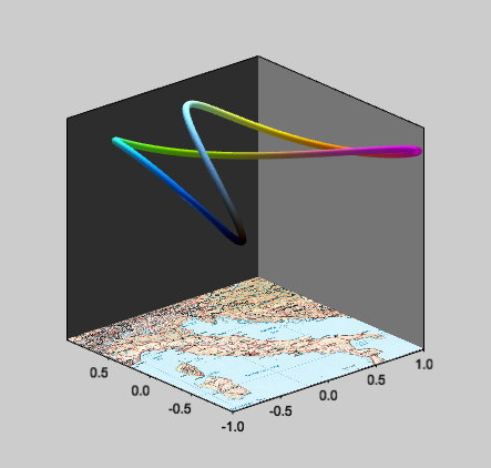

You can find an example of 3D tube segments where the tube segments are used to display chemical bonds in the Molecule demo.

A scatter plot can be colored using a constant color, a color taken from one of the built-in color tables, or a user-specified color wave. A color wave for a scatter plot is a 2D wave in which each row specifies the color of the corresponding element in the data wave. The color wave has 4 columns which specify RGBA entries in the range of [0,1].

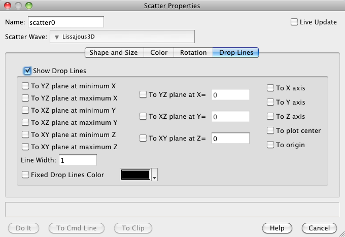

The Scatter Properties dialog allows you to set all properties of the object. If you use the dialog when the object is already in the display list then checking the Live Update box lets you to see all changes as you make them.
One useful feature of scatter plots is the ability to draw a "drop line". Drop lines start at the center of each marker and extend to one of 14 possible points, lines or planes. You can choose any combination of drop lines from the Drop Lines tab of the Scatter Properties dialog.

You can display crystal structures in Gizmo using scatter plots. Here is an example:
Crystals are easy to display as scatter objects that are centered at coordinates provided in a triplet wave. For example, you can use a sphere as the object drawn at each center. You can specify additional waves to control the color and size of each sphere.
Igor provides two built-in transformations that convert triplet waves from crystallography coordinates to rectangular coordinates and vice versa. See the Crystal Demo experiment and the WaveTransform operation with the keywords crystalToRect and rectToCrystal.
3D Bar Plots​

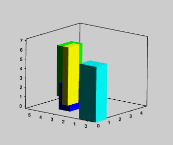

A 3D bar plot consists of a number of straight (parallel to all three axes) rectangular bars. The bars may be arranged on a regular grid or may be completely scattered within the volume.
There are two modes for 3D bar plots: basic and refined.
In a basic 3D bar plot, the bars all start at zero and extend in the positive Z direction. Here is an example:
The basic 3D bar plot represents a 2D matrix of positive values. Each value is displayed as a zero-based bar according to its row/column in the matrix. All bars have the same width.
In a refined bar plot, bars can be drawn at arbitrary positions and all bar dimensions are under your control. Here is an example:
The refined 3D Bar plot displays requires a 6-column input wave where each row represents a single bar and the columns contain the following information:
Column 0: The X center of the bar
Column 1: The Y center of the bar
Column 2: The lower Z value
Column 3: The upper Z value
Column 4: The width of the bar in the X direction
Column 5: The width of the bar in the Y direction
Using the refined mode it is possible to create stacked and overlapping 3D bars plots as well as bars of varying sizes.
To find out more open the 3D Bar Plot Demo experiment.

This example shows a surface plot with a contour map at the bottom:
This example shows a parametric surface plot of a spherical harmonic function:
This example shows orthogonal slices of volumetric data:
To display the data by sampling on non-orthogonal slices you can create an arbitrary parametric surface and color it using data sampled at the vertices of the parametric surface. Here is an example.
Suppose you have the following simple 3D data set:
Make/O/N=(100,100,100) ddd=z
Now create a parametric surface that describes a sphere in this range of data. Here is the MakeSphere function from the GizmoSphere demo experiment:

In a ribbon plot, data points are connected by a surface that defines the ribbon object. A ribbon is constructed from a list of triangles with alternating vertices as shown here:
To display the individual points or connections, you need to append a scatter plot or a path plot.
Data for a ribbon plot consist of a Nx3 matrix of values. Each row contains the X, Y, and Z values for the spatial coordinates of a point on the edge of the ribbon. The coordinates for each alternating edge of the ribbon follow in sequential order. The order of vertices for a ribbon is shown in the illustration above.
A ribbon must have at least four vertices and the total number of vertices must be even.

This is an example of a simple ribbon plot:
This is an example of a ribbon plot overlayed with path and scatter plots of the same data in order to show the positioning of data points along the ribbon edges:

  • Choose Edit→Export Graphics to export to the clipboard as PNG, JPEG or TIFF.
  • Choose Edit→Copy. This exports to the clipboard using the settings last set in the Export Graphics dialog.
  • Right-click and choose Copy to Clipboard from the contextual pop-up menu. This is the same as choosing Edit→Copy.

The following example illustrates how you can use a group object to create a custom marker for a scatter plot.
Start a new Igor experiment and execute this command:
NewGizmo/JUNK=3
This creates a simple scatter plot with default red sphere markers.
Create a group object using the + icon below the object list in the info window.
Double-click the group0 object in the object list. This opens a new info window for the group with display, object and attribute lists. Add a blue sphere object with a radius of 0.15 and a red cylinder object with top and bottom radii of 0.05 and a height of 0.3 to the group. Drag the sphere and cylinder objects to the group's display list.
Close the group0 info window.
In the Gizmo0 Info window, drag the group0 object from the object list to the bottom of the display list. The sphere+cylinder group appears in the Gizmo plot.
Select the group0 object in the Gizmo0 Info window display list and delete it by clicking the - icon. The sphere+cylinder group disappears from the Gizmo plot.
In the Gizmo0 Info window, double-click the randomScatter object to open the Scatter Properties dialog. In the Shape and Size tab of the dialog, select Object from the Fixed Shape pop-up menu and group0 from the pop-up menu just to the right of it. Click Do It.
The resulting graph should look something like this:

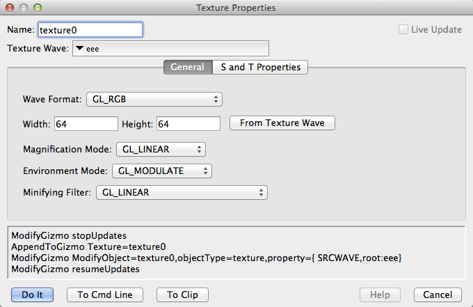

A Gizmo texture object represents an OpenGL object that allows you to apply image information to surfaces of arbitrary shape. Textures in Gizmo are 1D or 2D. They can be applied to quad objects, quadric objects (spheres, cylinders and disks) and parametric surfaces. If you intend to use a texture on a simple quad you should use an image plot instead; see Gizmo Image Plots.
You usually create a texture from an image that was loaded using ImageLoad and is in the form of an unsigned byte 3D RGB wave where the color for each pixel is stored in sequential layers. Before you create a Gizmo texture you need to convert the standard image format into a 1D wave where the color entries for each pixel are stored sequentially as RGB or RGBA. This conversion can be accomplished by ImageTransform with the keyword imageToTexture.
The Texture Properties dialog determines how the texture wave is converted into a texture object and how the texture is applied in a drawing.
Before invoking the dialog it is useful to know the dimensions of the texture wave, its packing format and the original image size. ImageTransform stores this information in the wave note of the texture wave. The dialog loads the texture information from the wave note if you click the From Texture Wave button.
Once you create a texture object you can apply it to other objects. For example, to apply texture0 to cylinder0 your display list should contain the following sequence:
where cylinder0 is preceeded by texture0 and followed by clearTexture0. You must check the Uniform Texture Coordinates checkbox in the Cylinder Properties dialog. The texture object is placed just before the cylinder and the clear texture operation follows so that subsequent drawings are free of textures.

Troubleshooting Gizmo Lighting Problems​
  1. Make sure that the light object appears in the display list above the objects that you expect to be illuminated.
  2. Check that your light specifies non-black colors for the ambient, diffuse and specular components.
  3. Start with directional light which has fewer options than positional light with less to go wrong. Open the Light Properties dialog, check the Live Update checkbox, change the direction controls and check for changes in the scene. If you do not see changes in the scene then the direction of the light is more than likely not the problem.
  4. Verify that you have checked the Compute Normals checkbox for each object that you expect to be illuminated.
  5. Check that the normal orientation is what you expect. In the case of quadric objects, toggle the normals orientation between inside and outside. For other objects, consider the definitions of front and back surfaces. If you have doubt, add a front face operation to the display list right before an object. The operation allows you to define the direction representing front and back surfaces.
  6. If you are drawing an object that looks fine at normal scale but appears to have the wrong lighting effects when drawn after a scale operation you should compute the object at the final size and avoid scaling. For example, a scatter plot draws markers by default with an isotropic scaling factor of 1 (no scaling). If you create a sphere object with radius 1 for use in a scatter plot, you would need to reduce its size somewhere. You can do so by setting the scale in the Scatter Properties dialog or by reducing the radius of the sphere.
