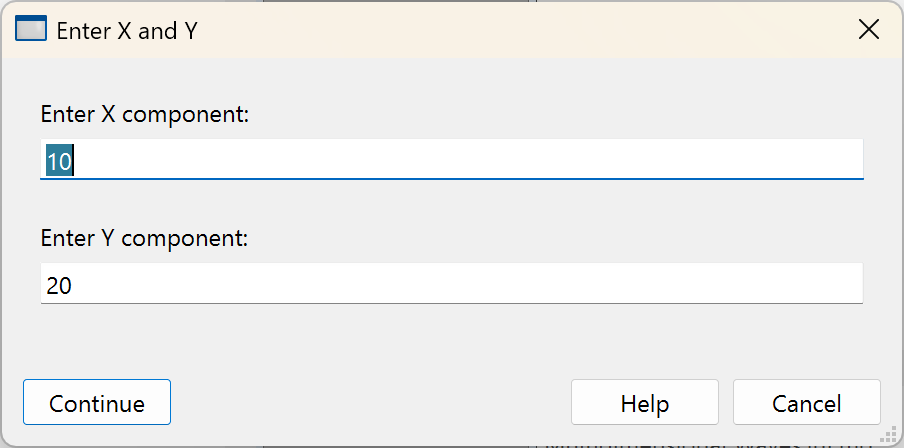

Function CalcDiagDialog()
Variable x=10,y=20
Prompt x, "Enter X component: " // Set prompt for x param
Prompt y, "Enter Y component: " // Set prompt for y param
DoPrompt "Enter X and Y", x, y
if (V_Flag)
return -1 // User canceled
Print "Diagonal=",sqrt(x^2+y^2)
If you run the CalcDiagDialog function, you see the following dialog:
If the user presses Continue without changing the default values, "Diagonal=22.3607" is printed in the history area of the command window. If the user presses Cancel, nothing is printed because DoPrompt sets the V_Flag variable to 1 in this case.

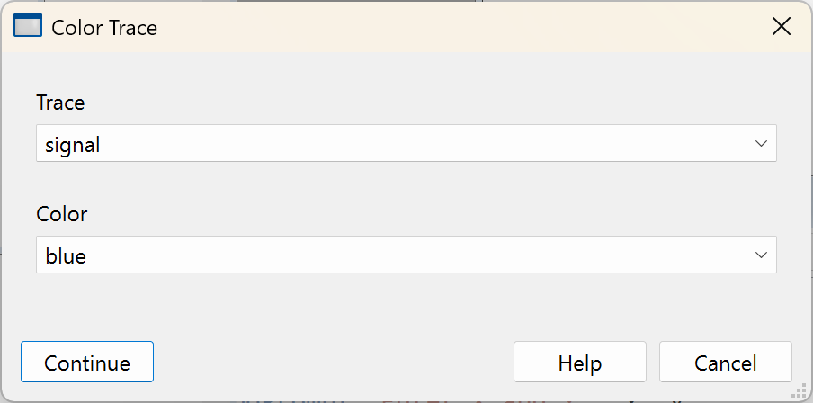

Function ColorTraceDialog()
String traceName
Variable color=3
Prompt traceName,"Trace",popup,TraceNameList("",";",1)
Prompt color,"Color",popup,"red;green;blue"
DoPrompt "Color Trace",traceName,color
if (V_Flag)
return 0 // user canceled
if (color == 1)
ModifyGraph rgb($traceName)=(65000, 0, 0)
elseif(color == 2)
ModifyGraph rgb($traceName)=(0, 65000, 0)
elseif(color == 3)
ModifyGraph rgb($traceName)=(0, 0, 65000)
If you select Color Trace from the Macros menu, Igor displays the simple input dialog with two pop-up menus. The first menu contains a list of all traces in the target window which is assumed to be a graph. The second menu contains the items red, green and blue with blue (item number 3) initially selected.
After you choose the desired trace and color from the pop-up menus and click the Continue button, the function continues execution. The string parameter traceName will contain the name of the trace selected from the first pop-up menu. The numeric parameter color will have a value of 1, 2 or 3, corresponding to red, green and blue.

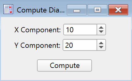

The CalcDiagDialog function shown under The Simple Input Dialog creates a modal dialog. "Modal" means that the function retains complete control until the user clicks Cancel or Continue. The user cannot activate another window or choose a menu item until the dialog is dismissed.
This section shows how to implement the same functionality using a control panel as a modeless dialog. "Modeless" means that the user can activate another window or choose a menu item at any time. The modeless window accepts input whenever the user wants to enter it but does not block the user from accessing other windows.
The control panel looks like this:
The code implementing this control panel is shown below. Before we look at the code, here is some explanation of the thinking behind it.
The X Component and Y Component controls are SetVariable controls. We attach each SetVariable control to a global variable so that, if we kill and later recreate the panel, the SetVariable control is restored to its previous state. In other words, we use global variables to remember settings across invocations of the panel. To keep the global variables from cluttering the user's space, we bury them in a data folder located at root:Packages:DiagonalControlPanel.
The DisplayDiagonalControlPanel routine creates the data folder and the global variables if they do not already exist. It then creates the control panel or, if it already exists, just brings it to the front.
We added a menu item to the Macros menu so the user can easily invoke DisplayDiagonalControlPanel.
We built the control panel manually using techniques explained under Controls And Control Panels. Then we closed it so Igor would create a display recreation macro which we named DiagonalControlPanel. We then manually tweaked the macro to attach the SetVariable controls to the desired globals and to set the panel's behavior when the user clicks the close button by adding the /K=1 flag.
Here are the procedures.

// If the panel is already created, just bring it to the front.
DoWindow/F DiagonalControlPanel
if (V_Flag != 0)
return 0
DFREF dfSave = GetDataFolderDFR()
// Create a data folder in Packages to store globals.
NewDataFolder/O/S root:Packages
NewDataFolder/O/S root:Packages:DiagonalControlPanel
// Create global variables used by the control panel.
Variable xComponent = NumVarOrDefault(":gXComponent", 10)
Variable/G gXComponent = xComponent
Variable yComponent = NumVarOrDefault(":gYComponent", 20)
Variable/G gYComponent = yComponent
// Create the control panel.
Execute "DiagonalControlPanel()"
SetDataFolder dfSave
To try this example, copy all of the procedures and paste them into the procedure window of a new experiment. Close the procedure window to compile it and then choose Display Diagonal Control Panel from the Macros menu. Next enter values in the text entry items and click the Compute button. Close the control panel and then reopen it using the Display Diagonal Control Panel menu item. Notice that the values that you entered were remembered. Use the Data Browser to inspect the root:Packages:DiagonalControlPanel data folder.
Although this example is very simple, it illustrates the process of creating a control panel that functions as a modeless dialog. There are many more examples of this in the Examples folder. You can access them via the File->Example Experiments submenu.
For details on building control panels, see Controls And Control Panels.
