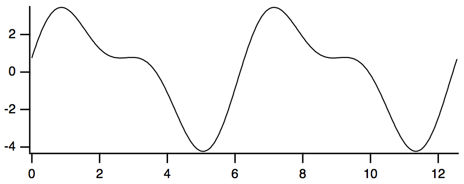

Here is an example.
Make/O/N=500 wave0
SetScale/I x, 0, 4*PI, wave0 // plot function from x=0 to x=4pi
Display wave0
wave0 = 3*sin(x) + 1.5*sin(2*x + PI/6)
This produces the following graph:

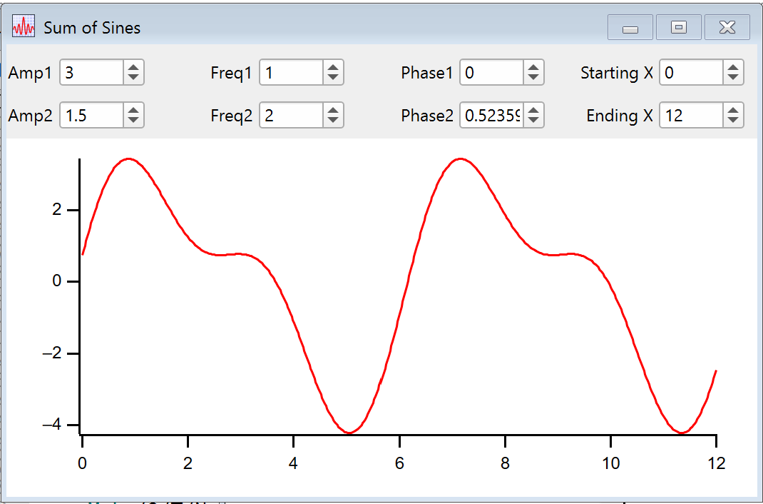

Function Plotting Using Controls​
For a slick presentation of function plotting, you can put controls in the graph to set the values of the global variables. When you change the value in the control, the global variable changes. This reexecutes the assignment. This changes the wave, which updates the graph. Here is what the graph would look like.
We've added two additional global variables and connected them to the Starting X and Ending X controls. This allows us to set the domain. These controls are both linked to an action procedure that does a SetScale on the wave.
Controls are explained in detail in Controls and Control Panels.

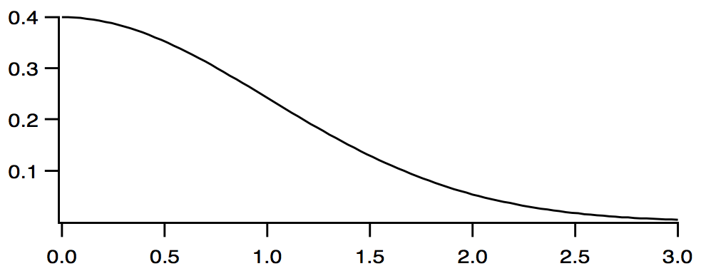

In the preceding example we used the built-in sin function in the right-hand expression. We can also use a user-defined function. Here is an example using a very simple function -- the normal probability distribution function.
Function NormalProb(x)
Variable x
// the constant is 1/sqrt(2*pi) evaluated in double-precision
return 0.398942280401433*exp(-(0.5*x^2))
Make/N=100 wave0; SetScale/I x, 0, 3, wave0; wave0 = NormalProb(x)
Display wave0
This produces the following graph.
Note that, although we are using the NormalProb function to fill a wave, the NormalProb function itself has nothing to do with waves. It merely takes an input and returns a single output. We could also test the NormalProb function at a single point by executing

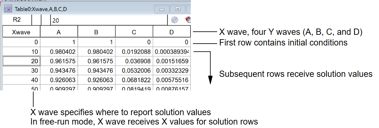

IntegrateODE has two schemes for returning solution results to you: you can specify X values where you need solution values, or you can let the solution "free run".
In the first mode, results are returned to you at values of x corresponding to the X scaling of your Y waves, or at X values that you provide via an X wave or by providing X0 and deltaX and letting Igor calculate the X values. The actual calculation may require X increments smaller than those you ask for. Igor returns results only at the X values you ask for.
In free-run mode, IntegrateODE returns solution values for every step taken by the integration algorithm. In some cases, this may give you extremely small steps. Free-run mode returns to you not only the Y[i] values from the solution, but also values of x[i]. Free-run mode can be useful in that, to some degree, it will return results closely spaced when the solution is changing rapidly and with larger spacing when the solution is changing slowly.

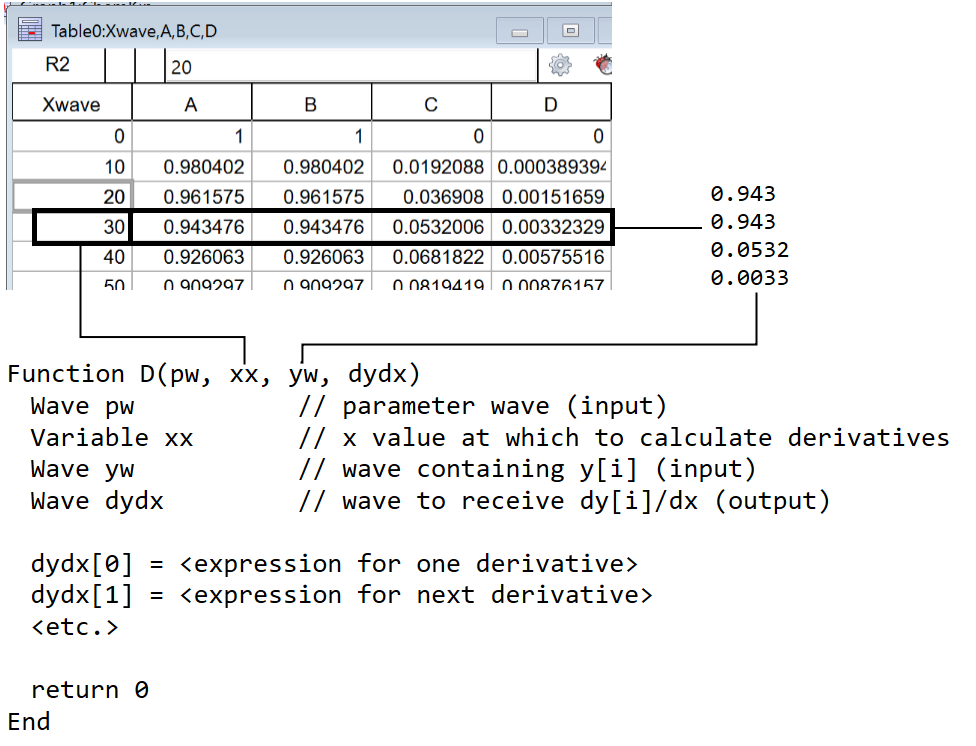

The parameter wave is simply a wave containing possible adjustable constants. Using a wave for these makes it convenient to change the constants and try a new integration. It also will make it more convenient to do a curve fit to a differential equation. You must create the parameter wave before invoking IntegrateODE. The contents of the parameter wave are of no concern to IntegrateODE and are not touched. In fact, you can change the contents of the parameter wave inside your function and those changes will be permanent.
Other inputs are the value of x at which the derivatives are to be evaluated, and a wave (yw in this example) containing current values of the y[i]'s. The value of X is determined by Igor when it calls your function, and the waves yw and dydx are both created by Igor and passed to your function when Igor needs new values for the derivatives. Both the input Y wave and the output dydx wave have as many elements as the number of derivative equations in your system of ODEs.
The values in the yw wave correspond to a row of the table in the example above. That is:
The wave yw contains the present value, or estimated value, of Y[i] at X =xx. You may need this value to calculate the derivatives.
Your derivative function is called many times during the course of a solution, and it will be called at values of X that do not correspond to X values in the final solution. The reason for this is two-fold: First, the solution method steps from one value of X to another using estimates of the derivatives at several intermediate X values. Second, the spacing between X values that you want may be larger than can be calculated accurately, and Igor may need to find the solution at intermediate values. These intermediate values are not reported to you unless you call IntegrateODE in free-run mode.
Because the derivative function is called at intermediate X values, the yw wave is not the same wave as the Y wave you create and pass to IntegrateODE. Note that one row of your Y wave, or one value from each Y wave, corresponds to the elements of the one-dimensional yw wave that is passed in to your derivative function. While the illustration implies that values from your Y wave are passed to the derivative function, in fact the values in the yw wave passed into the derivative function correspond to whatever Y values the integrator needs at the moment. The correspondence to your Y wave or waves is only conceptual.
You should be aware that, with the exception of the parameter wave (pw above) the waves are not waves that exist in your Igor experiment. Do not try to resize them with InsertPoints/DeletePoints and don't do anything to them with the Redimension operation. The yw wave is input-only; altering it will not change anything. The dydx wave is output-only; the only thing you should do with it is to assign appropriate derivative (right-hand-side) values.

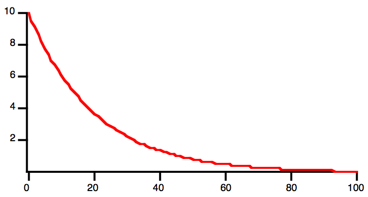

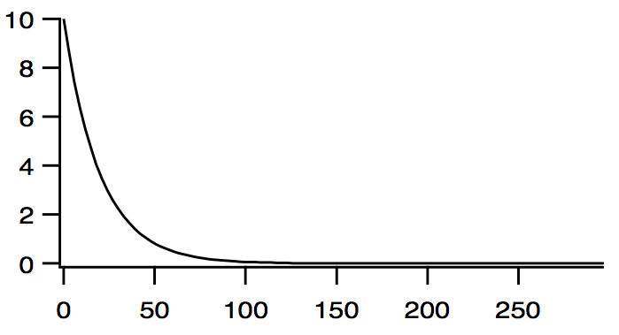

Make/D/O/N=101 YY // wave to receive results
YY[0] = 10 // initial condition- y0=10
Display YY // make a graph
Make/D/O PP={0.05} // set constant a to 0.05
IntegrateODE FirstOrder, PP, YY
This results in the following graph with the expected exponential decay:

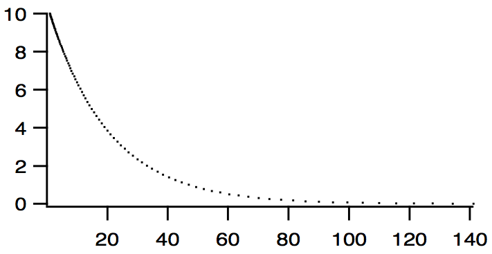

The IntegrateODE command shown in the example is the simplest you can use. It names the derivative function, FirstOrder, a parameter wave, PP, and a results wave, YY.
Because the IntegrateODE command does not explicitly set the X values, the output results are calculated according to the X scaling of the results wave YY. You can change the spacing of the x values by changing the X scaling of YY:
SetScale/P x 0,3,YY // now the results will be at an x interval of 3
The same thing can be achieved by telling the IntegrateODE operation to use your specified x0 and deltax. You do this using the /X flag:
IntegrateODE/X={0,3} FirstOrder, PP, YY
We presume that you have your own reasons for using the /X={x0, deltax} form. Note that when you do this, Igor doesn't pay any attention to the X scaling of your Y wave. If you graph the Y wave the values on the X axis may not match the X values used by Igor during the calculation.

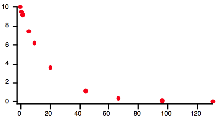

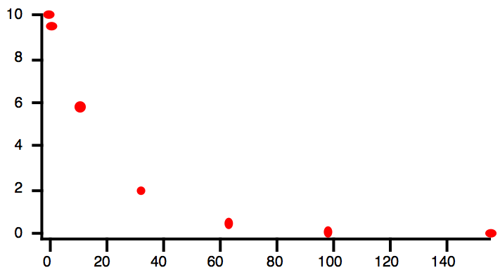

Finally, you don't have to use a constant spacing in X if you provide an X wave. You might want to do this to get closely-spaced values only where the solution changes rapidly. For instance:
Make/O/D/N=101 XX // same length as YY
XX = exp(p/20) // X values get farther apart as X increases
Display YY vs XX // make an XY graph
ModifyGraph mode=2 // plot with dots so you can see the points
IntegrateODE/X=XX FirstOrder, PP, YY
Note that throughout these examples the initial value of YY has remained at 10.

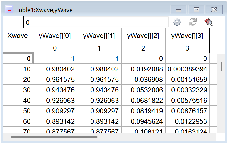

We think that it is easiest to keep track of the results using a single multicolumn Y wave. These commands make a four-column Y wave and use dimension labels to keep track of which column corresponds to which substance:
Make/D/O/N=(100,4) ChemKin
SetScale/P x 0,10,ChemKin // calculate concentrations every 10 s
SetDimLabel 1,0,A,ChemKin // set dimension labels to substance names
SetDimLabel 1,1,B,ChemKin // this can be done in a table if you make
SetDimLabel 1,2,C,ChemKin // the table using edit ChemKin.ld
SetDimLabel 1,3,D,ChemKin
ChemKin[0][%A] = 1 // initial conditions: concentration of A
ChemKin[0][%B] = 1 // and B is 1, C and D is 0
ChemKin[0][%C] = 0 // note indexing using dimension labels
ChemKin[0][%D] = 0
Make/D/O KK={0.002,0.0001,0.004} // rate constants
Display ChemKin[][%D] // graph concentration of the product
// Note graph made with subrange of wave
IntegrateODE/M=1 ChemKinetic, KK, ChemKin

You need one equation for each order. Here is the equation for a forced, damped harmonic oscillator (using y for the displacement rather than x to avoid confusion with the independent variable, which is t in this case):
d2ydt2+2λdydt+ω2y=F(t)\displaystyle \frac{d^{2} y}{d t^{2}}+2 \lambda \frac{d y}{d t}+\omega^{2} y=F(t)
If we define a new variable v (which happens to be velocity in this case):
v=dydt\displaystyle v=\frac{d y}{d t}
Then
d2ydt2=dvdt\displaystyle \frac{d^{2} y}{d t^{2}}=\frac{d v}{d t}
Substituting into the original equation gives us two coupled first-order equations:
dvdt=−2λv−ω2y+F(t)dydt=v\begin{array}{l} \displaystyle \frac{d v}{d t}=-2 \lambda v-\omega^{2} y+F(t) \\ \\ \displaystyle \frac{d y}{d t}=v \end{array}
Of course, a real implementation of these equations will have to provide something for F(t). A derivative function to implement these equations might look like this:

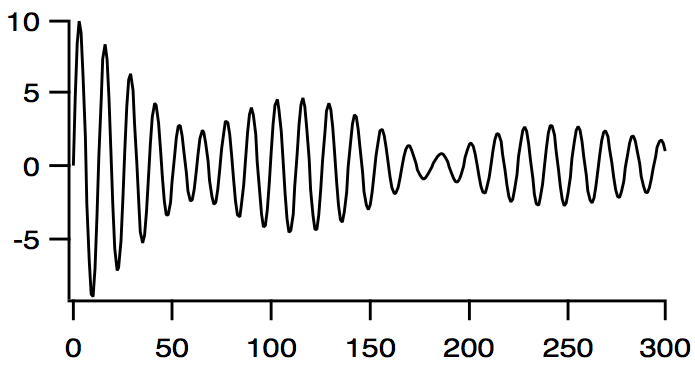

Function Harmonic(pw, tt, yy, dydt)
Wave pw // pw[0]=damping, pw[1]=undamped frequency
// pw[2]=Forcing amplitude, pw[3]=Forcing frequency
Variable tt
Wave yy // yy[0] = velocity, yy[1] = displacement
Wave dydt
// simple sinusoidal forcing
Variable Force = pw[2]*sin(pw[3]*tt)
dydt[0] = -2*pw[0]*yy[0] - pw[1]*pw[1]*yy[1]+Force
dydt[1] = yy[0]
return 0
And the commands to integrate the equations:
Make/D/O/N=(300,2) HarmonicOsc
SetDimLabel 1,0,Velocity,HarmonicOsc
SetDimLabel 1,1,Displacement,HarmonicOsc
HarmonicOsc[0][%Velocity] = 5 // initial velocity
HarmonicOsc[0][%Displacement] = 0 // initial displacement
Make/D/O HarmPW={.01,.5,.1,.45} // damping, freq, forcing amp and freq
Display HarmonicOsc[][%Displacement]
IntegrateODE Harmonic, HarmPW, HarmonicOsc

Most of the examples shown so far use the Y wave's X scaling to set the X values where a solution is desired. In the section A First-Order Equation, examples are also shown in which the /X flag is used to specify the sequence of X values, either by setting X0 and deltaX or by supplying a wave filled with X values.
These methods have the advantage that you have complete control over the X values where the solution is reported to you. They also are completely deterministic -- you know before running IntegrateODE exactly how many points will be calculated and how big your waves need to be.
They also have the potential drawback that you may force IntegrateODE to use smaller X increments than required. If your ODE system is expensive to calculate, this may exact a considerable cost in computation time.
IntegrateODE also offers a "free-run" mode in which the solution is allowed to proceed using whatever X increments are required to achieve the requested accuracy limit. This mode has two possible advantages -- it will use the minimum number of solution steps required and it may also produce a higher density of points in areas where the solution changes rapidly (but watch out for Stiff Systems).
Free-run mode has the disadvantage that in certain cases the solution may require miniscule steps to tip toe through difficult terrain, inundating you with huge numbers of points that you don't really need. You also don't know ahead of time how many points will be required to cover a certain range in X.
To illustrate the use of free-run mode, we will return to the example used in the section A First-Order Equation. (Make sure the FirstOrder function is compiled in the procedure window.) Because we don't know how many points will be produced, we will make the waves large:
Make/D/O/N=1000 FreeRunY // wave to receive results
FreeRunY = NaN
FreeRunY[0] = 10 // initial condition- y0=10
Free-run mode requires that you supply an X wave. Unlike the previous use of an X wave, in free-run mode the X wave is filled by IntegrateODE with the X values at which solution values have been calculated. Like the Y waves, you must provide an initial value in the first row of the X wave. As before, it must have the same number of rows as the Y waves:
Make/O/D/N=1000 FreeRunX // same length as YY
FreeRunX = NaN // prevent display of extra points
FreeRunX[0] = 0 // initial value of X
In free-run mode, only the points that are required are altered. Thus, if you have some preexisting wave contents, they will be seen on a graph. We prevent the resulting confusion by filling the X wave with NaN's (Not a Number, or blanks). Igor graphs do not display points that have NaN values.
Make a graph:
Display FreeRunY vs FreeRunX // make an XY graph
ModifyGraph mode=3, marker=19 // plot with dots so you can see the points
Make the parameter wave and set the value of the equation's lone coefficient:
And finally do the integration in free-run mode. The /XRUN flag specifies a suggested first step size and the maximum X value. When the solution passes the maximum X value (100 in this case) or when your waves are filled, IntegrateODE will stop.
FreeRunX = NaN; FreeRunX[0] = 0
IntegrateODE/M=1/X=FreeRunX/XRUN={1,100} FirstOrder, PP, FreeRunY
In the earlier example, we (rather arbitrarily) chose 100 steps to make a reasonably smooth plot. In this case, it took 6 steps to cover the same X range, and the steps are closest together at the beginning where the exponential decay is most rapid:
Asking for more accuracy will cause smaller steps to be taken (9 when we executed the following command):
FreeRunX = NaN;FreeRunX[0] = 0
IntegrateODE/M=1/X=FreeRunX/XRUN={1,100}/E=1e-14 FirstOrder, PP, FreeRunY
After IntegrateODE has finished, you can use Redimension and the V_ODETotalSteps variable to adjust the size of the waves to just the points actually calculated:
Redimension/N=(V_ODETotalSteps+1) FreeRunY, FreeRunX
Note that we added 1 to V_ODETotalSteps to account for the initial value in row zero.

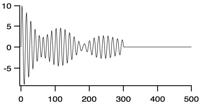

Stopping and Restarting IntegrateODE​

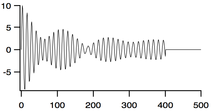

Any result can be used as initial conditions for a new solution. Thus, you can use the /R flag to calculate just a part of the solution, then finish later using the /R flag to pick up where you left off. For instance, using the harmonic oscillator example:

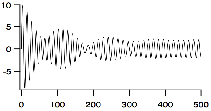

Make/D/O/N=(500,2) HarmonicOsc = 0
IntegrateODE/M=1/R=[,300] Harmonic, HarmPW, HarmonicOsc
The calculation has been done for points 0-300. Note the comma in /R=[,300]. That tells Igor that 300 is the end point, not the begin point. Now you can restart at 300 and continue to the 400th point:
IntegrateODE/M=1/R=[300,400] Harmonic, HarmPW, HarmonicOsc
or finish the entire 500 points. Perhaps you need to start from an earlier point:
IntegrateODE/M=1/R=[350] Harmonic, HarmPW, HarmonicOsc

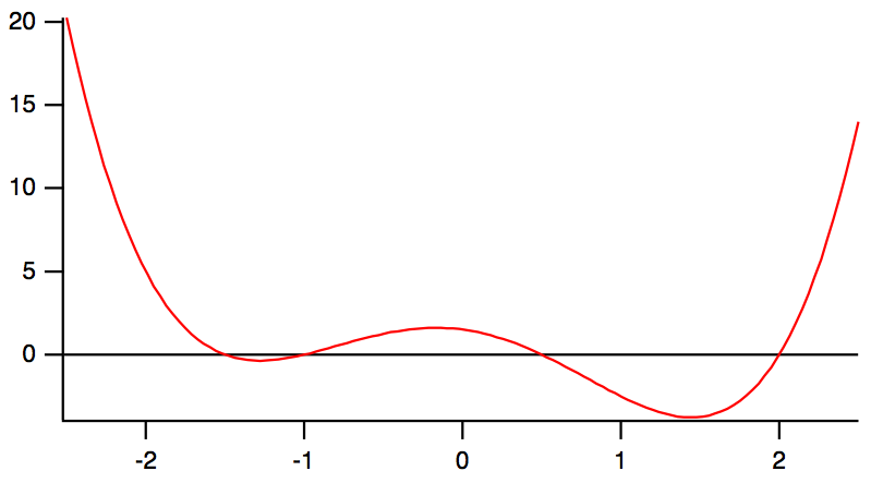

x4 -3.75x2 - 1.25x + 1.5
We just happen to know that this polynomial can be factored as (x+1)(x-2)(x+1.5)(x-0.5) so we already know what the roots are. But let's let Igor do the work.
First, we need to make a wave with the polynomial coefficients. The wave must have N+1 points, where N is the degree of the polynomial. Point zero is the coefficient for the constant term, the last point is the coefficient for the highest-order term:
Make/D/O PolyCoefs = {1.5, -1.25, -3.75, 0, 1}
This wave can be used with the Poly function to generate values of the polynomial. For instance:
Make/D/O PWave // a wave with 128 points
SetScale/I x -2.5,2.5,PWave // give it an X range of (-2.5, 2.5)
PWave = Poly(PolyCoefs, x) // fill it with polynomial values
Display PWave // and make a graph of it
ModifyGraph zero(left)=1 // add a zero line to show the roots
These commands make the following graph:
Now use FindRoots to find the roots:
FindRoots/P=PolyCoefs // roots are now in W_polyRoots
Print W_polyRoots
This prints:
W_polyRoots[0]= {cmplx(0.5,0),cmplx(-1,0),cmplx(-1.5,0),cmplx(2,0)}

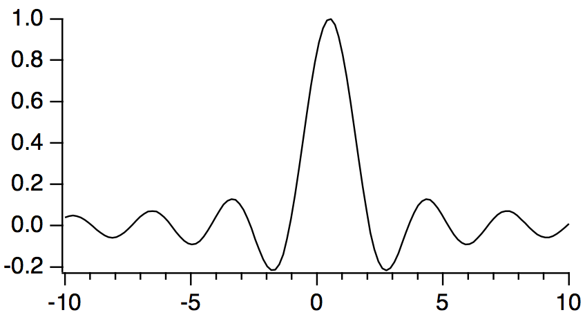

As an example we will find roots of the function y = a+bsinc(c(x-x0)). Here is a user-defined function to implement this:
Function mySinc(w, x)
Wave w
Variable x
return w[0]+w[1]*sinc(w[2]*(x-w[3]))
Enter this code into the Procedure window and then close the window.
Make a graph of the function:
Make/D/O SincCoefs={0, 1, 2, .5} // a sinc function offset by 0.5
Make/D/O SincWave // a wave with 128 points
SetScale/I x -10,10,SincWave // give it an X range of (-2, 2)
SincWave = mySinc(SincCoefs, x) // fill it with function values
Display SincWave // and make a graph of it
ModifyGraph minor(bottom)=1 // add minor ticks to the graph

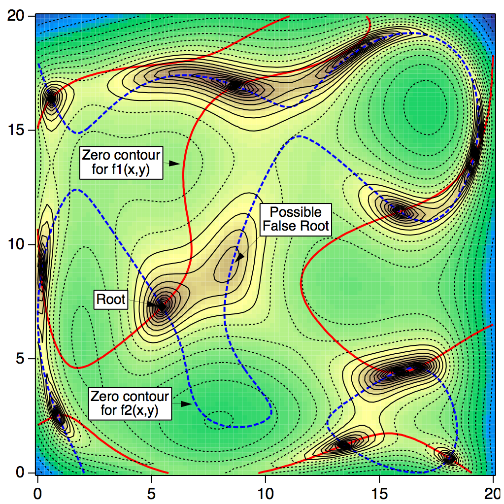

Caveats for Multidimensional Root Finding​
Finding roots of multidimensional nonlinear functions is not straightforward. There is no general, foolproof way to do it. The method Igor uses is to search for minima in the sum of the squares of the functions. Since the squared values must be positive, the only places where this sum can be zero is at points where all the functions are zero at the same time. That point is a root, and it is also a minimum in the summed squares of the functions.
To find the zero points, Igor searches for local minima by travelling downhill from the starting point. Unfortunately, a local minimum doesn't have to be a root, it just has to be someplace where the sum of squares of the functions is less than surrounding points.
This graph shows how this can come about:
The two heavy lines are the zero contours for two functions (they happen to be fifth-order 2D polynomials). Where these zero contours cross are the roots for the system of the two functions.
The thin lines are contours of f1(x,y)2+f2(x,y)2, with dotted lines for high values; minima are surrounded by thin, solid contours. You can see that every intersection between the heavy zero contours is surrounded by thin contours showing that these are minima in the sum of the squared functions. One such point is labeled "Root".
There is at least one point, labelled "False root", where there is a minimum but the zero contours don't cross. That is not a root, but FindRoots may find it anyway. For instance, a real root:
FindRoots /x={3,6} MyPoly2d, nn1coefs, MyPoly2d, nn2coefs
Root found after 11 function evaluations.
W_Root={5.4623,7.28975}
Function values at root:
W_YatRoot={-4.15845e-13,1.08297e-12}
This point is the point marked "Root". But:
FindRoots/x={9,10} MyPoly2d, nn1coefs, MyPoly2d, nn2coefs
Root found after 52 function evaluations.
W_Root={8.38701,9.10129}
W_YatRoot={0.0686792,0.0129881}
You can see from the values in W_YatRoot that this is not a root. This point is marked "False root" on the figure above.
The polynomials used in this example have too many coefficients to be conveniently shown here. To see this example and others in action, try out the demo experiment. It is called "MD Root Finder Demo" and you will find it in your Igor Pro folder, in the Examples:Analysis: folder.
SetScale/I x -10,10,SincWave // give it an X range of [-10, 10]
Now we're ready to find extreme points.

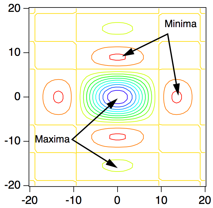

Before starting, let's make a contour plot to see what we're up against. Here are some commands to make a convenient one (select the commands and execute them by pressing Control-Enter):
Make/D/O params2D={1,3,2} // nice set of parameters
Make/D/O/N=(50,50) Sinc2DWave // matrix wave for contouring
SetScale/I x -20,20,Sinc2DWave // nice range of X values for these functions
SetScale/I y -20,20,Sinc2DWave // and Y values
Sinc2DWave = Sinc2D(params2D, x, y) // fill f1Wave with values from f1(x,y)
Display /W=(5,42,399,396) // graph window for contour plot
AppendMatrixContour Sinc2DWave
ModifyContour Sinc2DWave labels=0 // suppress contour labels to reduce clutter
The algorithm that searches for extreme points needs a starting guess which you provide using the /X flag. Here is a command to find a minimum point:
Optimize/X={1,5} Sinc2D,params2D

In this example the function gradient is zero at the origin because there is a function maximum there. A gradient of zero could also be a minimum or a saddle point.
The algorithms used by the Optimize operation assume that your function is smooth, that is, that the first and second derivatives are continuous. Optimize may work with functions that violate this assumption, but it is not guaranteed.
Although Optimize tends to look downhill to the nearest minimum (or uphill to the nearest maximum), it is not guaranteed to find any particular minimum, especially if your starting guess is near a point where the gradient is small. Sometimes using a different method (/M=(stepMethod, hessianMethod) will result in a different answer. You can limit the maximum step size to keep progress more or less local (/S=maxStep). If you set the maximum step size too small, however, Optimize may stop early because the maximum step size is exceeded too many times. Here is an example using the Sinc2D function. If the starting guess is near the origin, the gradient is small and the solution shoots off into the hinterlands (only a portion of the history report is shown):
Optimize/X={1,1} Sinc2D,params2D
W_Extremum={-61.1192,298.438}
Function gradient:
W_OptGradient={-1.04095e-08,-1.19703e-08}
Use /S to limit the step size, and find a minimum nearer to the starting guess:
Optimize/X={1,1}/S=10 Sinc2D,params2D
W_Extremum={-0.00014911,8.9868}
Function gradient:
W_OptGradient={9.31323e-09,5.92775e-08}
But if the maximum step is too small, it doesn't work:
Optimize/X={1,1}/S=1 Sinc2D,params2D
==== The Optimize operation failed to find a minimum. ====
Optimize stopped because
the maximum step size was exceeded in five consecutive iterations.
This can happen if the function is unbounded (there is no minimum),
or the function approaches the minimum asymptotically. It may also be that the
maximum step size (1) is too small.
Another way to get a solution near by is to set the initial trust region to a small value. This works if you select double dogleg or More Hebdon as the step selection method. It does not apply to the default line search method. Here is an example (note that the double dogleg method is selected using /M={1,0}):
Optimize/X={1,1}/M={1,0}/F=1 Sinc2D,params2D
W_Extremum={-0.000619834,8.9872}
Function gradient:
W_OptGradient={1.09896e-07,2.9017e-08}
